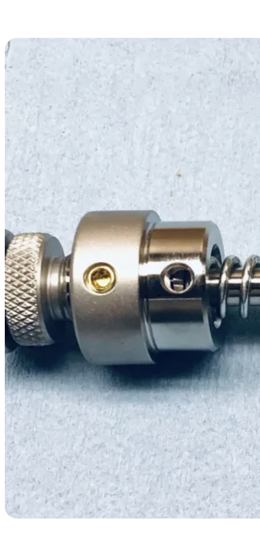

If you’re handy enough you could drill and tap your rear cap vertically.
That is a brass 8-32 set screw so as not to mess up your adjuster’s threads.
I use 2 on mine, the one on top pushes onto the first one to secure it even more:

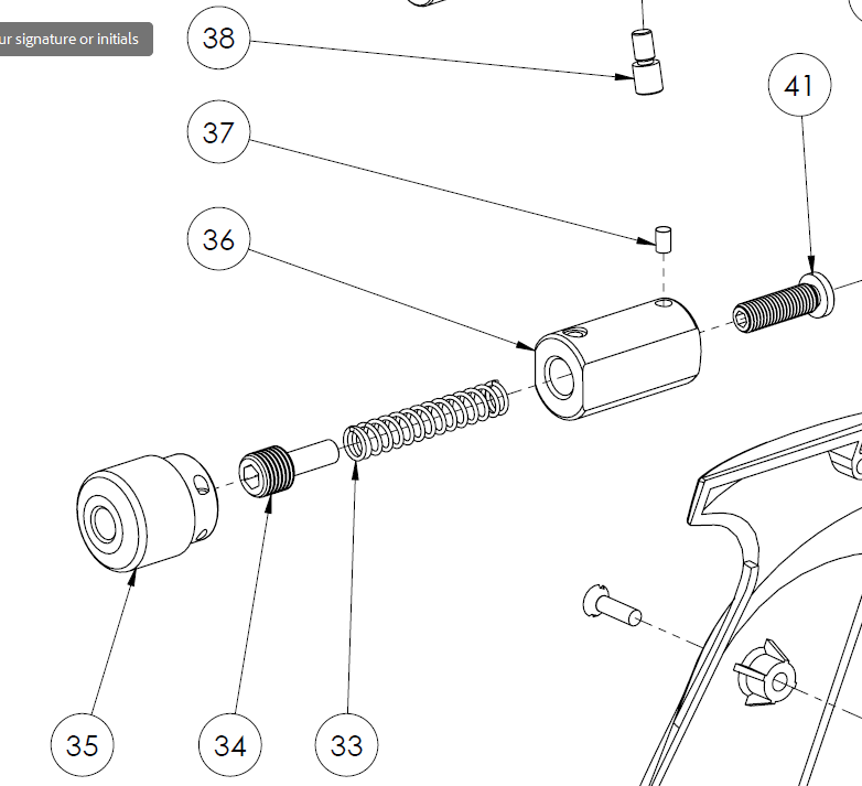

Part #34 & #41 in the parts diagram.

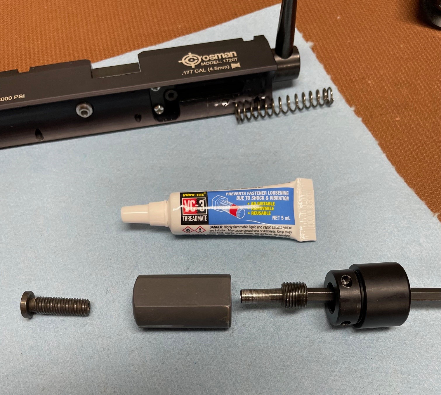

I had purchased a product similar to LocTite (but from another company) that was red in color after I saw a couple videos where the guy was using it on scope ring caps on a high powered rifle. You could install and remove screws multiple times without re-applying the product. They were using it on screws that were prone to loosening up under use and vibration. It didn't harden up completely. It remained pliable for multiple uses.
Maybe I'll try it if I can find the tiny little tube and see if that works.

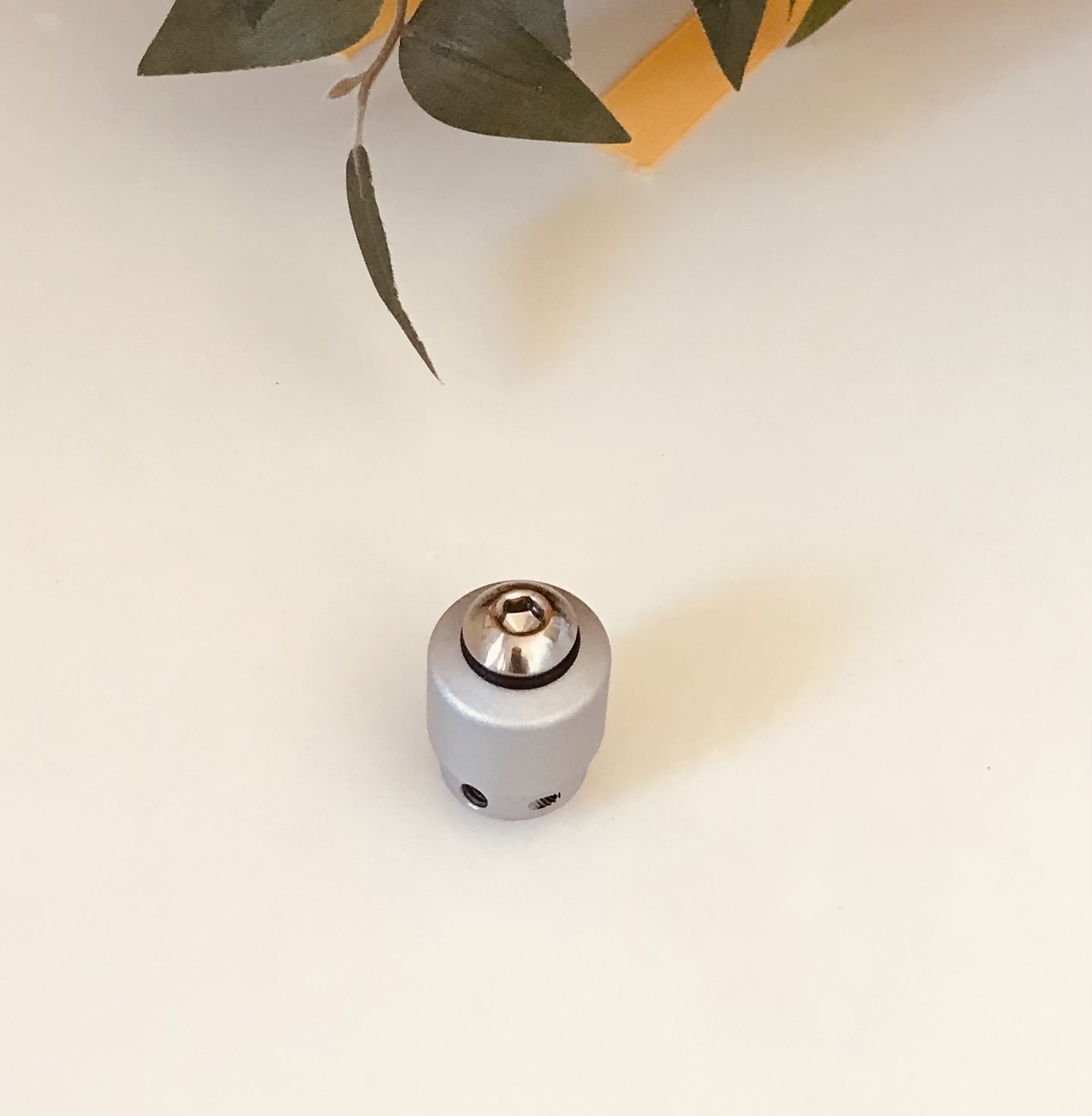

I do have 2 of those 22xx vertical set screw locks on 2 rear caps and was planning to have the same on my PROD/17, but I came up with a solution that required me not to bore holes.
I modified a stainless 3/8-24 button screw (99% sure of the thread size) I bought from Ace H, had the tip shaped in cone to push onto #34 and avert CCW creep.
The O-ring is there to act as lock washer, a tensioner so as not to make the thread length too crucial.
Note: Mine are low power builds.
Don’t mind the color, it’s coated:

Is item 37 in your parts diagram a set screw to lock down item 41?
No, #37 is just a plastic and threadless plug—-and seems to offer no function at all, it not even a tight fit.
You could replace it with a weed whacker nylon of slightly larger diameter for a much tighter fit.
Now that you’ve mentioned it, I scantily recall some threading it for a set screw to immobilize #41.
