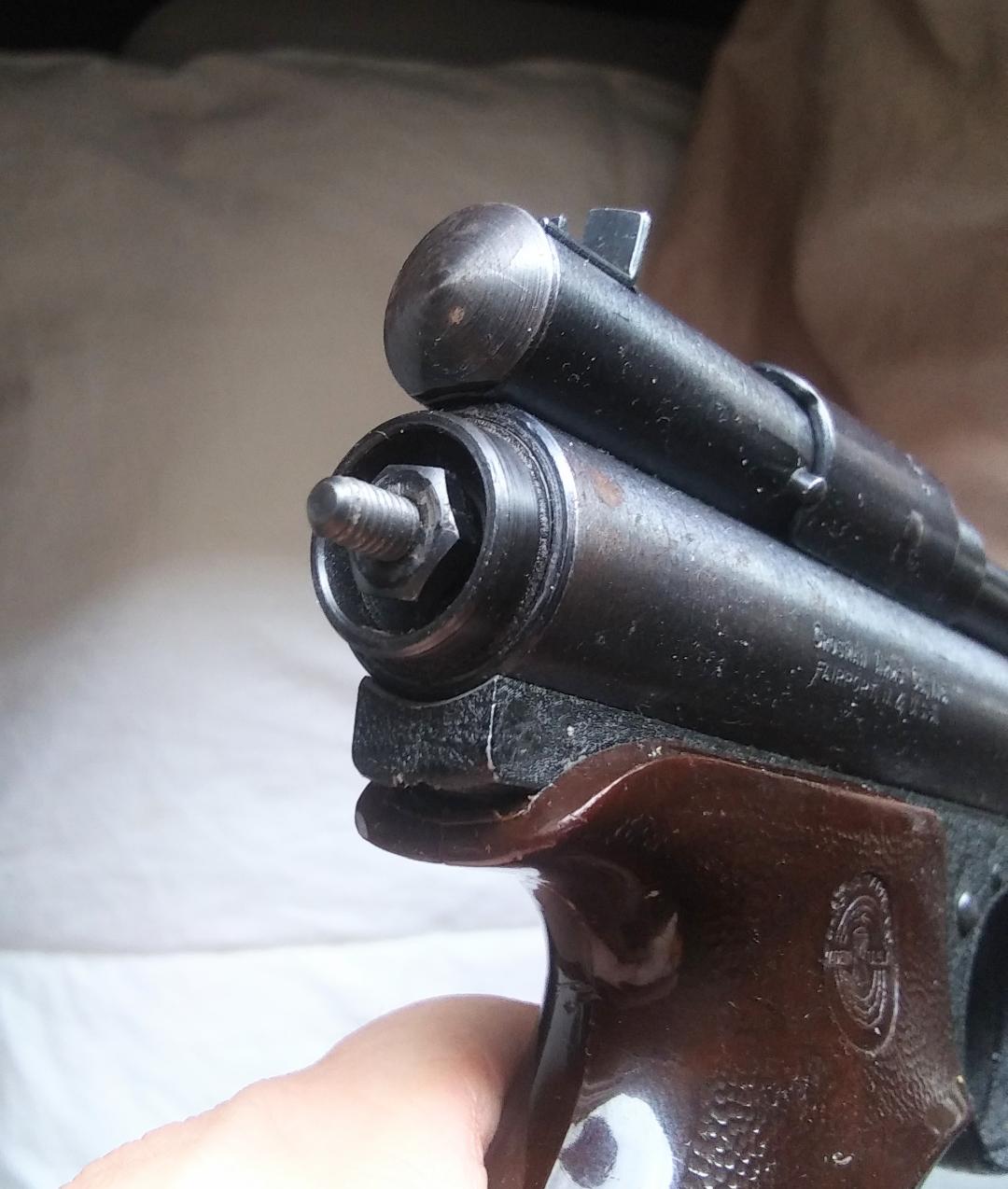

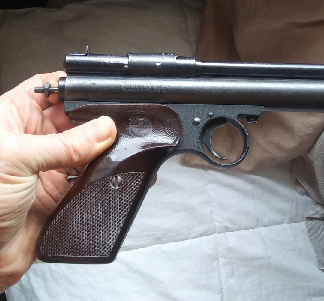

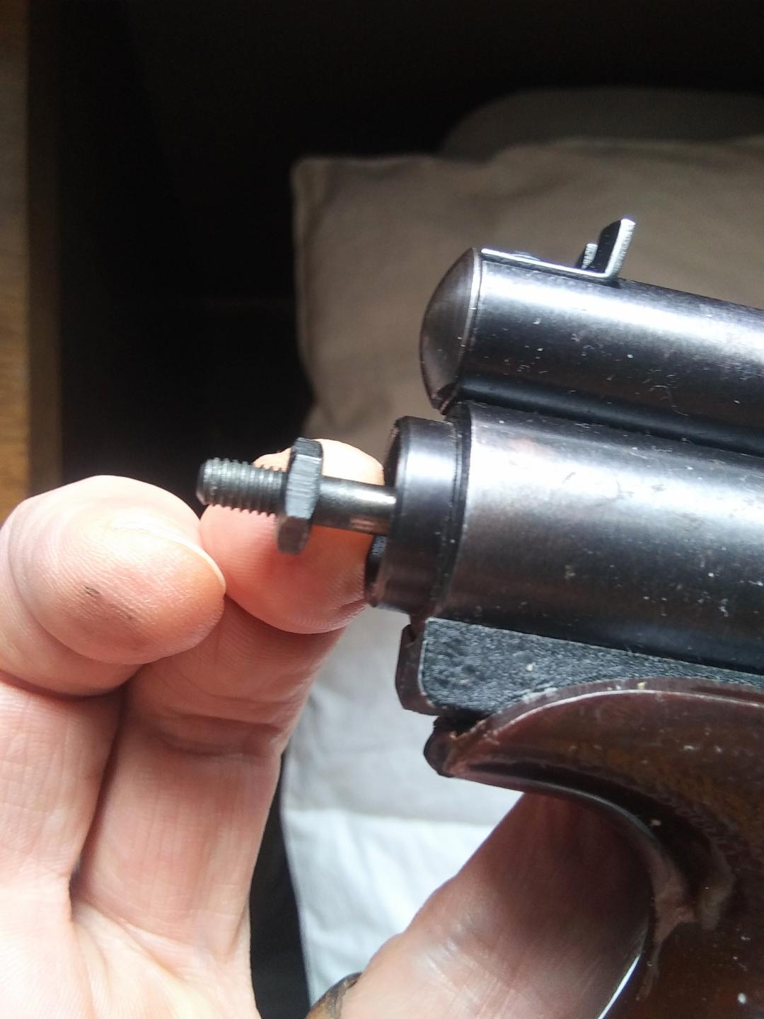

After plinking around with my 150, I walked up a long hill to my car and when I went to put the gun in its case, the cocking knob was gone. I retraced my steps but no luck.
The gun still cocks by pulling back on that little nut (see pics). It fires fine and holds air.
This happened several years ago so I can't recall if the nut on the shaft was already there, or if I put it on the shaft after I lost the cocking knob.
Anyway, I would like to get a proper cocking knob for my 150. I am told the knob is sold with a "hammer assembly" but my question is, if I get the hammer assembly, do I just use the knob that comes with it and screw it onto the threaded shaft (as seen in my pics) and put the rest of the new hammer assembly aside for future use, or is not that simple?

Yours is the first generation and I think that nut belongs there! Second generation they did away with it. Its a pretty simple fix.
Two screws that hold the grip frame on and be careful because there's a small spring and ball that keeps tension on the safety!
And the screw in the rear sight needs to come out also! Just go slow and it's a pretty easy process.

ChuckHunter, could I please to get you to clarify two things. (1) You said the cocking knob and hammer are one piece but does the knob unscrew from the hammer? (2) Is the threaded rod sticking from the back of my gun, with the little nut on it, part of the hammer assembly and missing only the cocking knob?
A friend has agreed to use his metal detector and retrace the route I walked when the cocking knob fell off of my gun, so I am wondering if we will be looking for a knob or some sort of assemly attached to the knob (which I think I would have seen when I originally retraced my route a couple of years ago). Thanks again.
Yes your just looking for the knob itself!
And when you put it back together I suggest you put a dab of blue locktite on the threads to keep it from backing off again.
Good luck in your search 👍
And yes it is all one assembly!

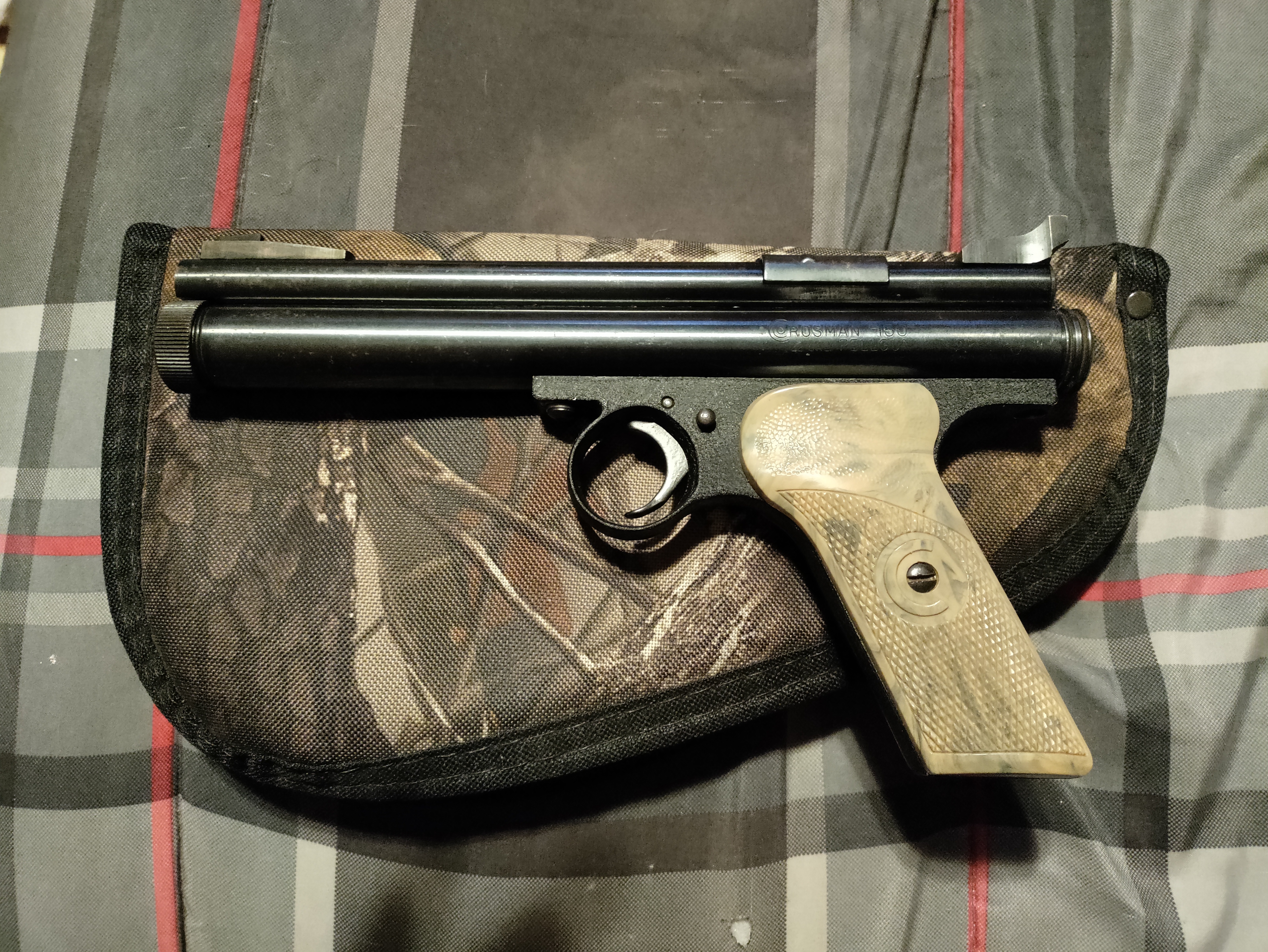

I'm pretty confident you'll find it with a metal detector! Brilliant idea 💡View attachment 340457
Thank you again. Nice gun, 1st generation? I cant tell if the breech and barrel are separate in the photo. I did contact Baker Airguns by email. No response yet. I might just call.

Hi ChuckHunter, I was able to talk with Rick Willnecker at Precision Pellet in PA. He's worked on Crosman's since 1972, age 13! Rick had several 150 hammer assemblies and he even had a cocking knob laying around from an old Crosman job he had done. He basically guaranteed me that I would not get just the cocking knob onto the rod sticking from the back of my 150. It doesn't thread on, it needs to be pushed/forced on while keeping that shaft from moving with visegrips or something like visegrips. He said, "I've tried it, believe me, it's like pissing up a rope" and I believed him! So, I ordered a new hammer assembly and he is throwing the cocking knob in with it. The way it sounded, even if I did end up finding my lost cocking knob, it probably would not have mattered. I highly recommend Rick and Precision Pellet. Nice guy and very knowledgeable!
