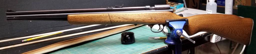

I just finished cleaning then replacing all the seals in a 140 I found in my dad's house after he passed. My best guess from the research I've done is it was made sometime in the 50s or 60s. There was zero resistance to the pumping action when I first got it. I got a rebuild kit from Accurate Airguns. My only complaint is there was no labeling as to which seal went where. I ended up trying to match an old seal with a new one as I removed them from the 140. Lucky for me the pump section was in good shape. The rebuild or replace of the pump I think is a little above my skill set. Here's the refurbish 140 and the parts replaced.

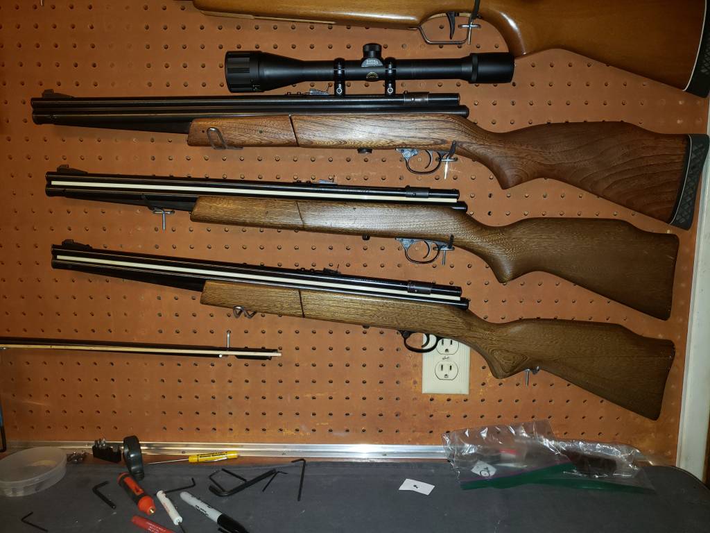

Excellent job TFM! And thats a real purdy shooter there. Pretty grain on that wood. I've got a few and really enjoy them. 6 pumps gets me 12ish fpe with single hole accuracy with Crosman Premier Domed 14.3. I really appreciate the all wood and metal construction of days gone past. I hope you find yourself some time and space to enjoy shooting that fine unit. Hope you don't mind if I share a picture of a few! And right on to Spysir for the link. I dig the "anotherairgunblog". Thanks for sharing!
