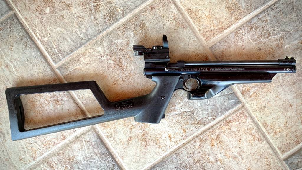

Crosman 1399 Shoulder Stock on 1322 pistol
My 1322 with a cheap Feyachi reflex sight was already a tack driver. The addition of the shoulder stock has rendered it into a surgical instrument out to 100 feet. It makes the pistol look a bit dorky, but I can't argue with the additional stability it provides.

Great thing is that the guns are ours and it really doesn't matter what anyone else thinks of them so long as we like them.
Love the 1377 for the simple accurate gun it is. There are so many things you can do to them to make them shoot better and last longer.
A couple of the best mods for the 13xx guns are an aluminum barrel band and flat top piston and valve set up. There were other barrel bands available that let you use a longer barrel but I can't find them at the moment.
https://maverickcustomairguns.com/product-category/crosman-upgrade-parts/crosman-1377-1322-parts/
https://gmaccustomparts.com/new-blue-1377-flat-top-piston-kit
I did however find the adjustable trigger sear. If you want an excellent trigger to squeeze out all the accuracy your gun can give try one of these they are great.
https://www.airgunsofarizona.com/parts/crosman-13xx/22xx-adjustable-trigger-sear/
the stock can be modded with basic tools, epoxy putty/bondo, and some bits of wood.
YouTube has some vids. The gun itself, as Bio noted, is a "blank page" for mods and improvements.
First thing you need to do is get ANOTHER setup like you already have, so when you're nose deep in mod/upgrae cycle, you'll have something to shoot.....
Yea they can be butt-ugly, but building one up to YOUR specs and needs is a beautiful thing
edit: dont forget to add a trigger shoe. Itll make trigger control sooooo much nicer
