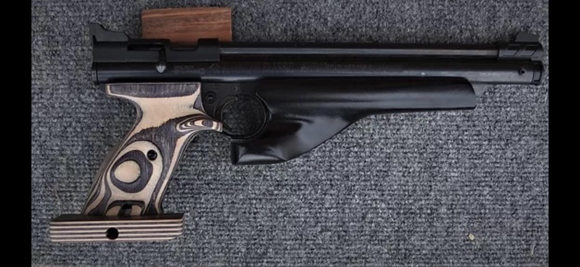

Steve Corcoran makes a pump arm for the 1377/22 that might be something for you to look at
Reactions: Animalcub7907
Wow that looks nice! What about this Plumper Pumper from Buck Rail?

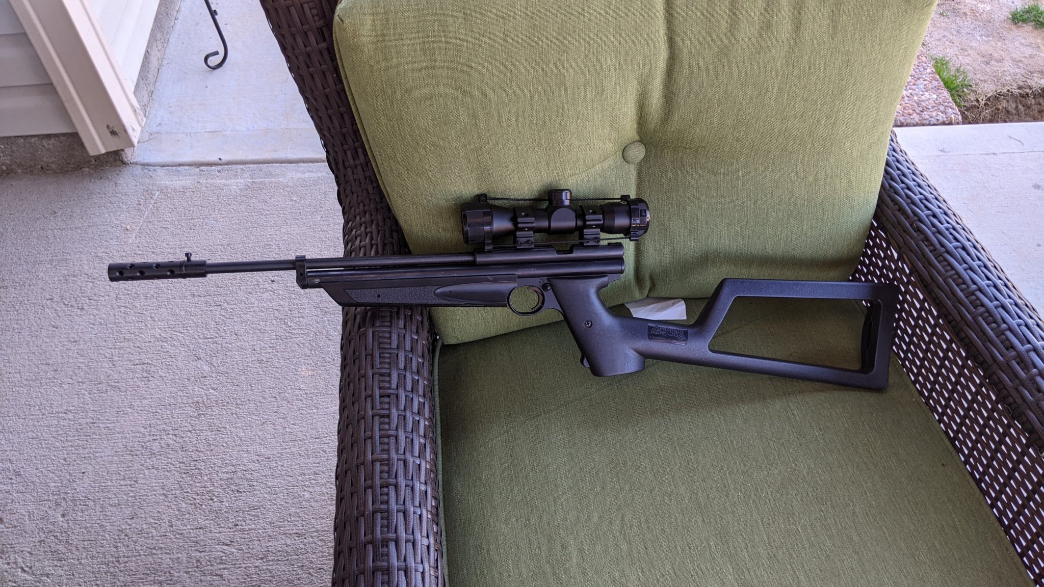

Quick update: I picked up the Crosman steel breech kit and just installed it. The gun definitely feels beefier just by doing that. But now I'm confused about what exactly I would need to get a scope on it.... is it possible to get something like this on? https://www.amazon.com/HIMIFOY-Tactical-Illuminated-Rangefinder-Holographic/dp/B08F39NZXV
Feels overkill but the cool factor is there LOL. Otherwise, what mounts/adapters would I need to get something like that installed? Right now I have no rear sights :(
The Amazon sight looks like too many features for the price-A decent 4 power scope with adjustable objective (I like the Leapers/UTG, and Hawke) and some Leapers/UTG dovetail rings and you'll be in great shape for close range pesting. The Crosman barrels are usually pretty accurate. Mine likes H&N FTTs and anything JSB makes. You can lighten the trigger pull by removing the trigger spring, sliding it on to a phillips screwdriver and squishing the spring shorter. If the sear won't catch, stretch the spring till it does. The 13xx platform is a great value IMO, remember to store the gun with two pumps of air to preserve the seals and lube the pump cup with Pellgunoil once in a while.

Thanks all. I compressed the trigger spring and now the pull is more sensitive - that'll be nice! I have Hoppes 9 from my 9mms - is that OK to use to oil the 1322? As far as scopes, I see the dovetail mount along the breech now - it wasn't so obvious to me at first. I've also seen that using the dovetail ring adapters is another option. There are some low profile dovetail->picatinny mounts but I read somewhere else that you actually want the mounts to be raised up higher to allow for clearance for the bolt and loading pellets in. This is starting to feel like a mini money pit LOL
EDIT: any suggestions on barrel lengths in my situation? 14.5"? I'm still deliberating over scopes... some are expensive and some are cheaper. I'm assuming you get what you pay for but was hoping for a unicorn among them :)
Are the Simmons Truplex scopes worth considering?
