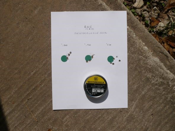

I found that my M-118 preferred velocities in the 575-550 fps. Range for best accuracy. It is quite capable of 600+ fps but the accuracy was not as good at that speed, maybe something to do with the flat head match pellets? The power adjuster was backed out 3 full turns from max. One thing I might mention I had heard of folks having intermittent feeding problems even with the use of proper pellets, indeed I had some as well I decided to closely inspect the feeding system to see what I could find. I removed the cam and sliding gate holder and as I looked closely I noticed a small break thru right above the magazine tunnel," ZAPPO" during the manufacturing process the drill that was used to make the magazine tunnel was allowed to load up with chips which forced the drill on an upward angle and eventually broke thru the surface, this caused the magazine to feed the pellets on a slightly upward angle and they would occasionally catch on the 90 degree edge at the top of the sliding gate cover, hanging up the pellet as it tried to exit the magazine, a bevel on this edge completely eliminated this problem, never had any feed problems since this adjustment!!
Field range test delivered the following: shot-1 -571 fps shot 30 -534 fps for an average of 553 fps@ 9.48 ft. lbs. RWS Match 14.0 grain. Best target equaled 5 shots .860" center to center largest was .926"" center to center for an average of .893" center to center @ 25yd.. Not bad for a Peep sight and 78 year old eyes!! A scope would undoubtedly improve group size but I have resisted that because of the design of the straight pull up bolt action on the M-118. One could use a Front Scout type mount I suppose, requiring a Long eye Relief Scope; I am not interested in that! The M-113 -114 Rifles can be scoped easily.

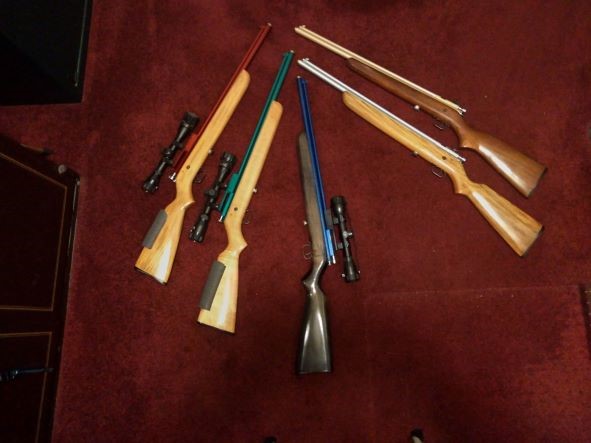

I have attached a series of photos that may shed some light on some of the items discussed above. I have also enclosed a photo I call a “Kaleidoscope” of Crosman Models 113 and 114 Rifles; Red, Green, Blue, Silver and Gold; that I refurbed and are part of my collection of 20 total currently.
