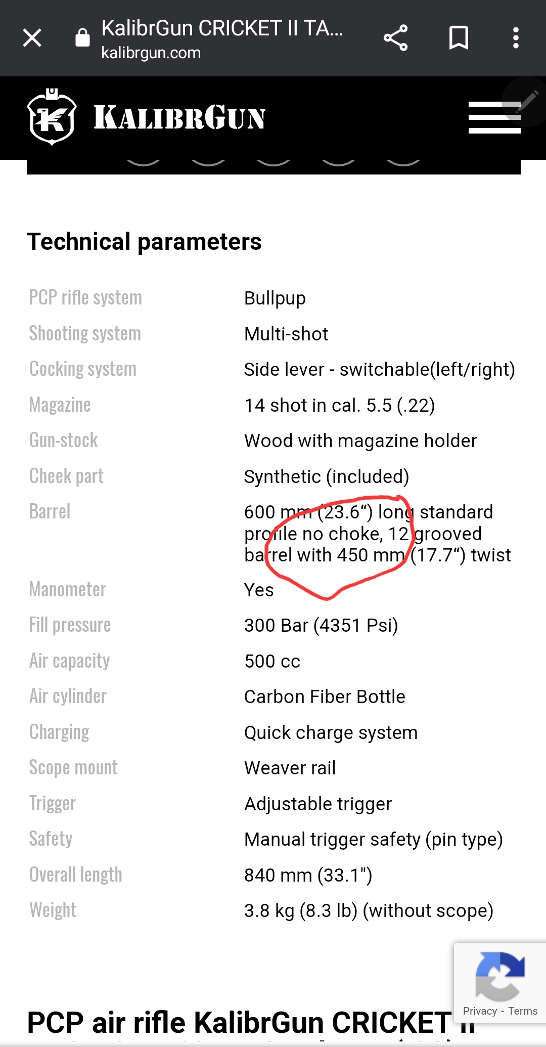

So it's exclusively for slugs.
I tried some slugs and jsb redesigned 25 grain pellets. The barrel preference is Jsb redesigned .22 25 grain pellets.
Jsb knockout worked reasonably good and h&n couldn't give accuracy.

Found the issue that was causing inaccuracy to 18 grain jsb pellets.
Removed the barrel and found that it is really un choked.
But the real problem was that the barrel was tighter at the breach. It was so much tight at breach that after the breach the pellets started free fall all the way out of the muzzle.
I polished the tight spot at breach to the extent that now 18 grain pellets after crossing problematic area remain snug in the barrel all the way out of the barrel from the muzzle.
Tested jsb 18 grain at 24 yards. It's one holer now.
