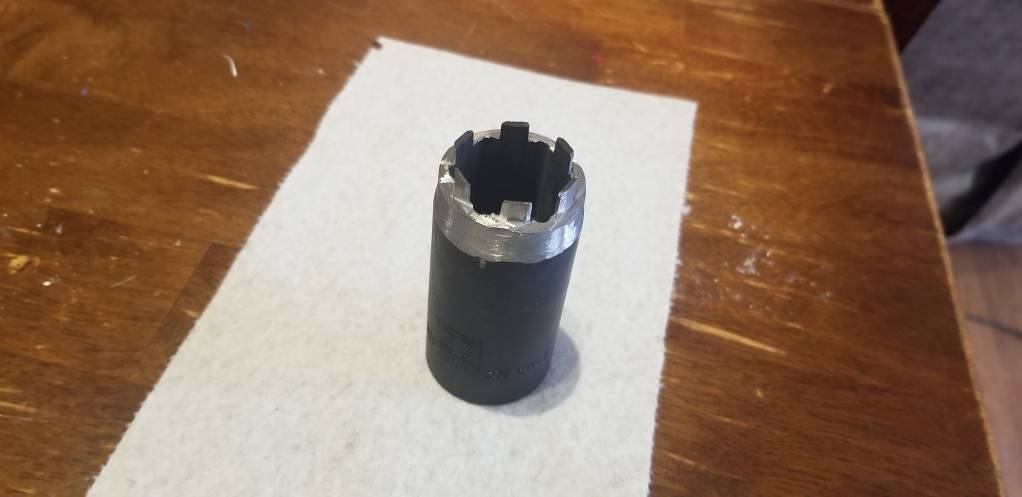

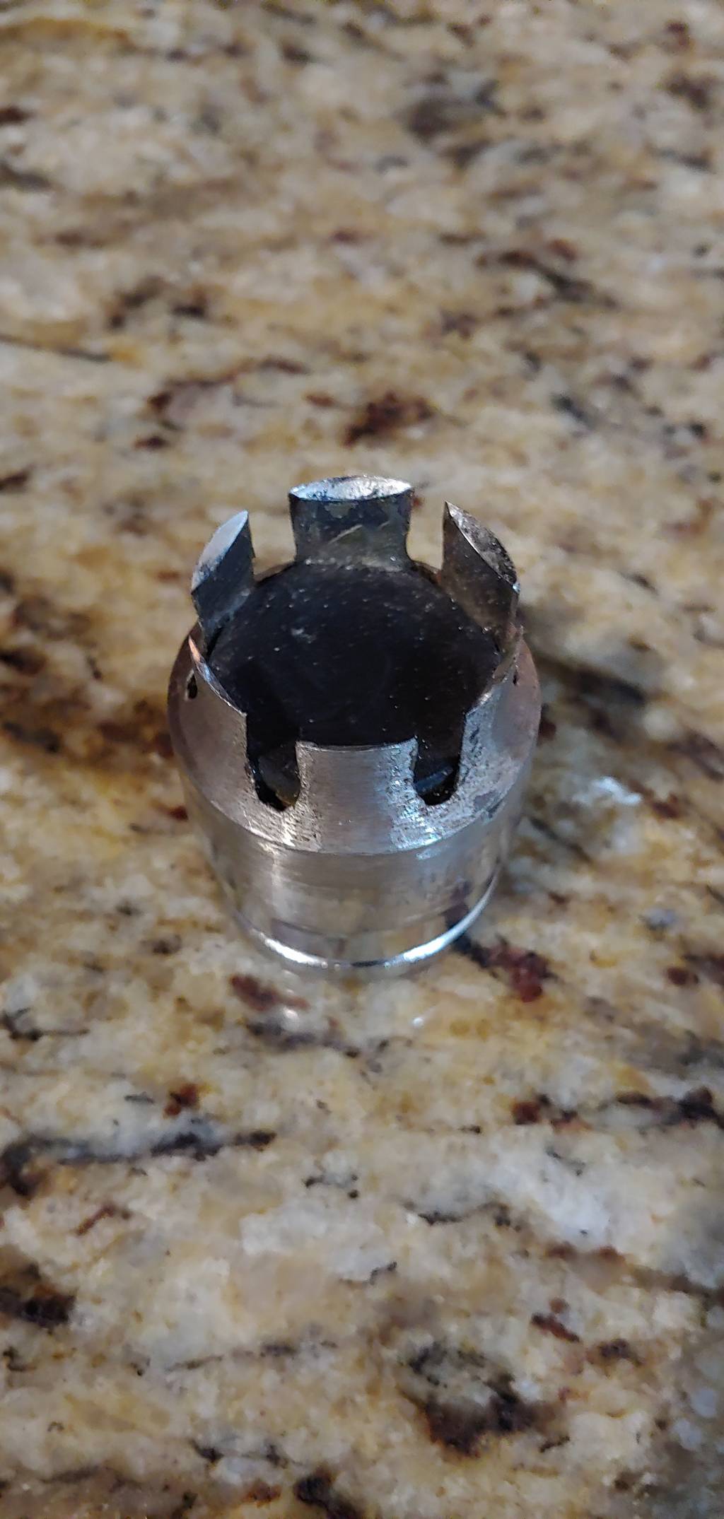

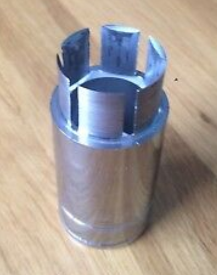

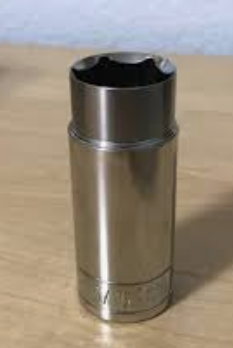

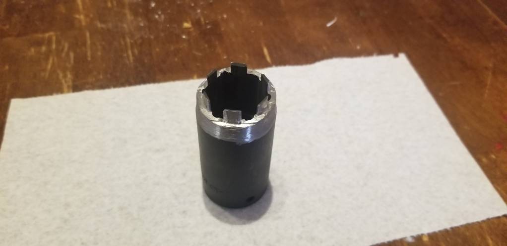

You can make your own wika manometer removal tool by turning a 27mm socket.

I have a leak in my Cricket, pretty easy to disassemble, o rings ordered and in possession. leak is coming from the front of the tank near the gauge. Besides trying to make one of my own, I looked on ebay and non is available. any ideas? Cricket is one of my favorite PCP's
@Twohsieh If you are in a bine and need removal tool shoot me a pm with your mailing address. I will drop mine in mail to you.
