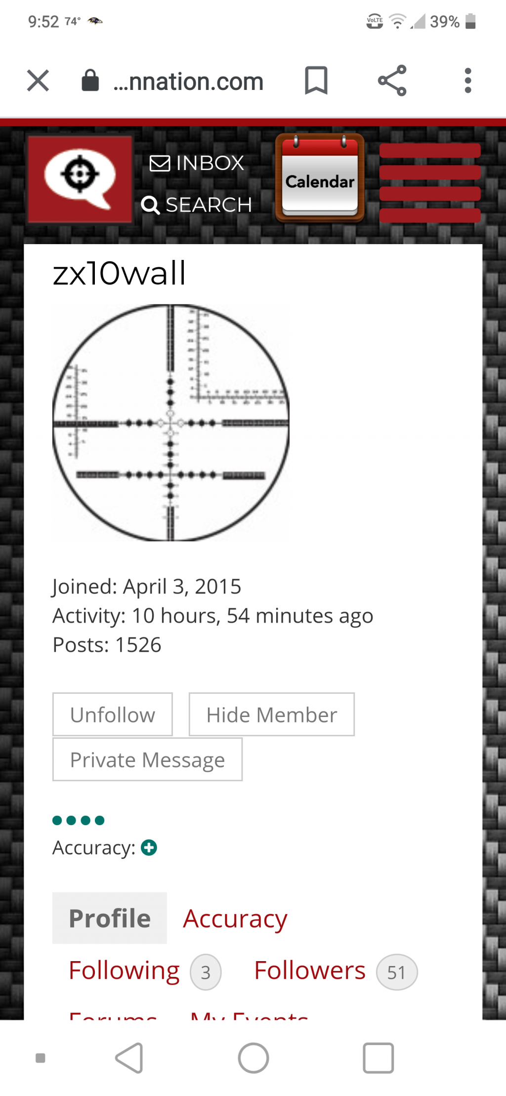

Shoot Derrick Wall a pm. Fantastic guy to work with.
