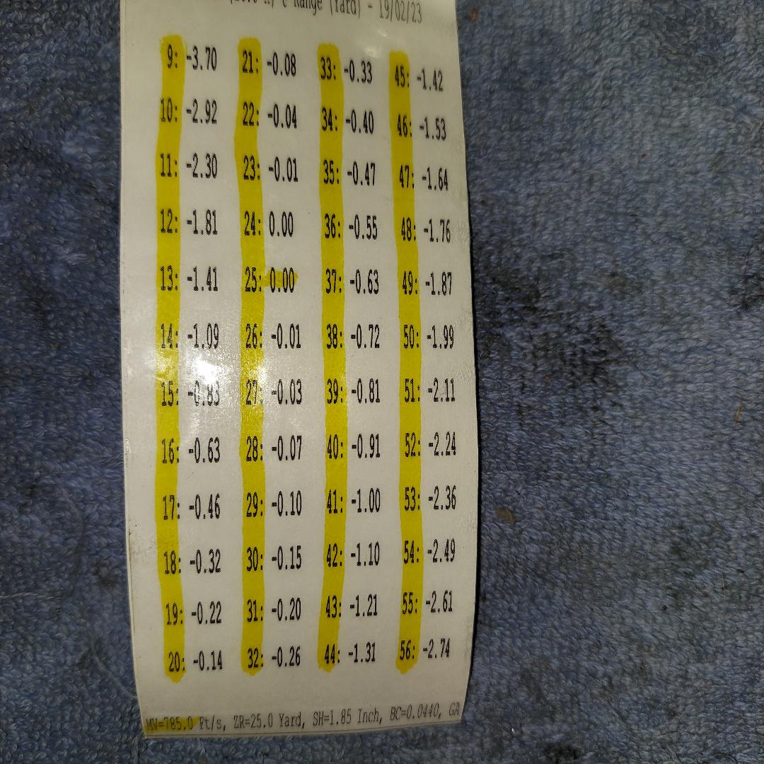

trick is to find a zero wind day and time and shoot from the most stable platform possible so you can work your way out from 9.5 yards to where ever you call it quits.... my EFT rigs i go yard by yard after 30 yards out to 100 yards.
This a fine tuned and adjusted "Chair gun" created dope card.
While hold values are in 100ths ( 2 decimal places ) it does allow knowing the EXACT theoretical POI in "Mils" as viewed threw optics.
Any thing 4 yards +/- or more off my 25 zero i start leaving the center of KZ and do not make the mistake the Zero range is as broad as many assume it to be. Errors in ranging distance, poor lighting or beat out KZ's can and will bite you !! Free wisdom ;)

I just learned to click in the last couple of months. Ohhh how sweet it is! Especially with an Mrad / .10 mil scope ! A 1 holdover is 10 clicks…. How easy is that 🤪
