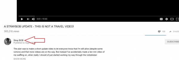

What's the name of the youtube channel you put the video on?
I don't have a you tube channel. I just put it on my son's channel. I don't know much about it at all. Sorry. I did paste a link in a previous post in this thread. My sons both got on their computers, got on Airgun Nation, clicked on the link and watched the video. Someone told me the link doesn't work but others have watched it, as did my kids, so I don't know. Pretty new to me. Stoti
I fixed the YouTube link, it's in a link in my last post below. Sorry about the confusion.
Your son's youtube channel has a name. I'm sure he will tell you if you ask him. I'll put a sample of a youtube channel name below...
