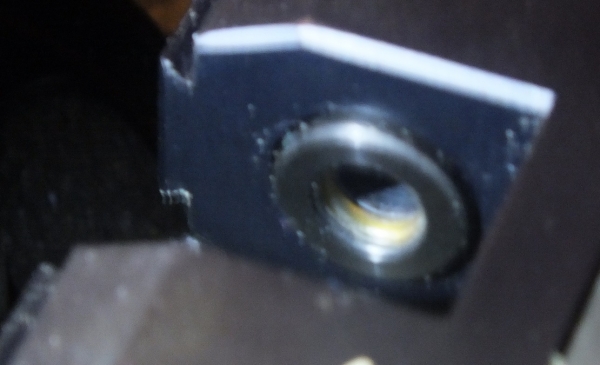

The picture below is of the Marauder breech, the barrel was slid back until it made contact with the Magazine, without pinching it. Then the screws which secured the barrel were tightened down.
