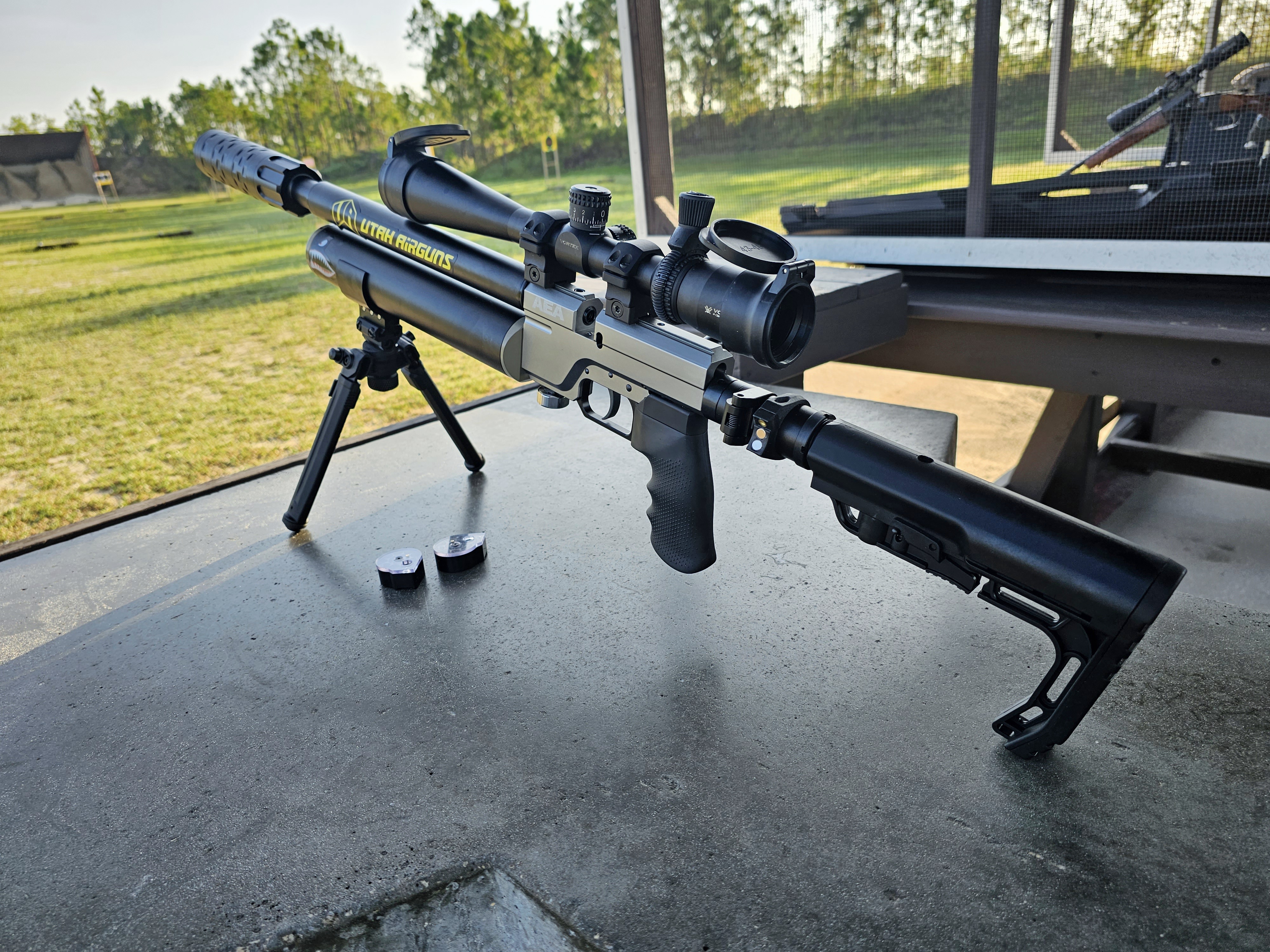

Managed to get a spot on the range today with my aea max 30 cal. Needs a fair holdover at 100 yards. Although the bottle pressure was dwindling at that point in the day.
At 50 yards during mag 1 and 2 this thing shoots lights out with the jsb 44.75
Not sure if the circa 90lb at the muzzle would be enough for a coyote approaching 100 yards but at 50-75 yards you can pick which hair you wanna hit.
Really enjoying this rig so far.
