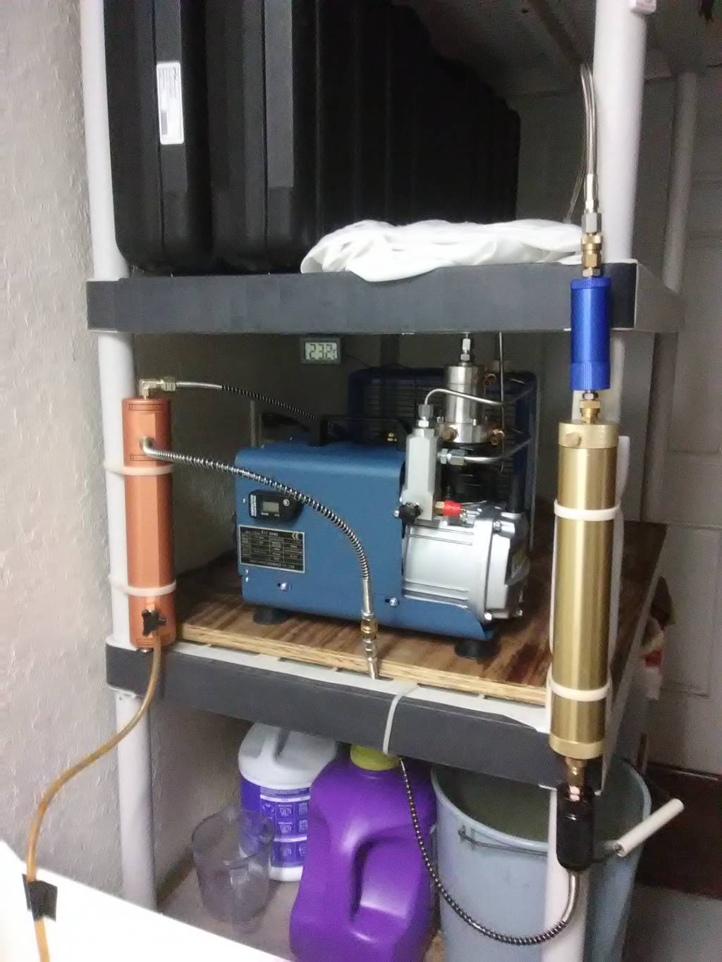

Bought mine from best_homepro on eBay in June for $272,50 (no tax, free ship) listed as Item ID# 224288811755. Is real Yong Heng. Is Set Pressure model, but, per Biohazardman's fact sheet, there might be another, less expensive model, he now recommends. No spare parts for me but you can see my humid Florida garage requires $125. water separator, in addition to gold filter. (Gold filter has built-in burst disc.) I followed Bio's suggestion for oil, HUSKY brand synthetic blend air compressor oil for hour break-in, full synthetic HUSKY air compressor oil after that.

the coalescing water separator on the left in Worriedman's pic is the most effective. It removes a heck of a lot of water.
I use that followed by a smaller black cotton filter.
I used to use a big gold filter but after getting the coalescing filter I realized those cotton filters are no where as effective.
