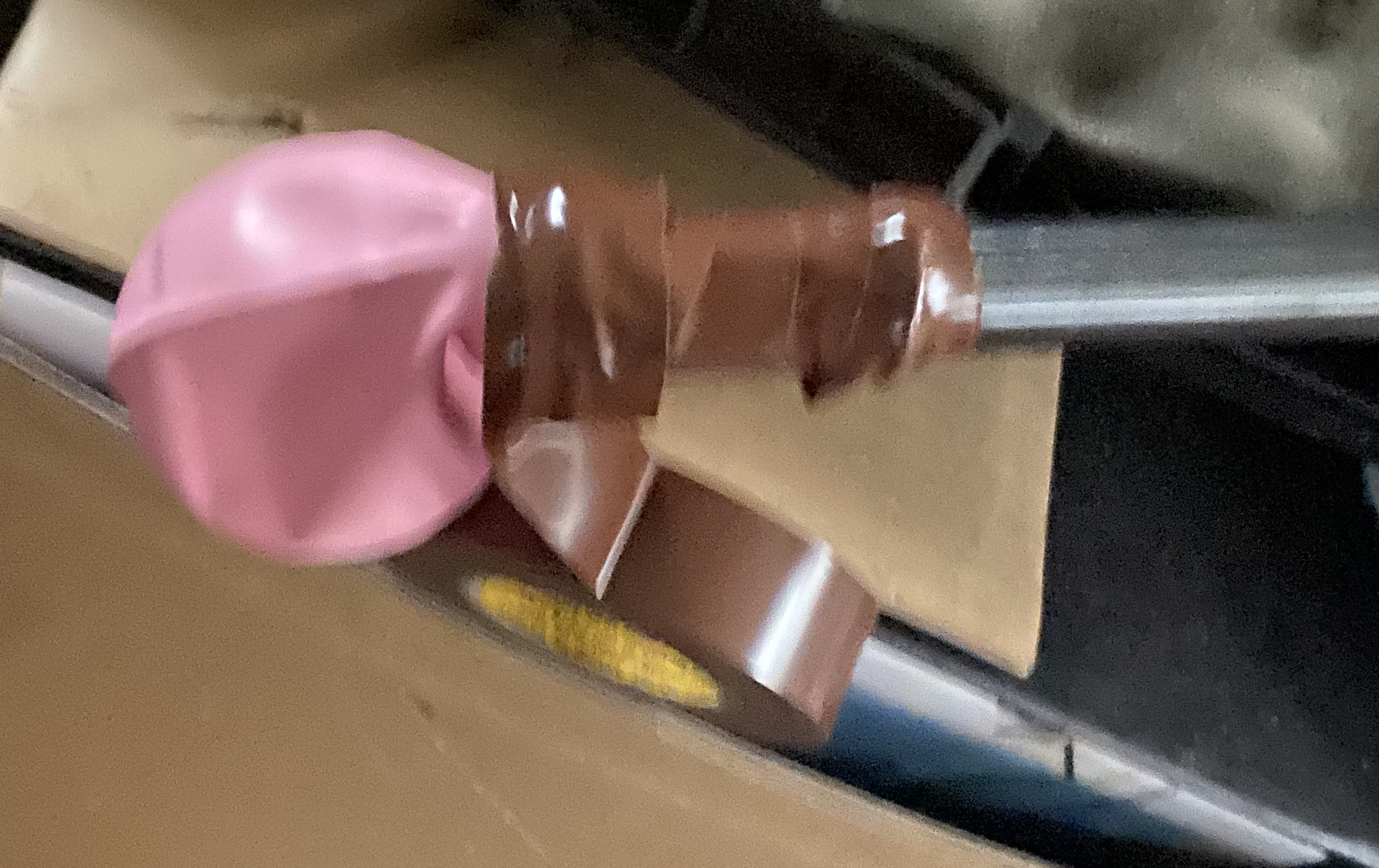

LEAK LOCATED!
After not finding the leak then first time around I redid the balloon tests on the barrel and fill fitting
The difference being that this time I reaffirmed the balloon's seal by taping over the neck with vinyl electrical tape.
It took no time at all for the balloon on the barrel to start inflating.
In my limited view that means that air is passing the valve.
Either because the O ring in the seat is bad or the seal between valve & seat is poor/obstructed
If anyone has a different idea please mention it
It should be a very straightforward fix
Once the pumps is removed the valve & seat are very accessible
Just like a Royale.
Before disassembling I am going to shoot 3 or 4 mags and see if the valve obstruction (if that's what it is) clears itself
More later
Edward
