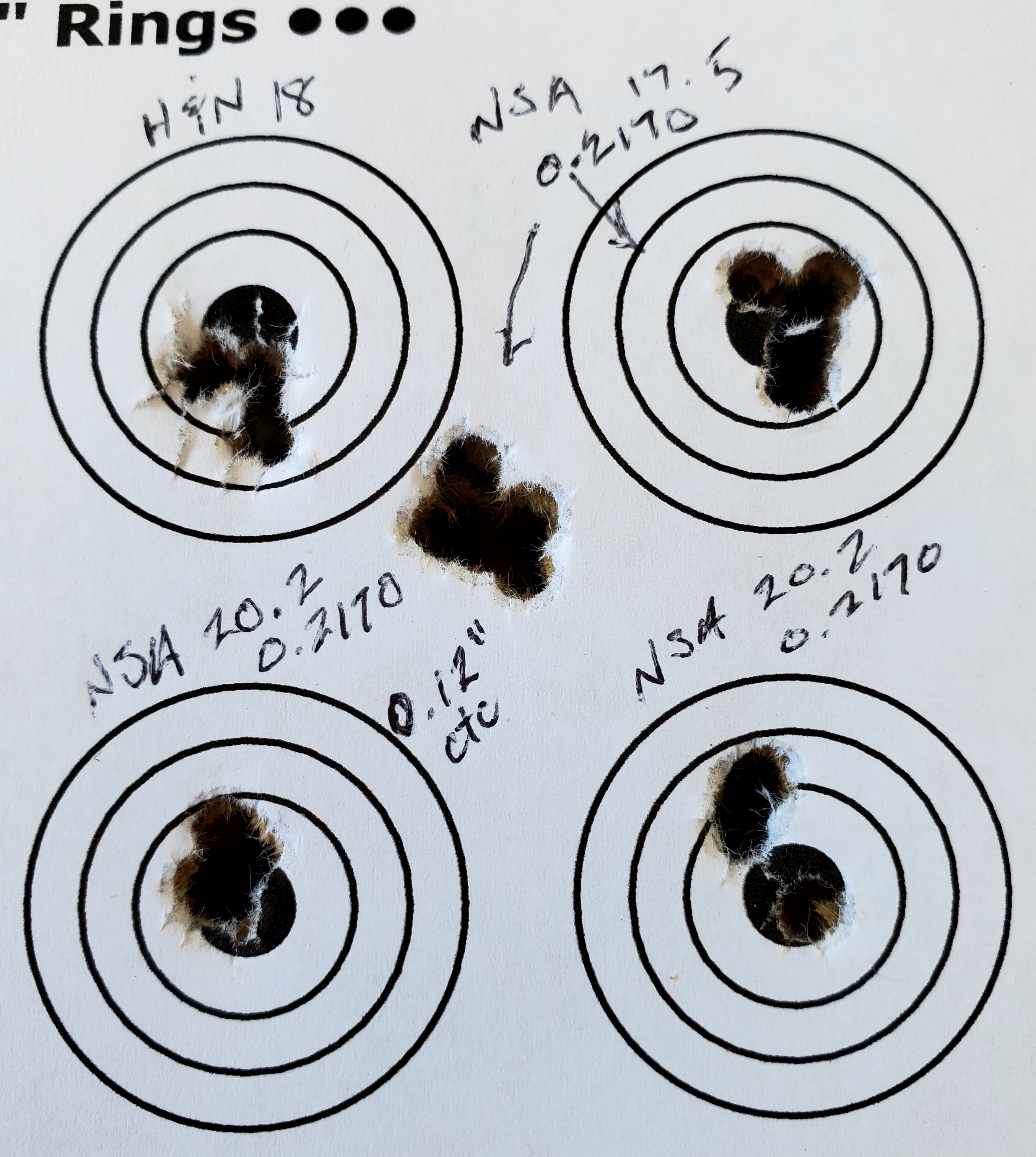

I was just about to give up on slugs in my Kral until I shot this at 30 yards. I tried a few different slugs without success as well. Also, it did take some work on the gun to improve accuracy from stock with pellets and slugs. Again, I just found this so I did not try it out at 50-100 yards which is my intended distance for slugs.
H&N Baracuda 18 top left vs NSA slugs @ 30 yards. 5 shots each.
The H&Ns are not the best pellet in this gun but they are decent. NSA 20.2 @ 740 fps and NSA 17.5 @ 810 fps, H&N 18 @ 830 fps.

I have been worried about the lower velocity, lower spin rate and lack of stability destroying my hopes of success with slugs in this pretty much stock gun.
When I can get out there, we'll see if I can outdo the trusty old JSB 16 at distance.
Spin rate, ammo length and velocity all work together for slug stability.
I get great results from FX Hybrid Slugs in my Maverick, and that has a 1:26" twist rate. So don't give up on the slow twist rate just yet.
But your gonna have to try them out, and try them at longer distances to be certain.
