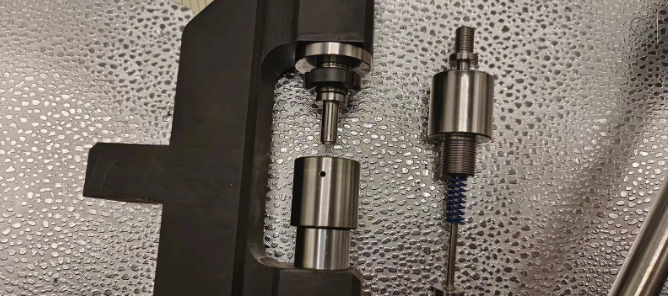

I just ordered a press from https://www.thormoldsinc.com/ but thanks...they're custom sizing die for .3063 for the AGT Vulcan 3
