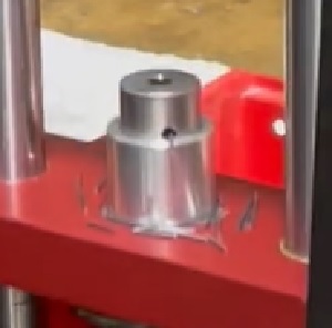

What RCE press is that? Looks like the $325 Sea Girt-3 Press?
Your setup seems pretty darn good. Could you explain exactly what you did to make it? I assume just buying the press and making a die isn't enough.
Could you post pictures of the parts you made yourself?
If I wanted to make the same setup, what parts would I need to buy and what parts would I need to make myself?
It’s a sea girt 3. You just have to make the dies…The press does the rest.
Mike

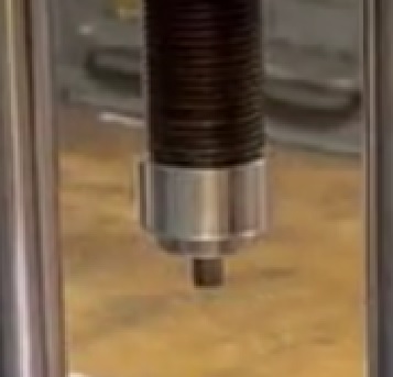

So it seems you have made 3 things for the press?
Push press thing screwed onto the top screw.
Nail spike sticking out under the spring? Is it there to raise the spring or something?
Die for the slug.
So to make your setup I need to make the top press pusher part, the die and that spike thing? What is the spike thing for?
How does the push pin work and the ejection of the slug? Your hand is in the way in the video so I can see how it all works.
Could you describe exactly everything you did to get your press to that stage? or is it as simple as making a screw on push thing at the top and a die?
Is the spike related to the ejector pin?

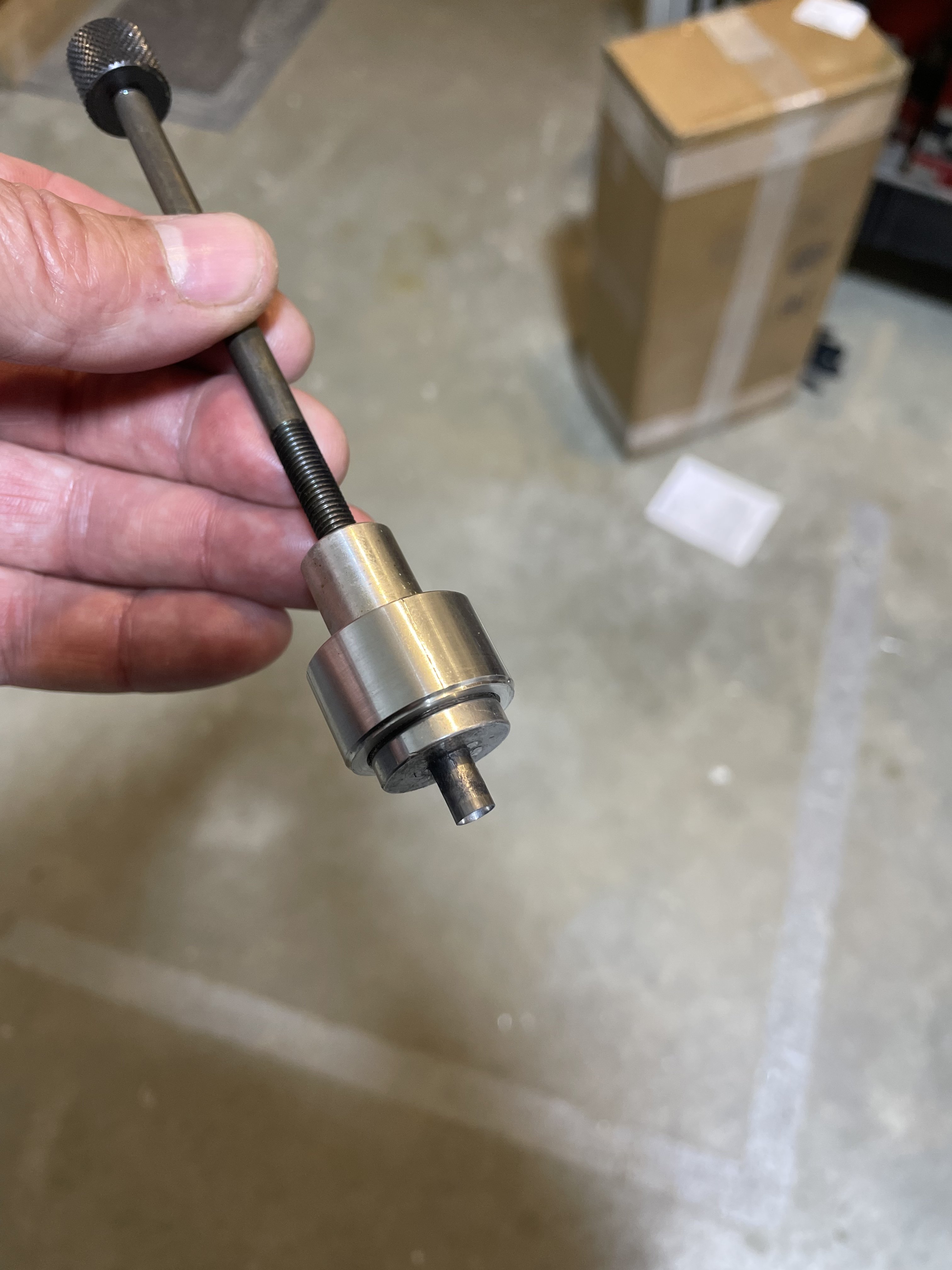

The nail looking thing comes with the press. It’s just a 1/4” shaft. That is what performs the ejection process. When the ram is lowered the cross shaft contacts the press base and as the ram is lowered further it pushes up on the ejection pin.
The ram is threaded 7/8-14. My dies were not originally made for use in a press like this so they just has a smooth body. I had to make a threaded bushing to press my die into. That’s what you see.
The top piece is also just a bushing that my original die cap is pressed into. The press uses a draw bar that runs from the top through the threaded portion and into the bushing. Tightening the draw bar holds the upper in place. You want to have a little float in the upper piece so you can adjust the alignment before tightening the drawbar.
Mike
So those two things are the only ones you made yourself?
Could you take a closer picture of the die, it's hard to see exactly what's going on from that small picture. It looks like there is a space between the die and the lower part with the spike? So the lower part came with the press and it's just the top part that's the die you made yourself then?
Hmm, doesn't seem too hard to do. I guess I could order a die online but the top die cap I would have to make myself.
