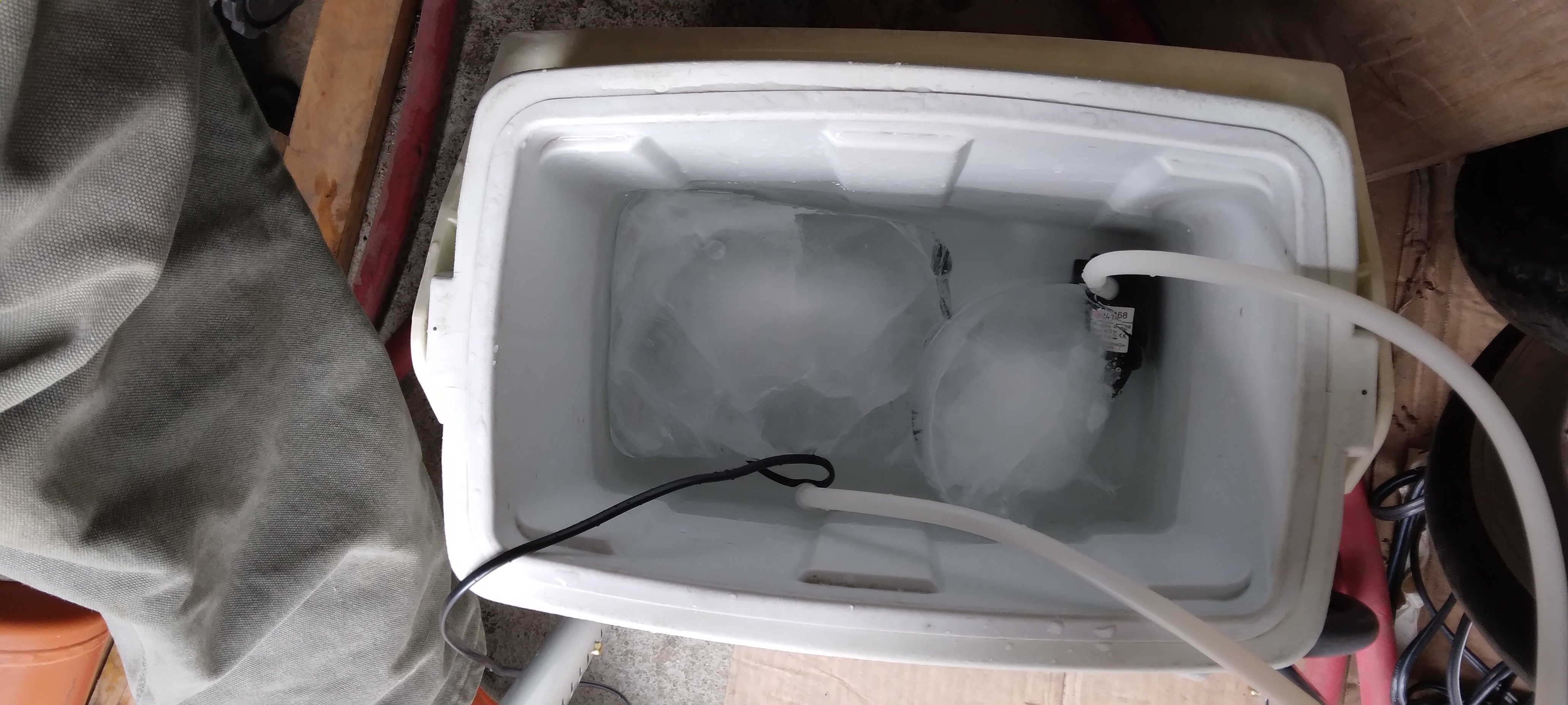

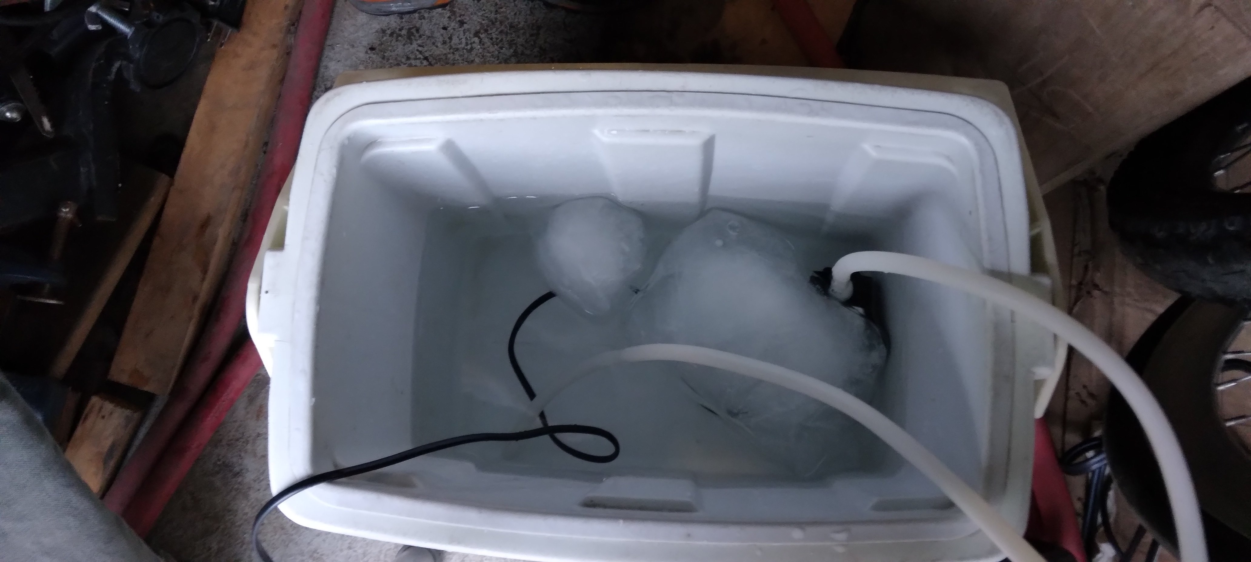

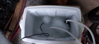

IMO, this works the best, blocks of ice , frozen in food containers, remove from said container, bare ice, best transfer possible, also, just float the ice when adding the water. Separate the feed and the return lines in the cooler, opposite ends, hot side/cold side, for best efficiency. My unit runs at 40 C to 44 C max.
Pics are before and after 15 to 20 minute run. Also, make sure the tube, lines, do not get in a position to possibly bend /crease inhibit flow 20230627_155449.jpg20230627_160901.jpgnear the hot metal air tubes.
