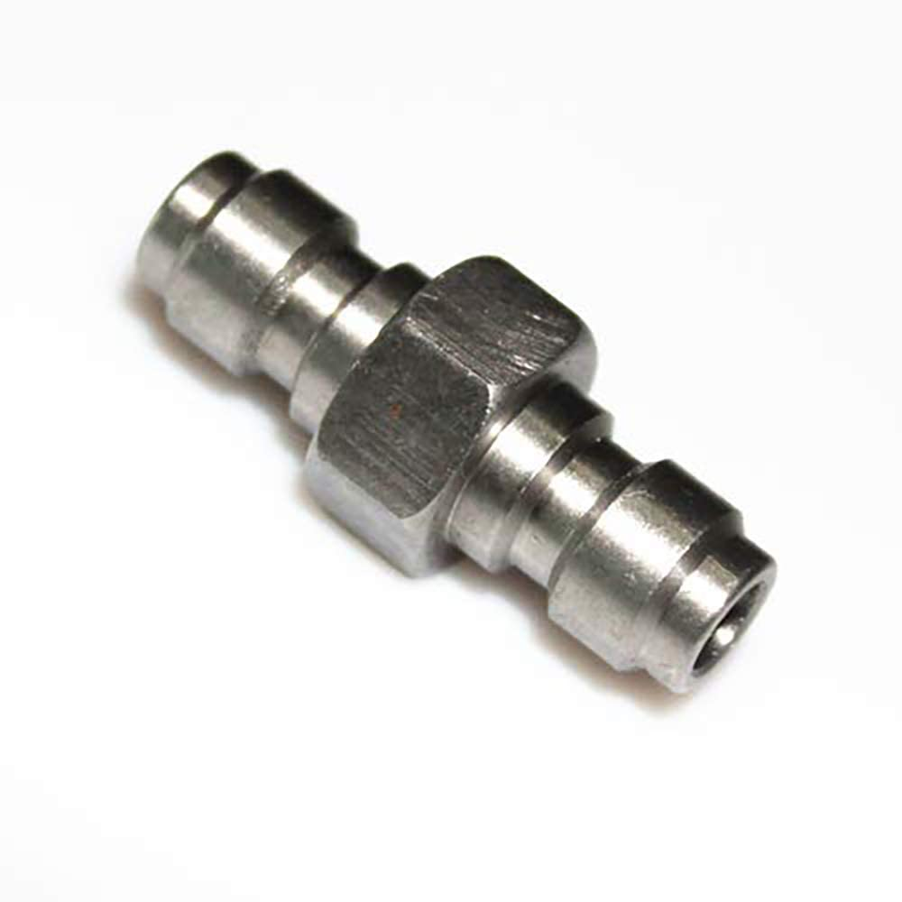

I set up my tank with a male fitting like you are wanting to and it has been much better than having a hose screwed into the assembly. I also got several male to male fittings which makes it easy to combine more then one hose as needed. My recommendation is to avoid the male to male fittings made of brass, sticking with stainless steel only. I also plan on replacing all my brace female fittings with stainless steel eventually since I am requently filling to 4500 PSI and some brass fittings are not rated for that pressure. Per advice here on AGN if you get a male fitting that doesn't connect smoothly, slowly and lightly remove the sharp corners with some wet dry sandpaper until they connect and release properly. Be sure to clean off any sanding residue before inserting into a fitting to check for fit.

I did a quick search for a male Foster with a male 1/4NPT with no success. Found a male foster with 1/8NPT female that you would need to use a double male, 1/8 on one side and 1/4 on other side. I would use a steel or stainless steel not brass. And not from home depot.
Or like this...
with a regular 1/8npt male QD foster like is on a paintball reg, or crosman pcp, but without the check valve part
