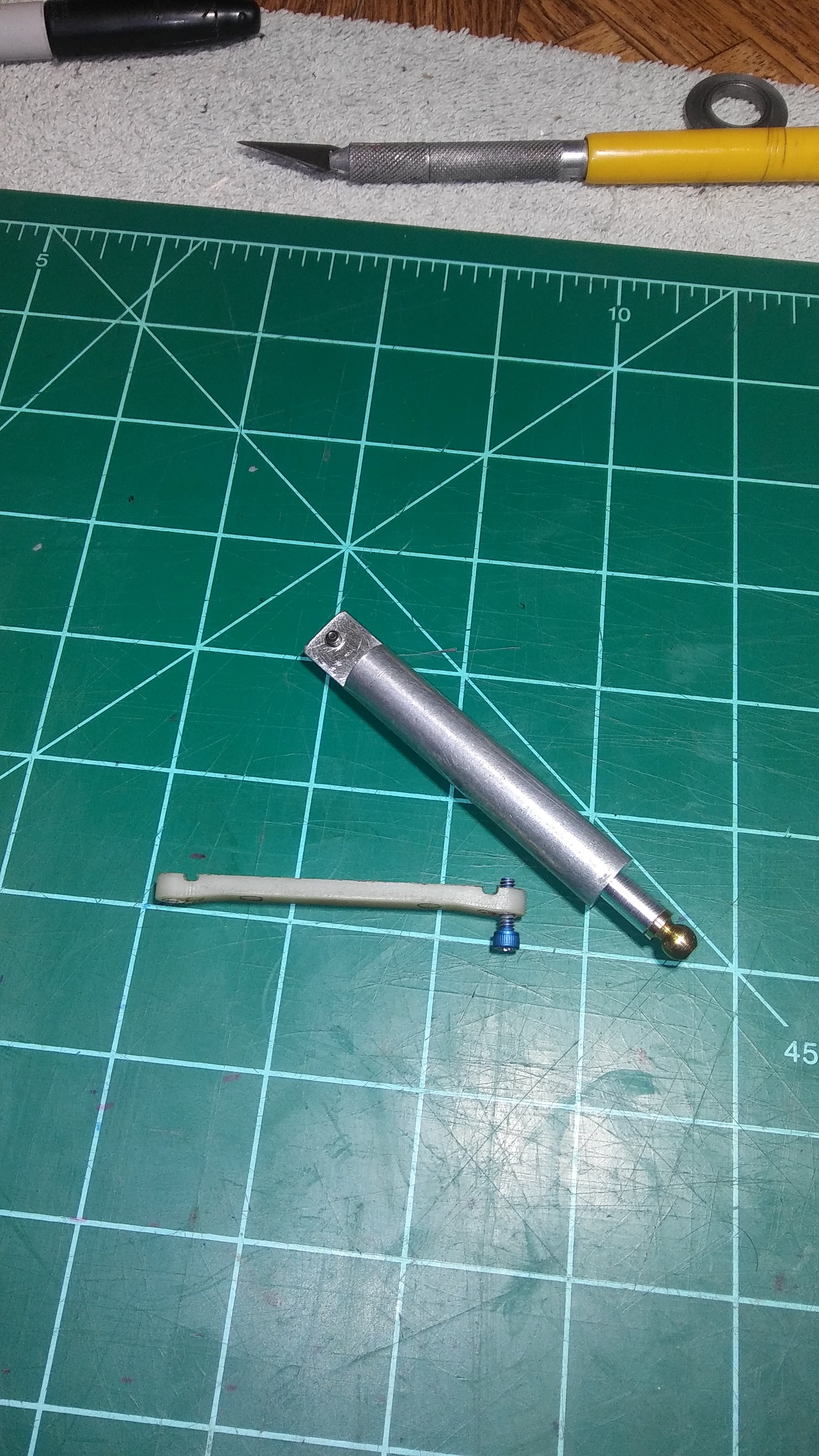

YEP same thing. I noticed if you just put them in some get loose and bounce around in there. So I took like a little hex wrench myself and was starting to deep seat the slugs. I am trying to do this at a constant depth to see if I can get consistency for a group. Still playing with these ideas...... Will have more to follow. Thanks again,

Try using tape wrapped around the hex at the length you want it to stop🤙
This was the 10 second fix. Aluminum 4-40 SHCS onto a piece of nylon. And its adjustable.
