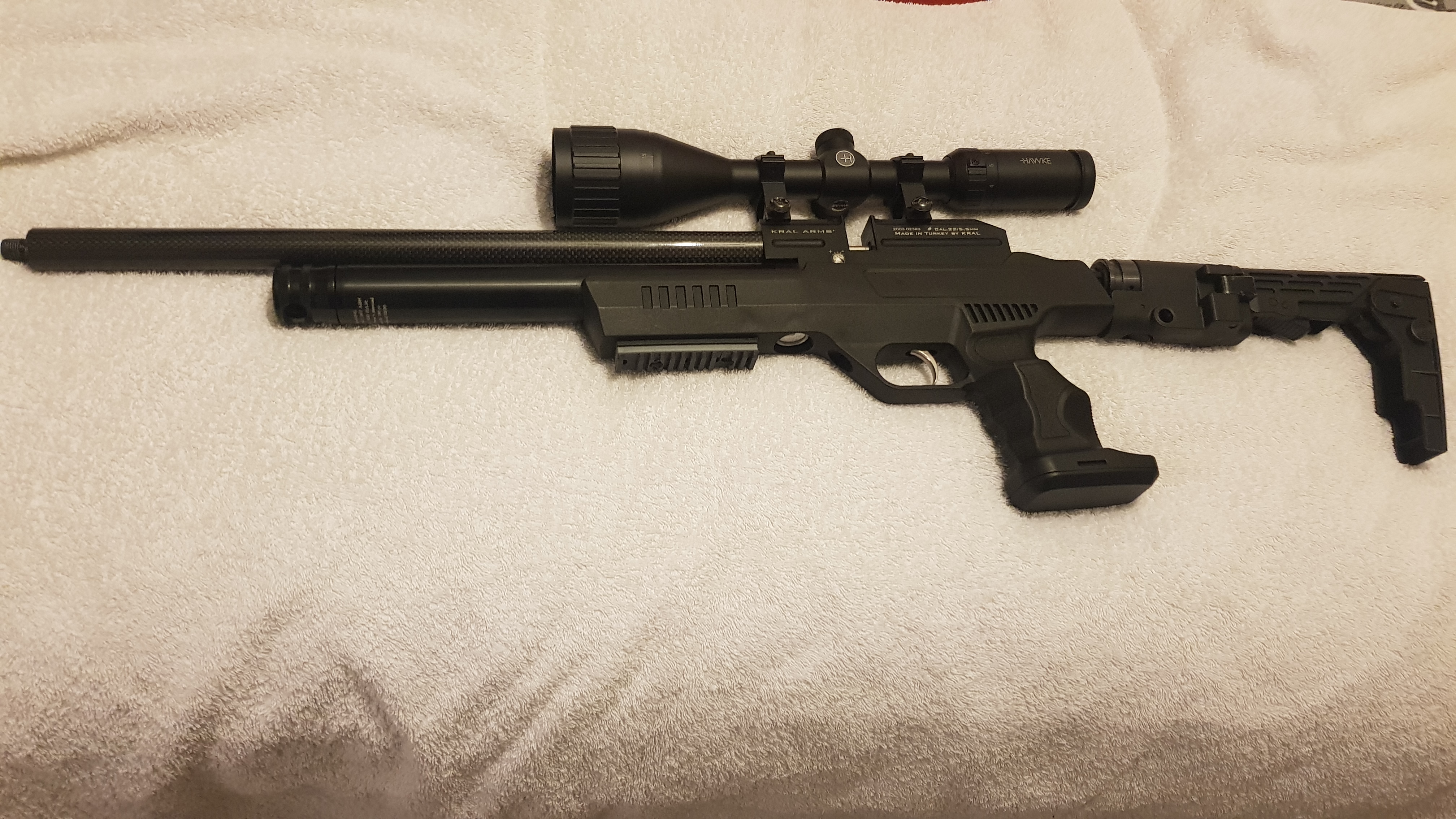

Hi mat I'm sure someone has done it. But you will need all the parts from a bottle fed kral" so you may want to way up the cost first. I put a longer air cylinder onto mine but it did make it quite abit heavier. Being basically all the same platform it may pay you to just buy a bottle gun unless you really want the np03 on the bottle. My np02 leaves the 03 in the shade in most departments except accuracy as I put in a walther barrel to accommodate the longer cylinder. But otherwise the 02 is a great little gun with a massive shot count and still very accurate. Hope this helps

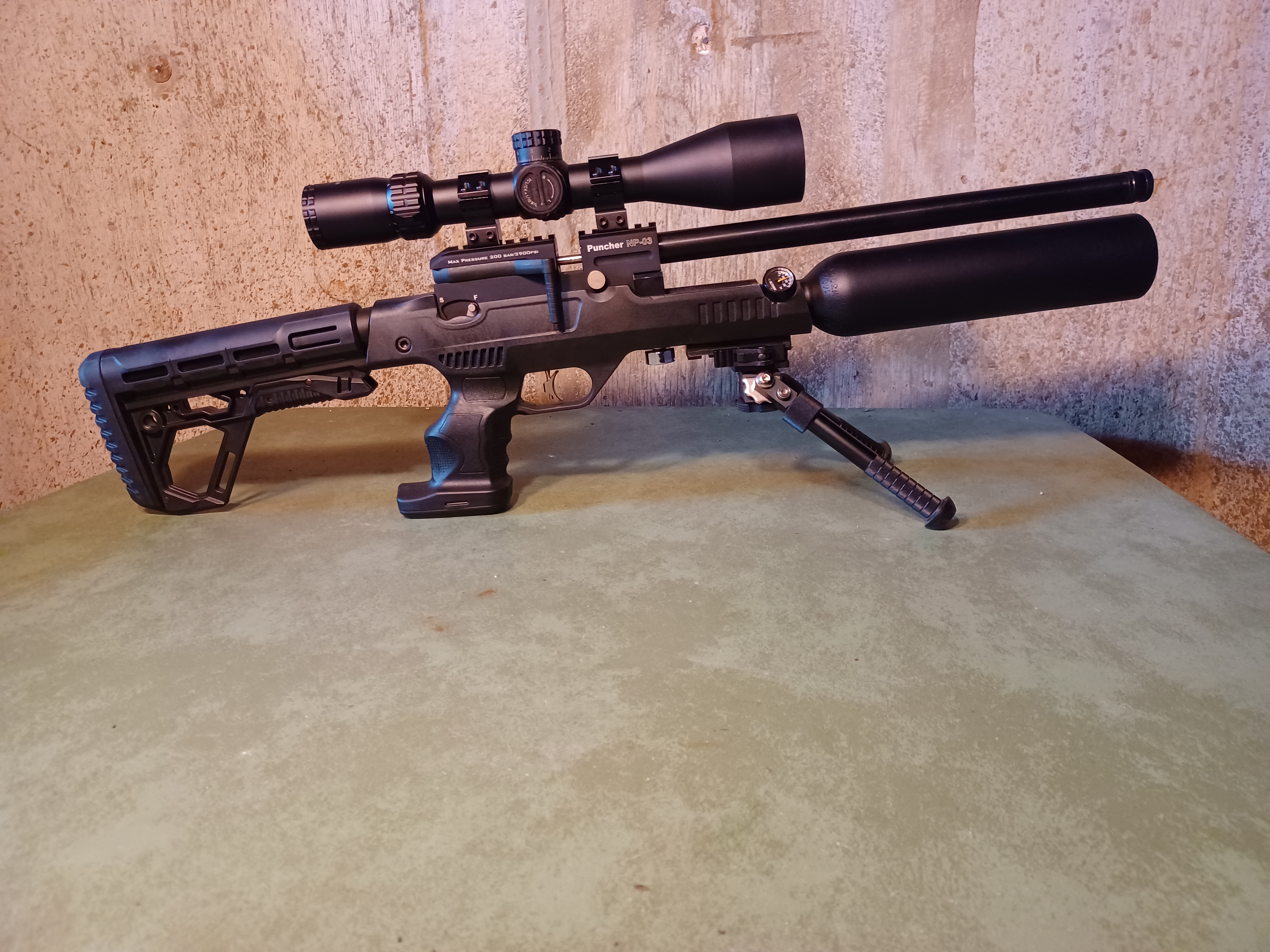

Many thanks for your candid advice. Many of the points you made I've considered and you are right about cost of parts etc are valid points. Its especially interesting that you installed a larger airtube which I did and yep it did up the weight a bit too much. I've made some of those 'safe queens' for that very reason. The Kral NP03 was my first Kral and I really grew fond of it except for the meager shot counts hence the larger airtube. But it was a carbine. I just installed a new Huma regulator because the first attempt quite frankly disappointing. New learning experience etc. This second attempt was more enjoyable.The FPS looks more promising to work with. Surprisingly the accuracy makes me smile like it did on day one from a couple years ago.

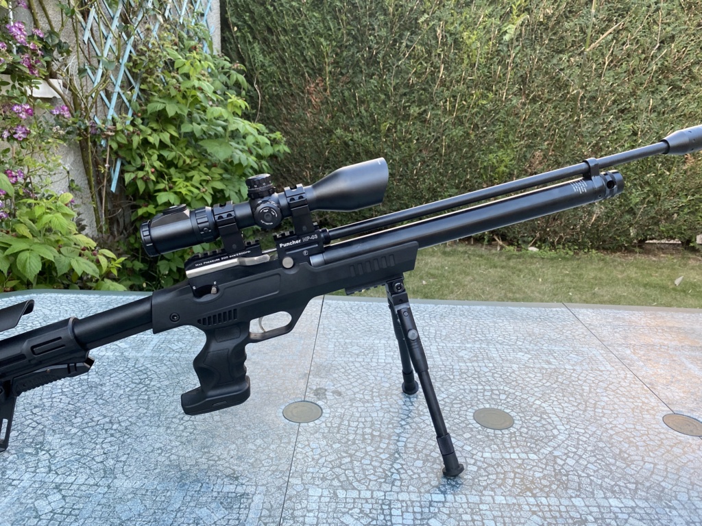

Je suis dans la même configuration, avec un cylindre plus grand de kral puncher 230cc et canon de 58cm. Changement du ressort de marteau, agrandissement des port transfert a 3,8/4mm. Je trouve également que son poids est excessif, le cout pour le changement du réservoir, est pratiquement 2/3 du prix de la np-03.
kral Merci à tous pour vos réponses cest top je vais publier une annonce avec quelques photos sur le furum vu quon est nombreux à être passionné peut-être qu

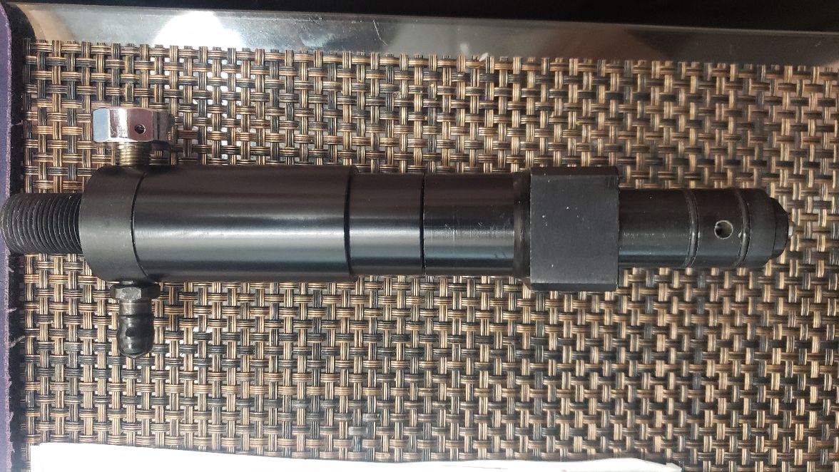

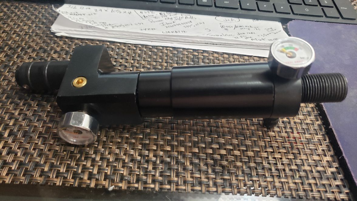

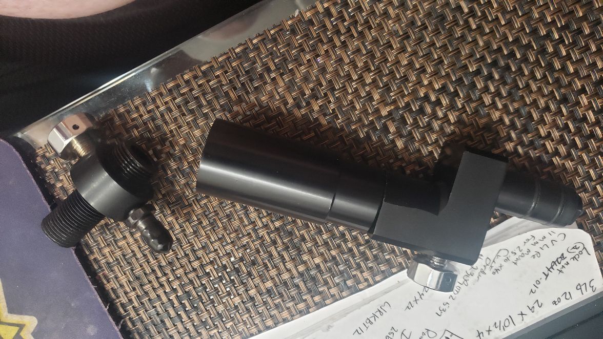

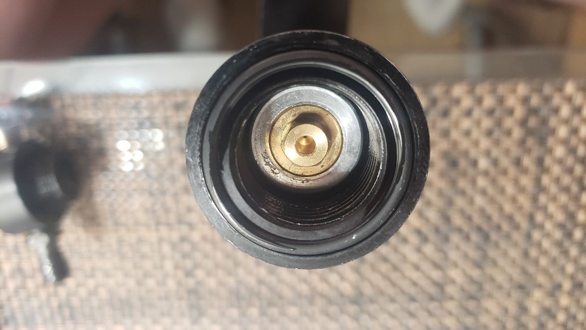

Hello I have the NP-03 I was going to convert to a bottle but got caught up in the NOTOS and converted 3 to bottles with 1 in .177- 1 in .22 and the other in .25. I had purchased a bottle adapter from an online store. Image attached. I think they are around $150.00 or so shipped. Already equipped with regulator and very easy to install. Only requires minor stock modification to install. PM me if interested.
Guill it does unscrew and reg is adjustable. Bottle end unscrews and access to regulator, Like I said I bought it to convert my NP-03 and got caught up in modding the NOTOS I never used it. See attched images. Let me know if I can be of any further help.
