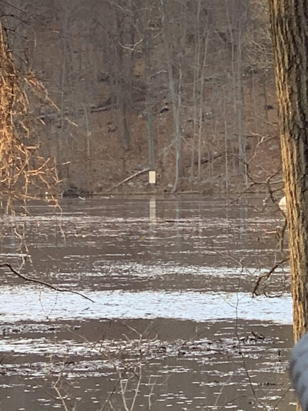

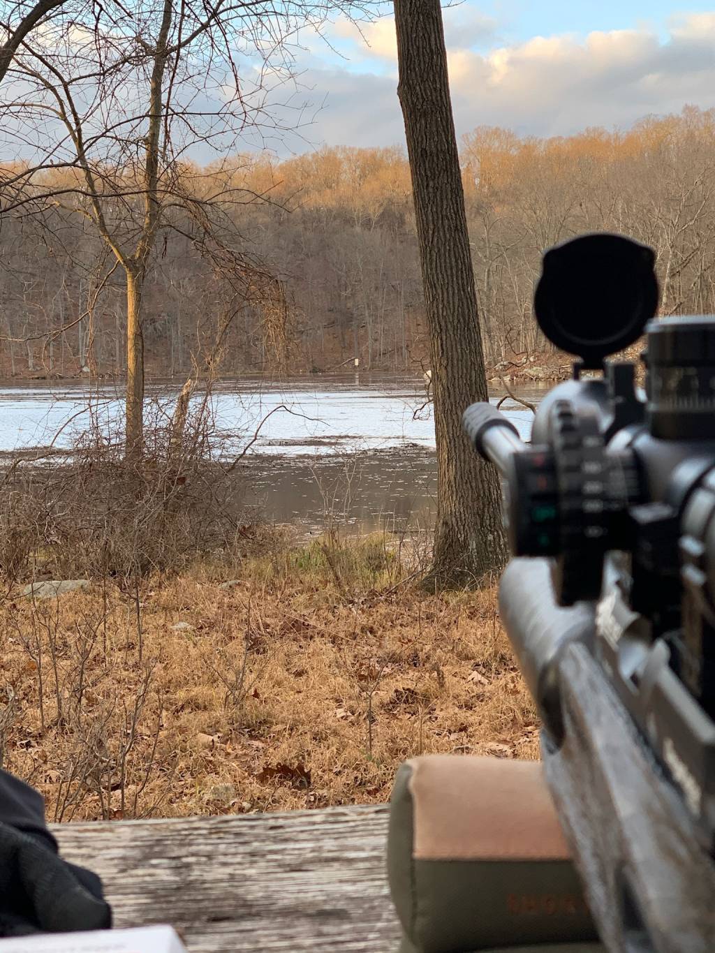

I have been shooting at 310 yards with my Daystate Safari .25 using 33.5g Nielsen slugs. Today I was able to stretch out to 350 yards.
I put a piece of wood, 2’x4’ to get sighted at that distance. Using a Hawke Sidewinder 6.5x20, I have the magnification down to 8x to shoot 310 yards. I hold over 1.5-2 mils. Stretching to 350 yards I hold over 3 mils. I can’t tell on the board where I’m hitting, but I can clearly hear the impact. I will hang a target in the next few weeks to see what kind of a group I can get.
