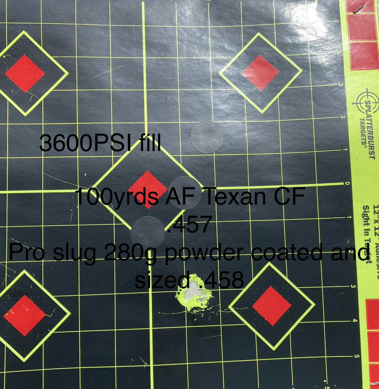

I get it... These pics are of me with the Bushbuck carbine and a coyote I shot a lasered 139yards and the target is from my AF Texan Carbine CF .457. It will do this at 100 yards everyday and I have had zero issues.
But it sounds like what your lacking is experience. Find some folks in your area that shoot big bore. Go hang out with them and get familiar first hand.I wish you well in your quest. If you get over to AZ look me up and we will go shooting. I love big bore PCP

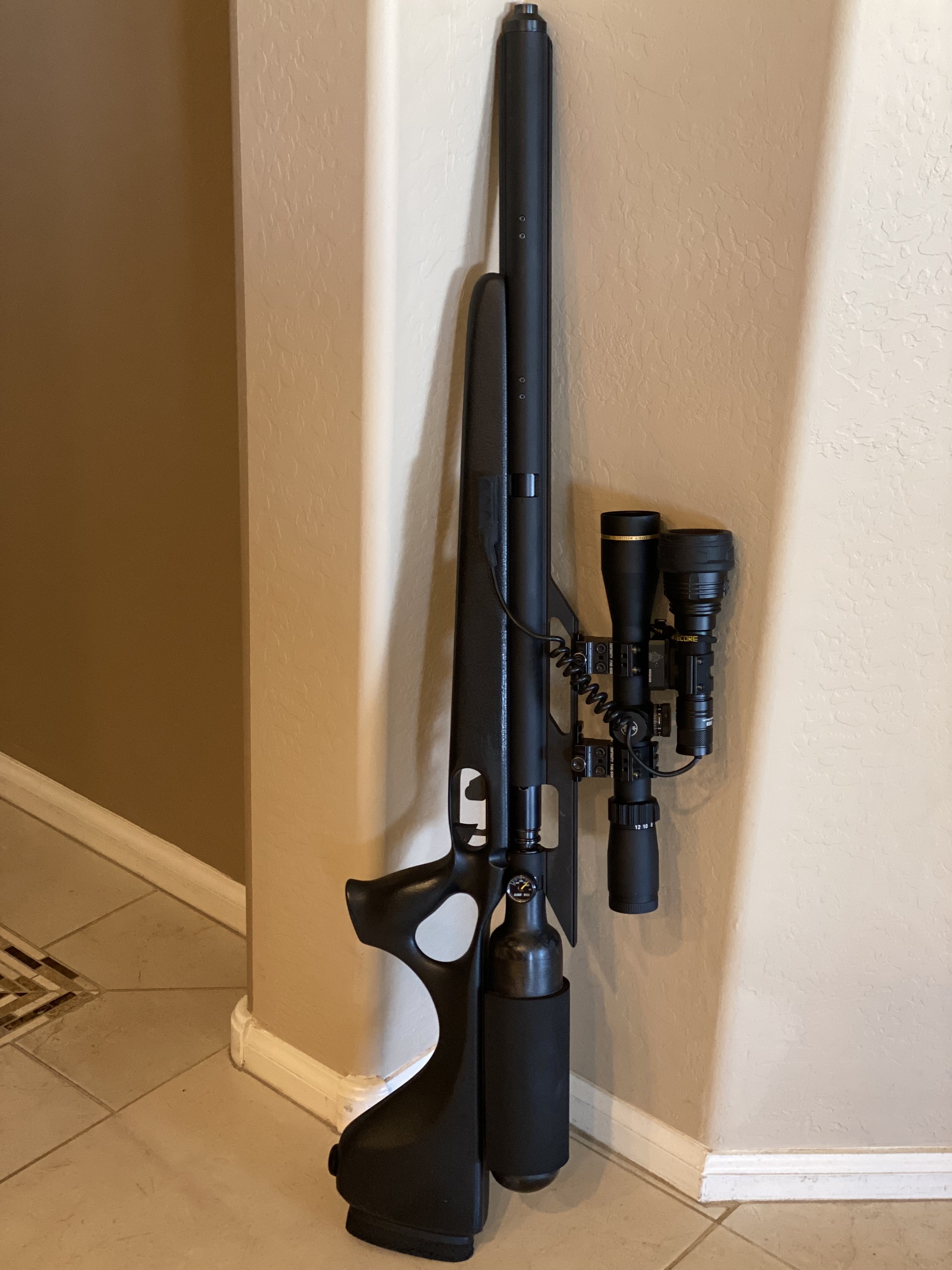

Oh and some 72cal Zeus food
And a pic of my Texan
