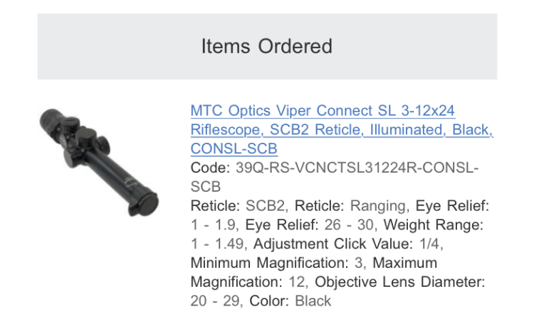

Hey, it has to be a while since anyone last comment about this post. In 2019, are there better scopes with short to zero eye relief? Also, what's the difference between the MTC Viper Connect — 32 vs 24mm?
Both are the same mate. Just a different design. Have looked through both. No difference. It’s better to get the 24 mm because you get more scope ring options with it given it’s got a tube design straight through. Other zero eye relief scope is the PRISTMATIC also by MTC. Just launched by daystate. Should be available in July. They are smaller scopes. But have the same SCB 2 reticle as the connect.

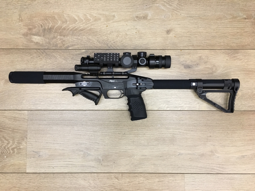

You will not be disappointed! Just remember to put your eyebrow against (or nearly so) against the rubeer eyepiece when it is extended (twist to extend/retract like on the oculairs of binoculars) and twist to have them retracted when you have (safety) glasses on or you want a little air between you and the eyepiece.

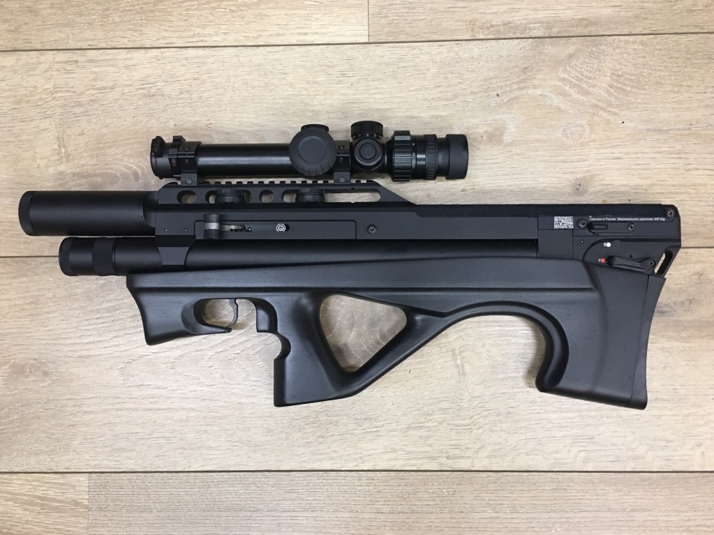

And if you get the narrow “flashlight” holder picatinny mounts with one tightening screw (they are offered on Aliexpr.) they will fit between the sidefocus/turrets and the lightswitch so you have a super stable (far apart) mounting solution:
Or you could use an Aero Precision mount, fits right in there too, very lightweight and super stable:
