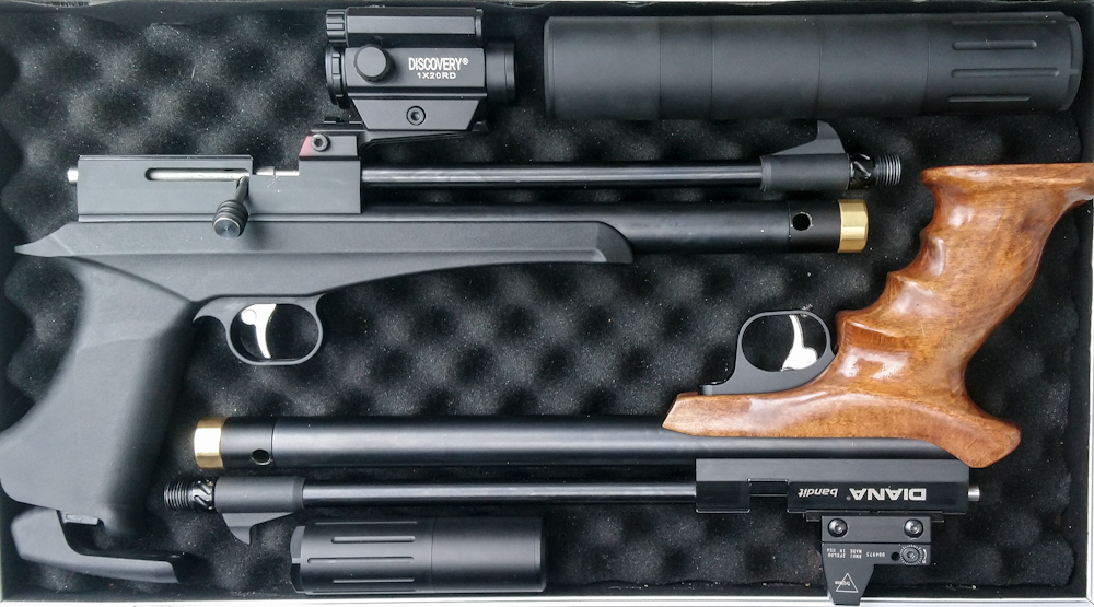

Typically those mods dont align correctly to begin with. Maybe over time it shifted? or got bumped? I'd check alignment and take a file to the spot where it seats up against the front sight post and get it leveled out. Best way it to remove the barrel, and shine a light thru it with mod attached. Make adjustements with a flat file to the plastic on the end of the sight blade until you get it level.
I've had to do it to both of mine. Technically 3 since I have a long barrel for one.
