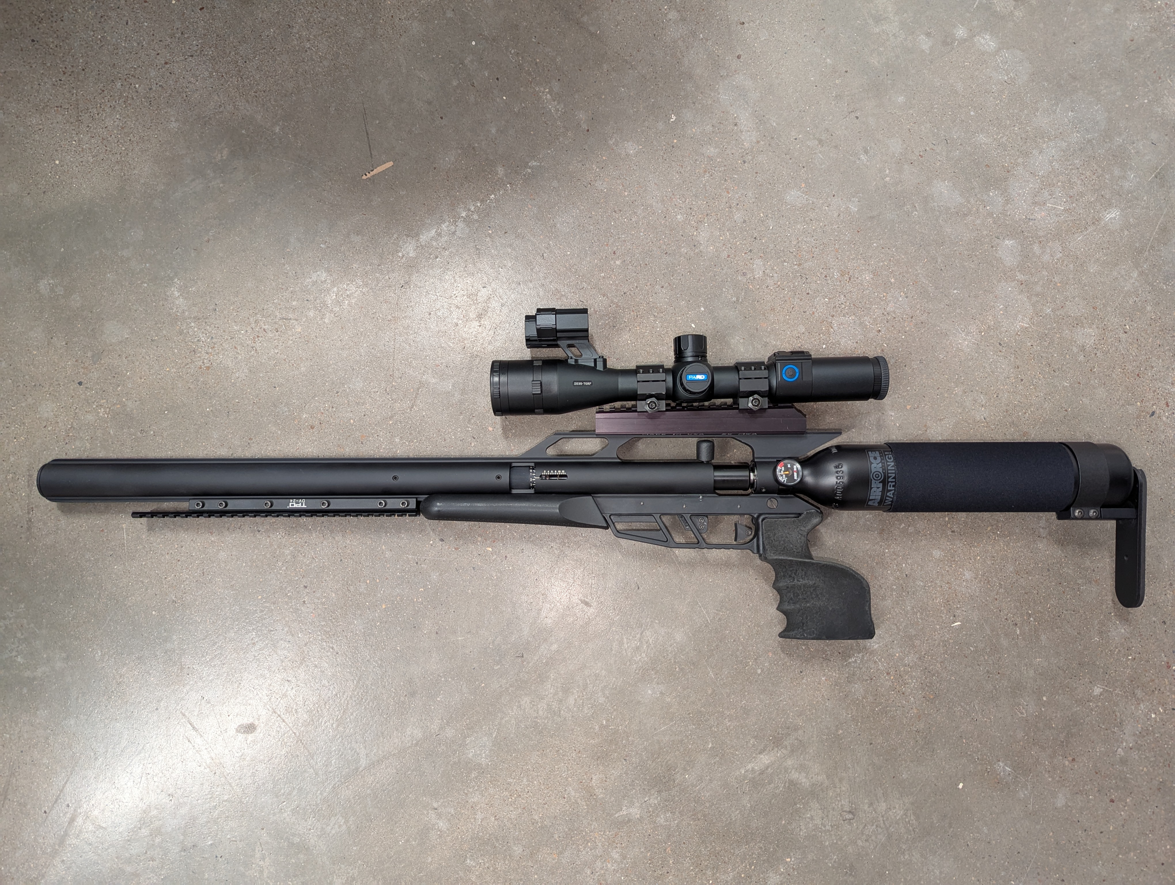

Addition of Grip
One of the first projects was to fit one of the finger-groove grips to it. This being a current gen Condor, it'll accept AR-style grips. It technically will accept flat-top style AR grips, but with some coaxing from the Dremel, I got a solid fit from a modified beaver tail finger-groove grip. Feels quite nice in the hand now.

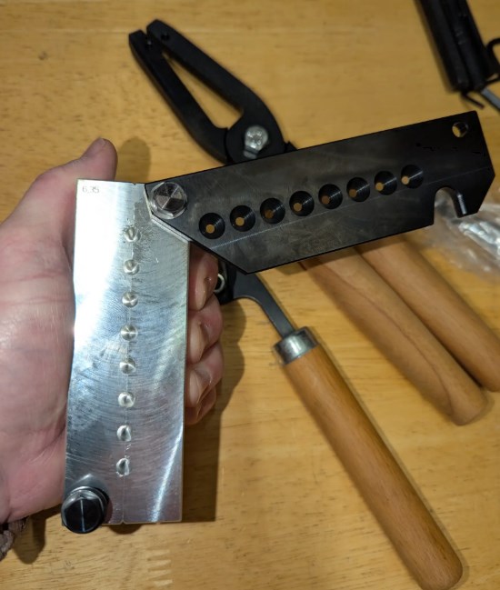

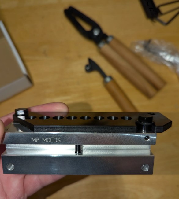

MP Mold

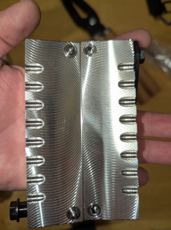

Next I needed to make some ammo for this beast. The MP mold drops slugs in the 47.6-47.8 grain range, when at the correct operating temps. Too hot and they drop at 48+ grains, and are almost impossible to chamber in the Condor SS. Too cold and they don't get proper fill-out, resulting in under-sized slugs less than 47.5grains.
Being an 8 cavity mold, this thing can really crank out high volumes of slugs in short order.

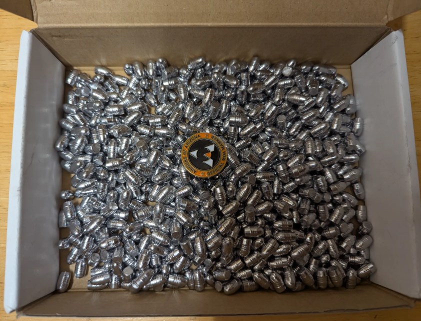

I'm still working on perfecting the slug-making process. I'd like to get to a point where I don't have to weigh-sort them. The next step in that will be another casting session with a different type of ladle. Just haven't gotten there yet.

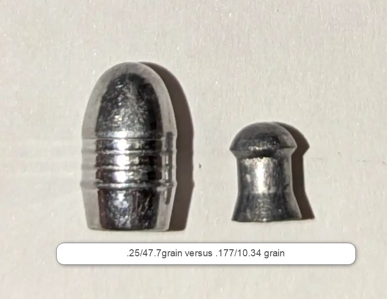

Due to the known BCs produced by slugs of similar shape, they should have a pretty high BC. Ballistics charting of trajectory has shown that to be the case, but I haven't measured an actual BC yet so will hold off on stating a specific BC for these cast slugs.
I've tried the cast MP molds slugs from the Condor SS as fast as high 800s and as slow as 570-580. They start to get use-ably accurate in the high 700s (shot cycle and shot count and precision). Best accuracy is with speeds north of 850 fps, but shot count is drastically reduced when pushing them that hard. And I just don't need or want that much fpe.
