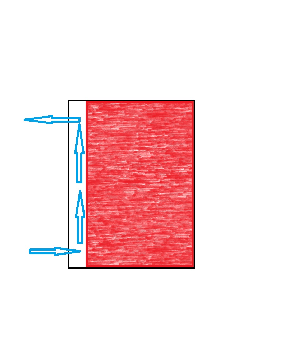

The biggest problem with yong heng cooling is that the water only travels in a straight line smaller than a pencil in one side of the second stage cylinder.
You see the temperature climb as the aluminum cylinder becomes heat soaked.
