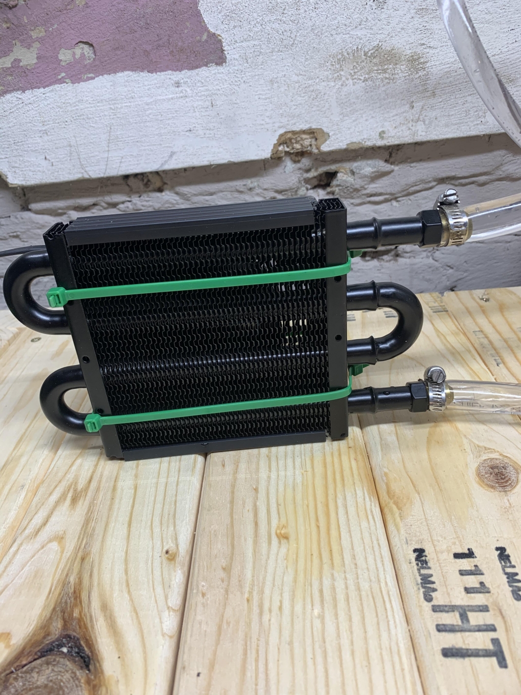

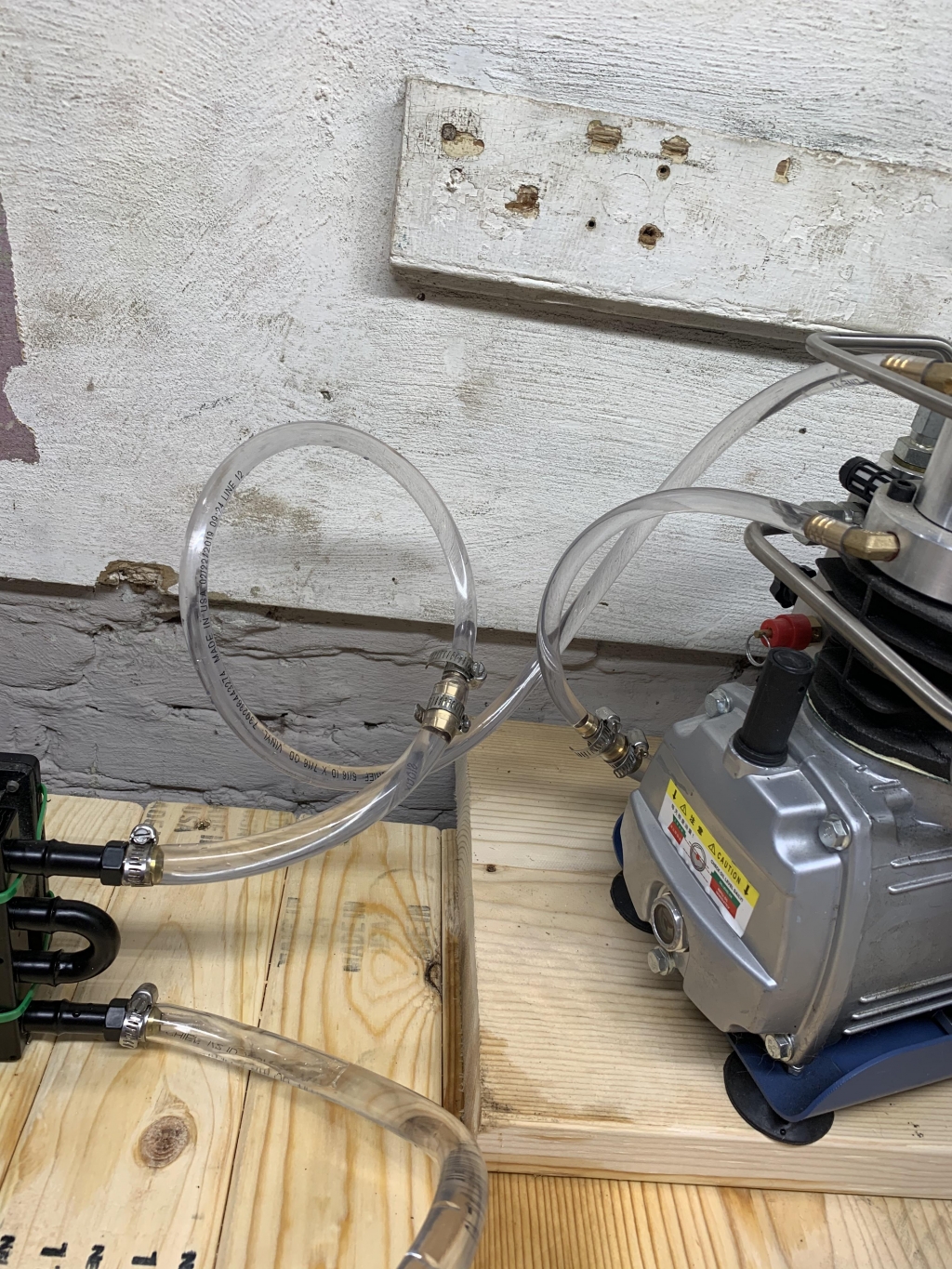

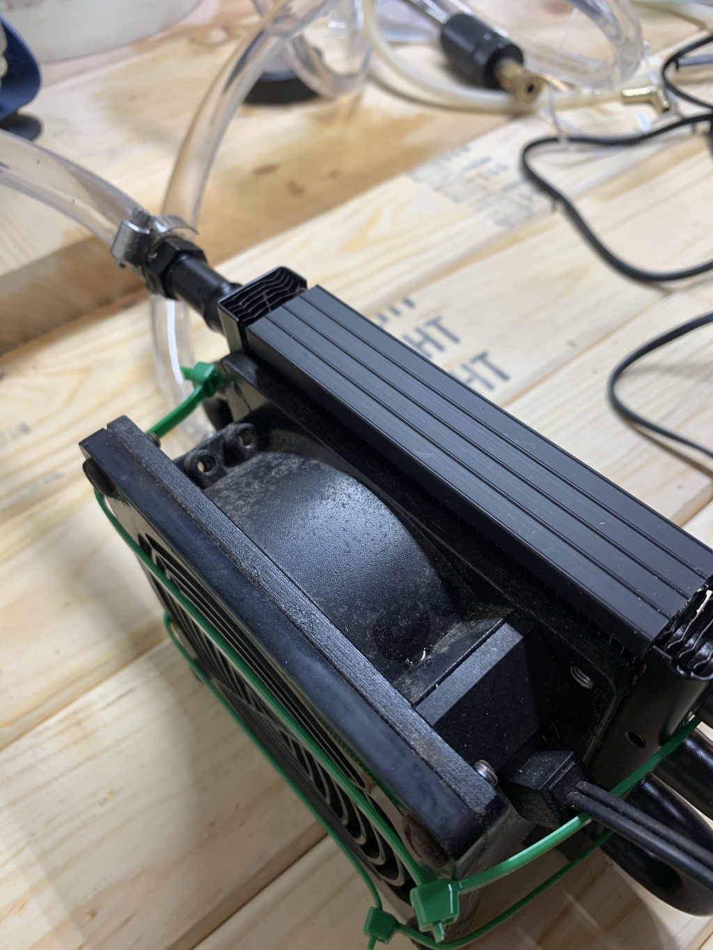

What fans and power steering cooler is it? Happen to have links, brands or part numbers? Also, what temps are you seeing and what length run times are you doing? I would love to do mine as a sealed unit like that.
thanks.

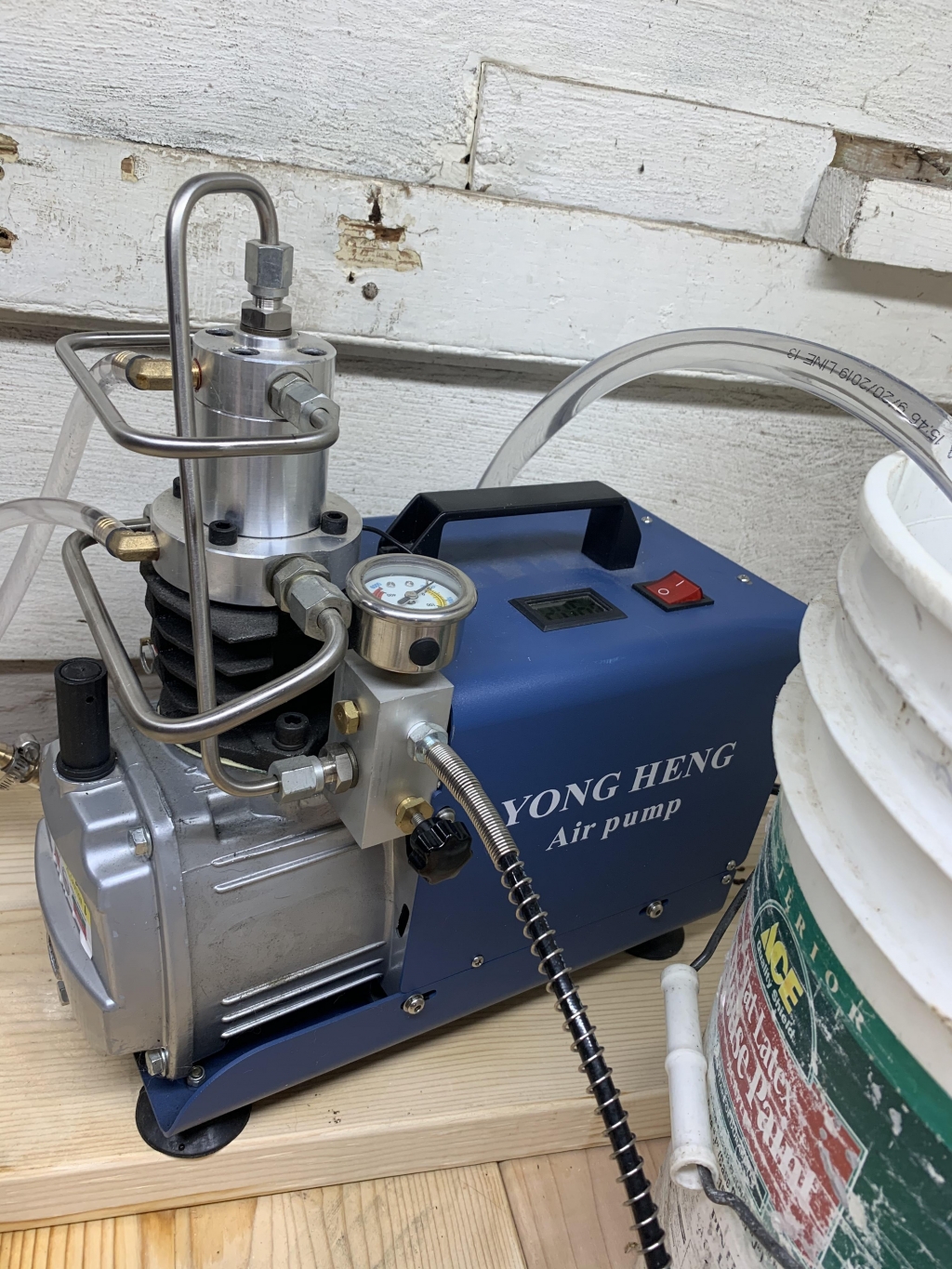

You can go on sites like JC Whitney or Summit and pick up a Derale transmission cooler. Same thing but the fan is built in to the cooler. I had that design in my head a long time ago when first looking into compressors, and thought the Yong Heng style was what I was going to go with. I’m a big fan of auxiliary cooling of transmission fluid temps on my diesel trucks so I’ve installed a few. You can even get the optional temp sender that’ll kick on the fan motor once the temps reach 160 degrees, but that’s already too hot for a pcp compressor system.
The fans are typically 10” in diameter, and if memory serves me they move approximately 350 cfm of air. The cooler in/out lines are typically 3/8” or 1/2” inside dimension.
