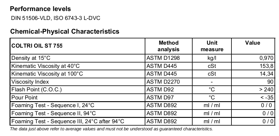

Hah! Yeah, I got no idea. Wonder why CE-750 got deprecated in favor of 755.
CE-750:
Appearance 20°C: Clear yellow liquid
Water content (ASTM D-6304): 0.03
Kin visc @ 40° C (ASTM D 445): 139.0 cST
Kin visc @ 100° C (ASTM D 445): 13.0 cST
Viscosity index (ASTM D 2270): 84
Total acid number (ASTM D-664): 0.12 mg KOH / g
Temperature minimum operating (ambient): -15° C
ST-755
