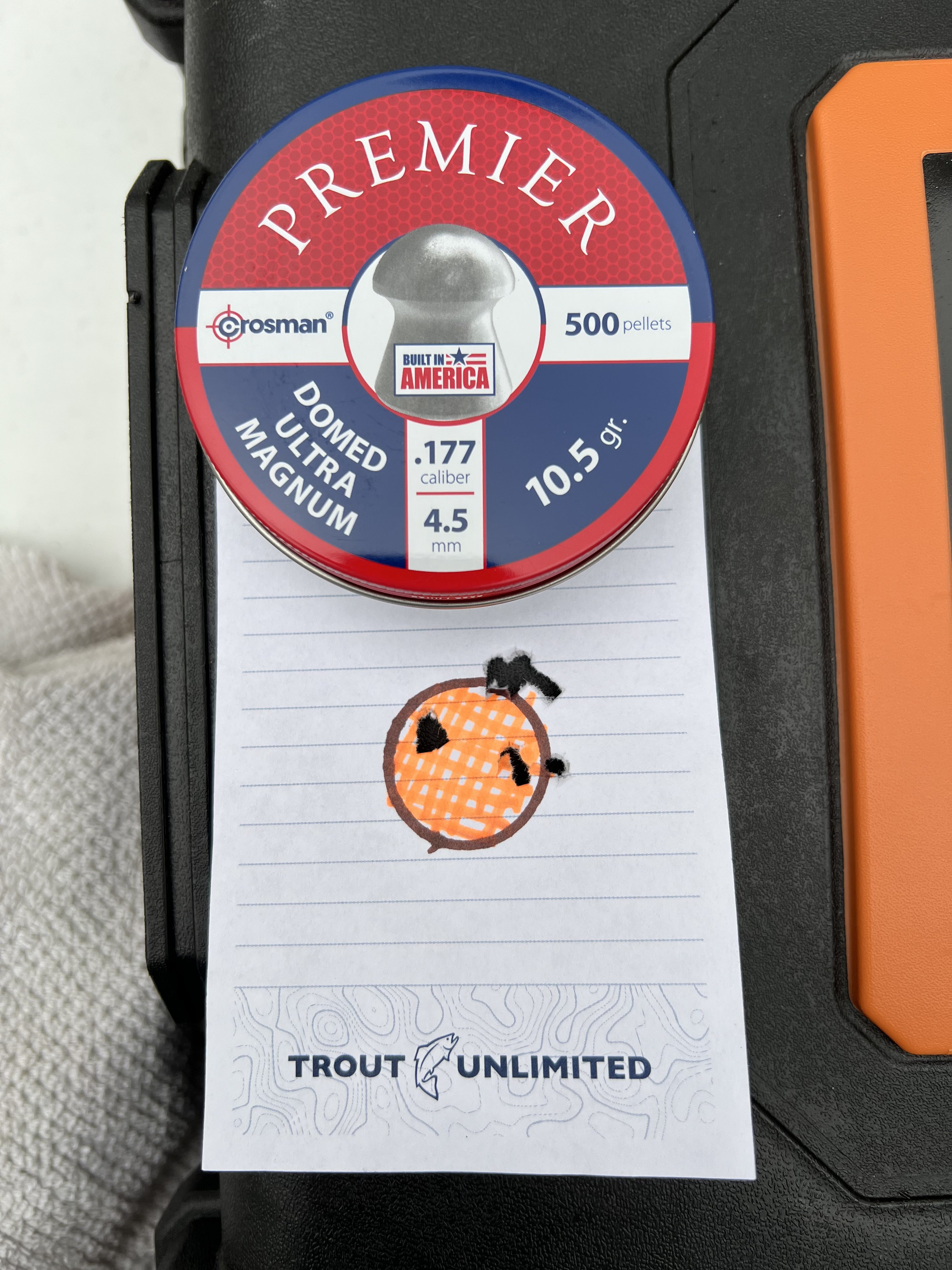

All - brand new here - wanting to get into the PCP game but don’t have a fortune to spend (that was done in fly fishing …). Looking for an all around hunter/shooter in a bullpup configuration - I am considering the Air Venturi Avenger BP in .22 cal, though I’m not enamored with the high scope rail. 30 year Army vet - never shot less than an expert score using M-16A1, M-16A2, M-4, and M-9. Only saying they because my standards for accuracy and dependability are high. Any advise, personal experience, or suggestions will be most welcome. I currently shoot a Gamo break barrel 10 shot mag toy in .177 with a UTC Bug Buster but am not impressed. Looking forward to sharing info, experience, and tighter groups!

If you shot that group with Crosman pellets from a Gamo rifle, then hold your head high my friend.
That is a dead squirrel with each pellet, and that ain't nothing to shake your head at.
