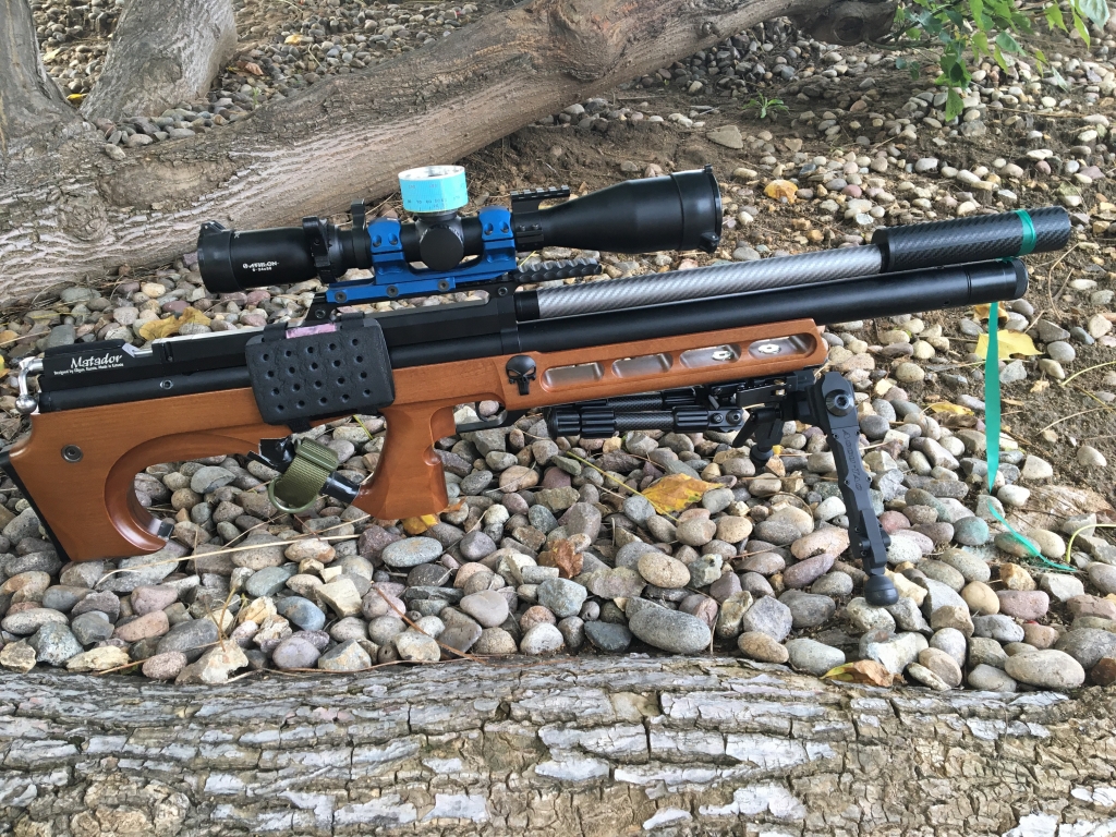

I agree with Ed. Too many times shooters have too high of an expectation, since all they see posted online are the “magic” groups, that best group of 25 that were shot that day. Nothing wrong with that, it’s fun to see. But it’s not the normal group size. Take a look at this that I shot yesterday. 110 yards, EBR size target, 8 ring 2 inches, 9 ring 1.25 inches. .22 EDGun R3 Long with RD Monsters at 960 FPS. Shooting for score, not group size.
