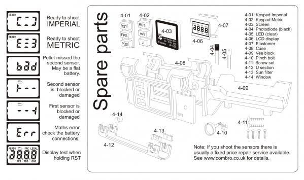

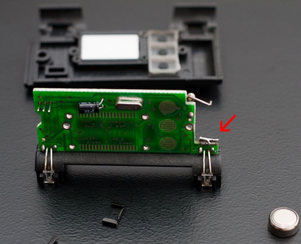

There are four IR LEDs (2 emitters and 2 detectors facing each other) . Check it they are misaligned, loose mount., or missing the lens cover "window". Also there may be a loose wire. Took these photos off the internet posted by others who had those issues. Look at parts 4-05 4-04 (LEDs) and parts 4-14 and 4-13.
