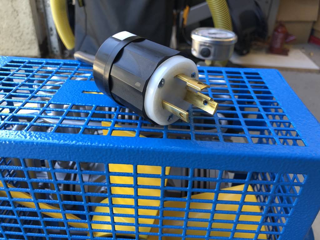

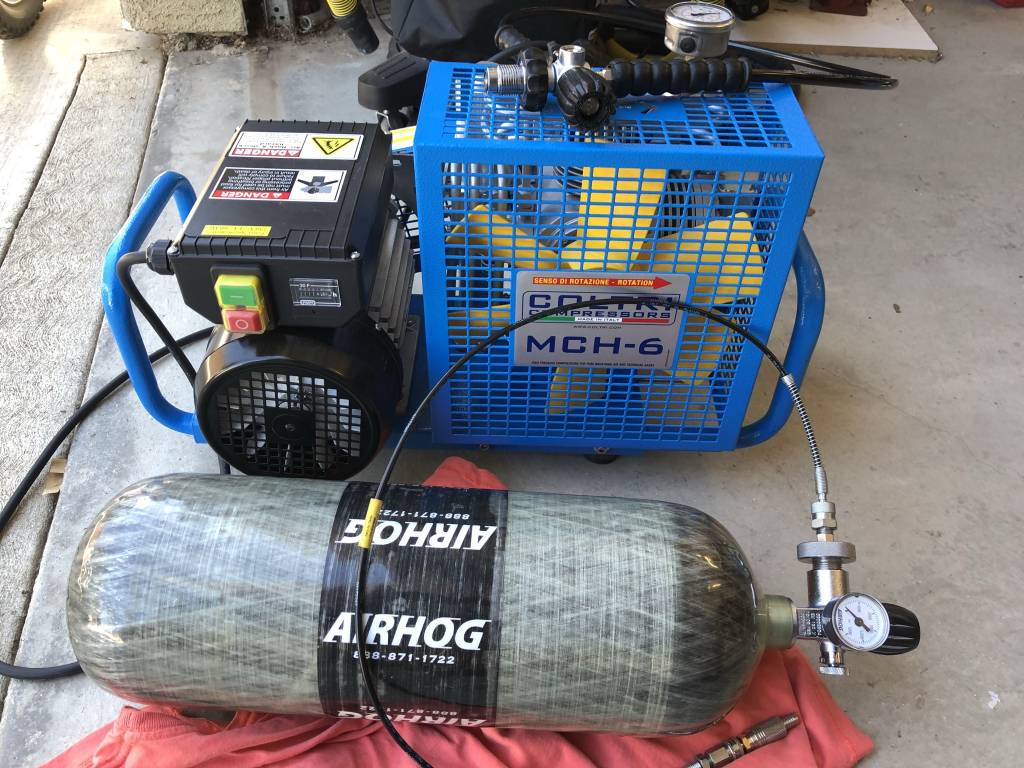

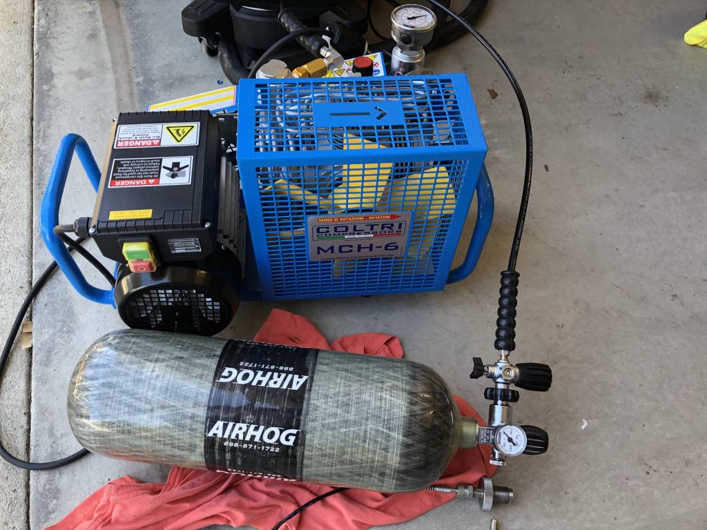

Her is my Coltri MCH-6 220 Volt setup it may help you
that is the 88 cubic feet tank with the DIN fill hose

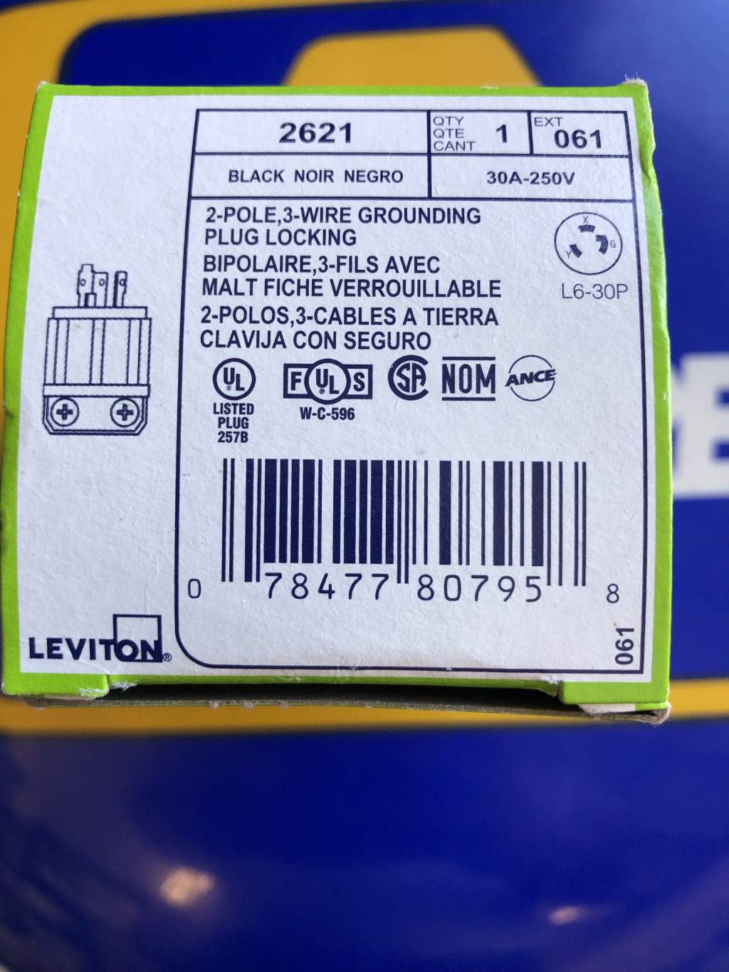

The plug is a 30 Amp 3 prong locking

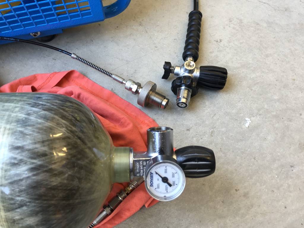

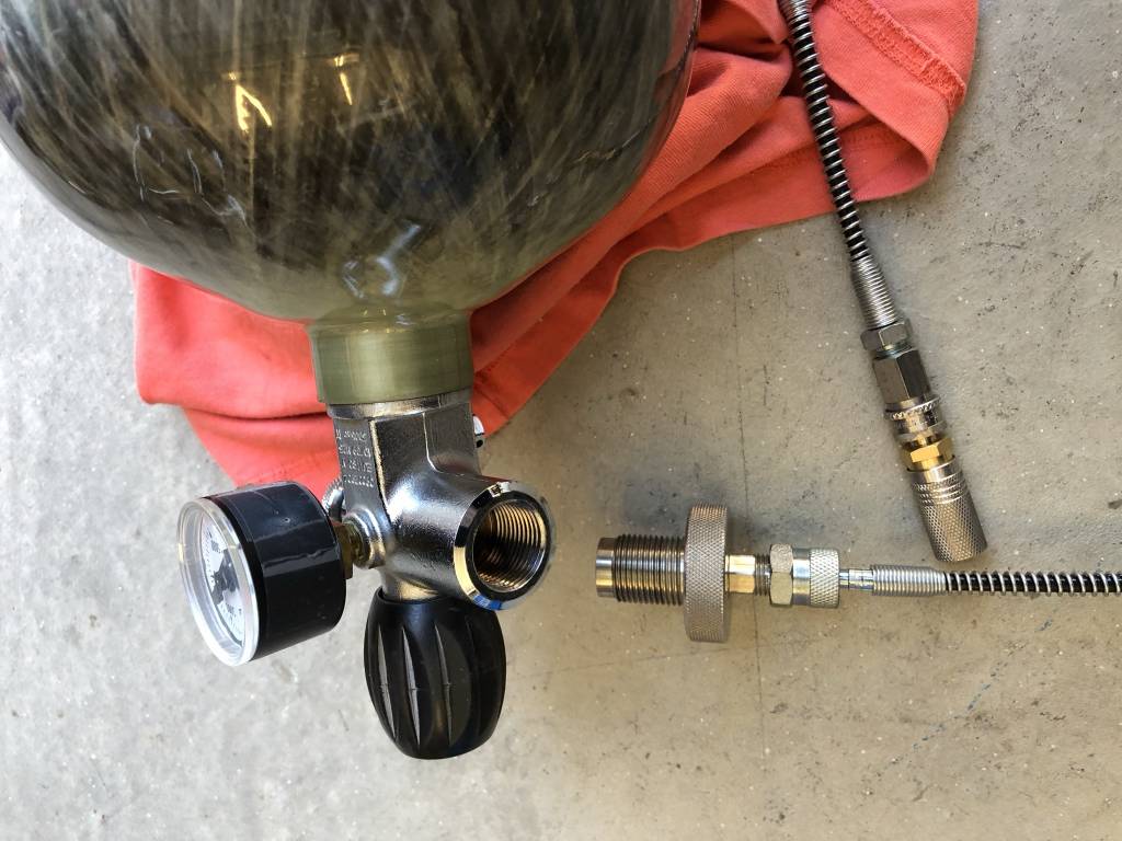

Isn’t it inconvenient to remove the fill hose from the tank?. And is there any advantage?. Thanks for the pictures, they help.
The advantage of a DIN300 is that it is a more secure connection to a DIN300 female threaded tank compared to using a foster quick connect on the hose. A female foster quick connect on the end of the compressor fill hose requires the tank to have a DIN300 to male foster connector on the tank to complete the connection. The vibration of the compressor during fills will eventually develop a leak inside the female foster from o-ring wear. The threaded DIN300 connection is unaffected by vibration. So it is less costly if your tank has a DIN300 female connection, more secure, and is easily attached to the tank without tools.
