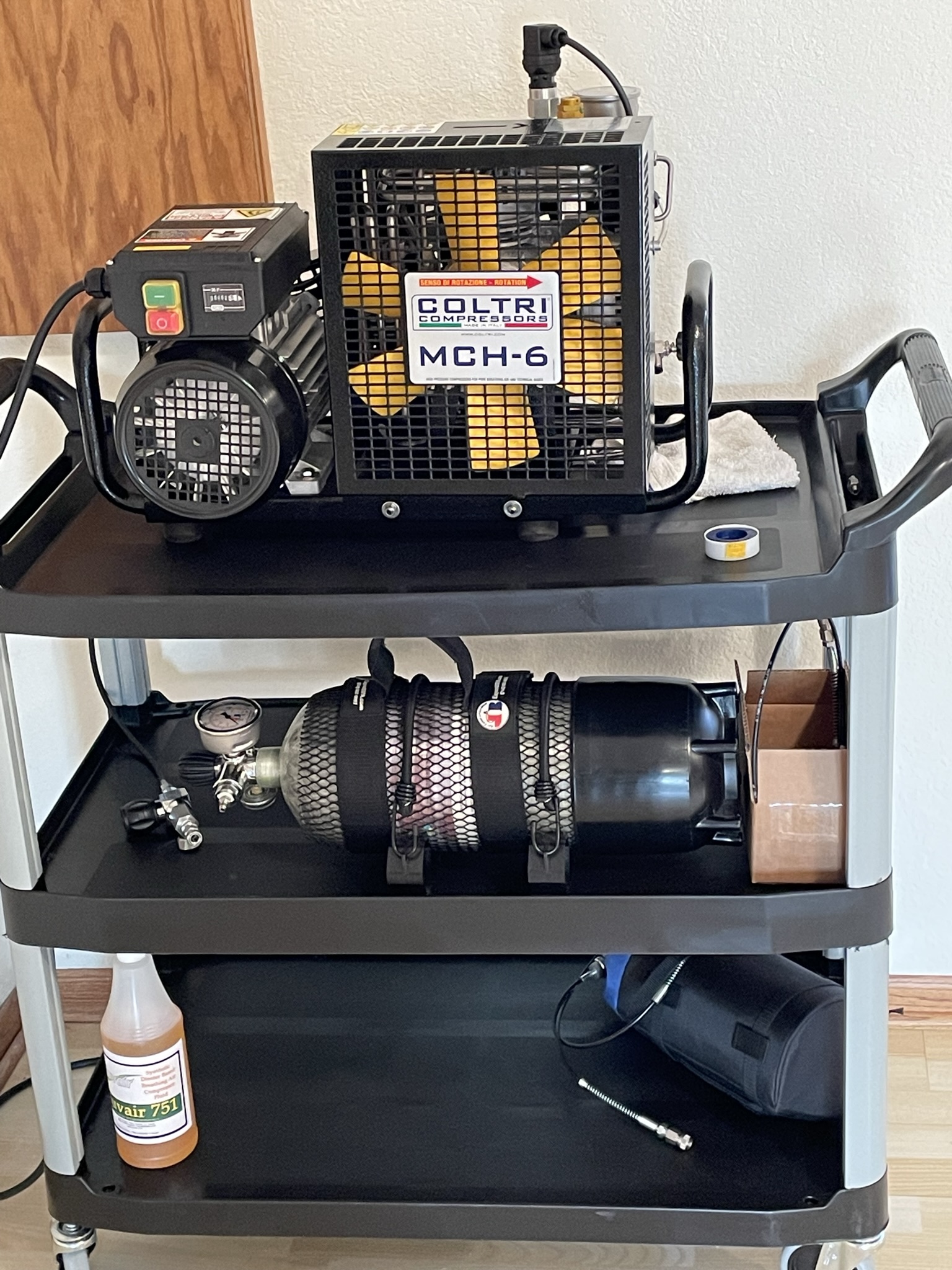

- I want to make a small cart to set the compressor on so it's at a better work height and easy to push out of the way. When it runs does it have a tendency to want to vibrate around the surface it is resting on or does it stay where its put? Great minds think alike. I installed my plug close to the panel. I just ordered a 24" x 18" plastic cart off Amazon along with a generator cover. I can then wheel my cart over to the plug when using it, and over by the work bench when I need to work on it. Cover will keep it clean, and I will build a tank holder onto the cart to hang my bottle.

I grabbed a cheap grill cover and used a cart I got from harbor freight I can fill with the din300 to scba with an adapter which works all right also have foster fitting adapter it seems like it causes a little more heat fill with the whip I have one 30 min tank that I filled from empty to 4500 and it seemed a little warmer than the others I was thinking about also putting hoses on my drains so it doesn't spray all over the cart you do get a little oil it isnt much as far as moisture if your just topping off but you do get a good amount filling from empty

My father modified a large harbor freight rolling cart by adding some planks to the middle. The icon fits perfect with nothing sticking out. I’m going to measure my icon since I think it’s dimensions may be different from the standard mch 6, though I’m not sure. Then I’ll find a cover that matches.
i got a chance to wire my Coltri yesterday (monday) i purchased the 15ft 10 gauge 3 wire cord from home -d , got the female & male ends from industrial power & used a 30 Amp double pole Breaker, hooked it up ,opened the drain valve , & ran it for 5 minutes , hooked up my great white, & topped it off in nothing flat (really quick) didn't think about using a timer ( was watching & listening to it run ) btw i set it on an old rubber tired cart that i purchased at a car show yrs ago to haul my speed parts i purchased , works great ,i am very happy that i have the Coltri..
