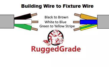

The color code on the wiring has me confused, I shot this pic to Craig at Nuvair, not sure which two are hot.
