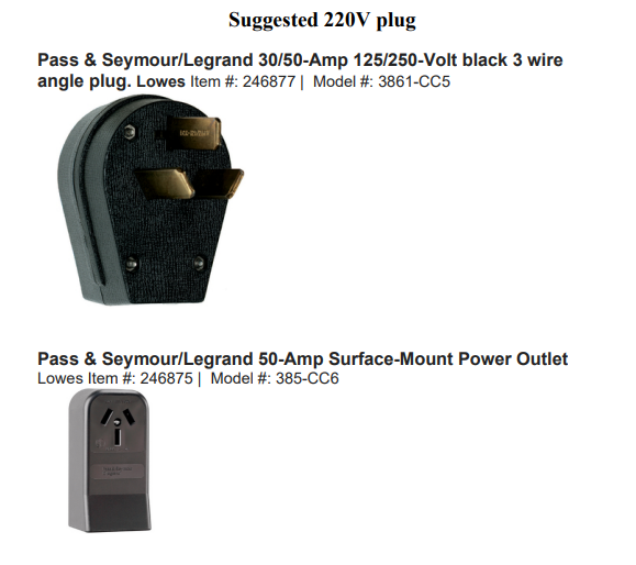

You could run from an electric clothes dryer outlet if you have one, and it’s convenient. Just a quick way to get up and running if you can’t install a new circuit yourself, or are waiting for your electrician.
That's what I do. My wife just LOVES it when I hijack the laundry room to fill my tanks. Lol. God bless an understanding and patient spouse.

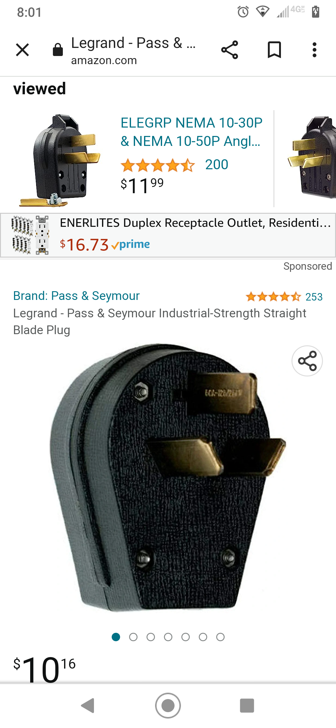

If you go the dryer plug route, check your receptacle and get a compatible plug from the hardware store. It's easy. On the "Alkins owner" thread, there are multiple posts where guys chip in and show how to wire on a 220 plug.
You will need a 30 amp 2 pole breaker and a 30 amp outlet and plug using 10 gauge wire. The 230v Coltri motor is listed at 17 amps and code says you can't exceed 80% of the breakers capacity. 80% of A 20 amp breaker would be 16 amps. Make sure you have room in your breaker box for a 2 pole breaker. I just topped off my Great White from 3400 to 4500 in 5 minutes.
So I already have a 30amp 2 pole breaker in my Panel. It's been inactive for years (It was an electric water heater-I've converted to N Gas)
Coltri says I need a 35amp. I'm tempted to just use the 30 amp. Then all I need to do is buy a receptacle and a plug and wire them up.
Do I need the 35 amp? When I asked Craig , he told me it would only be for the high draw at start up.
Mine is on a 30 amp. I would like to hear what others say. Eaton compressor has a chart showing what size breaker is needed for compressor motor HP and they say 30 amp for a 3 HP. You can always replace the 30 with 35 if you want. The 10 gauge wire on the 30 is plenty for a 35. Do not start it under a load. I let mine come up to almost the tank pressure before I open the tank valve. This also give the desiccant time to absorb the moisture.
Plug I put on mine is this
