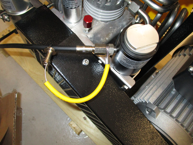

First the "safety" wire on the fill hose, why???

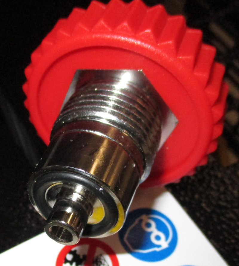

Next the extension on the DIN300 fill fitting, why???
I have never seen it before and none of my 7 300bar bottles accomodate it!
After turning it down it was as i feared, the flat part is so wide that it wont hardly fit in a DIN200 bottle, again why?
Are they so scared of you lot that every little bit has to be 100% lawyer proof?

I think it might be a "anti whip around" safety feature in case of a leak in the hose or the end coming loose.
A loose fire hose with the heavy nozzle at the end can whip around and easy cave in a human skull if it hit you, i am sure a high pressure smaller hose are also painful if it get loose and hit you.
Bigger scale.
https://youtu.be/ViXvWd9VpjA
PS. Once during a fire drill on the lower car deck on the ferry i worked on a fire hose got loose and performed the METHed up snake dance, in that one instance i dove in head first and secured it, but really the right thing is to run and stop the pump or close the valve in the other end.
Reactions: Chickenthief
I think it might be a "anti whip around" safety feature in case of a leak in the hose or the fill end coming loose.
Bigger scale.
But 1½" from the outlet on a 26" "whip" ?
Makes no sense?
Ahhhh now the penny dropped!
If it rips of the compressor and then the bottle will whip the snippet around violently with a full belly of air!
Dang Coltri upped their safety game :)
Chickenthief “Next the extension on the DIN300 fill fitting, why???”
Thats a DIN 300 fitting, designed to prevent overfilling of 232 BAR tanks. An explanation of the different fittings, with helpful photos, can be found here-
http://www.nigelhewitt.co.uk/diving/din.html
I know that but the small tube in the middle i have never seen before and as i said it wont fit any of my 7 DIN300 bottles
