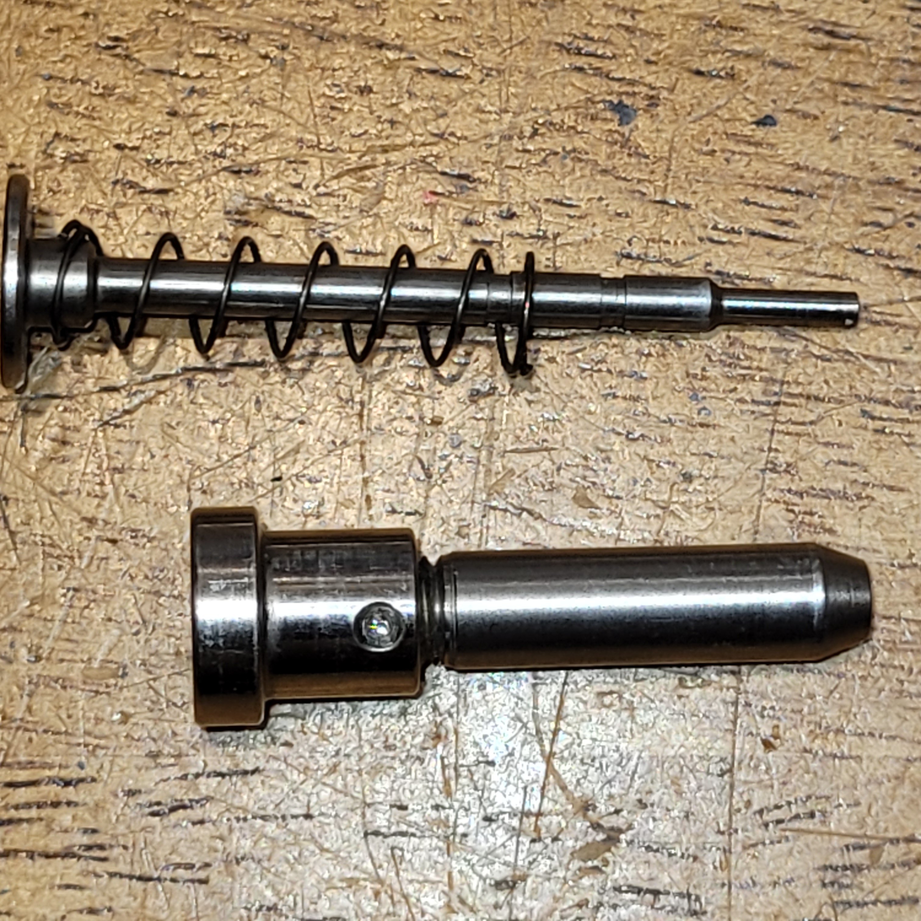

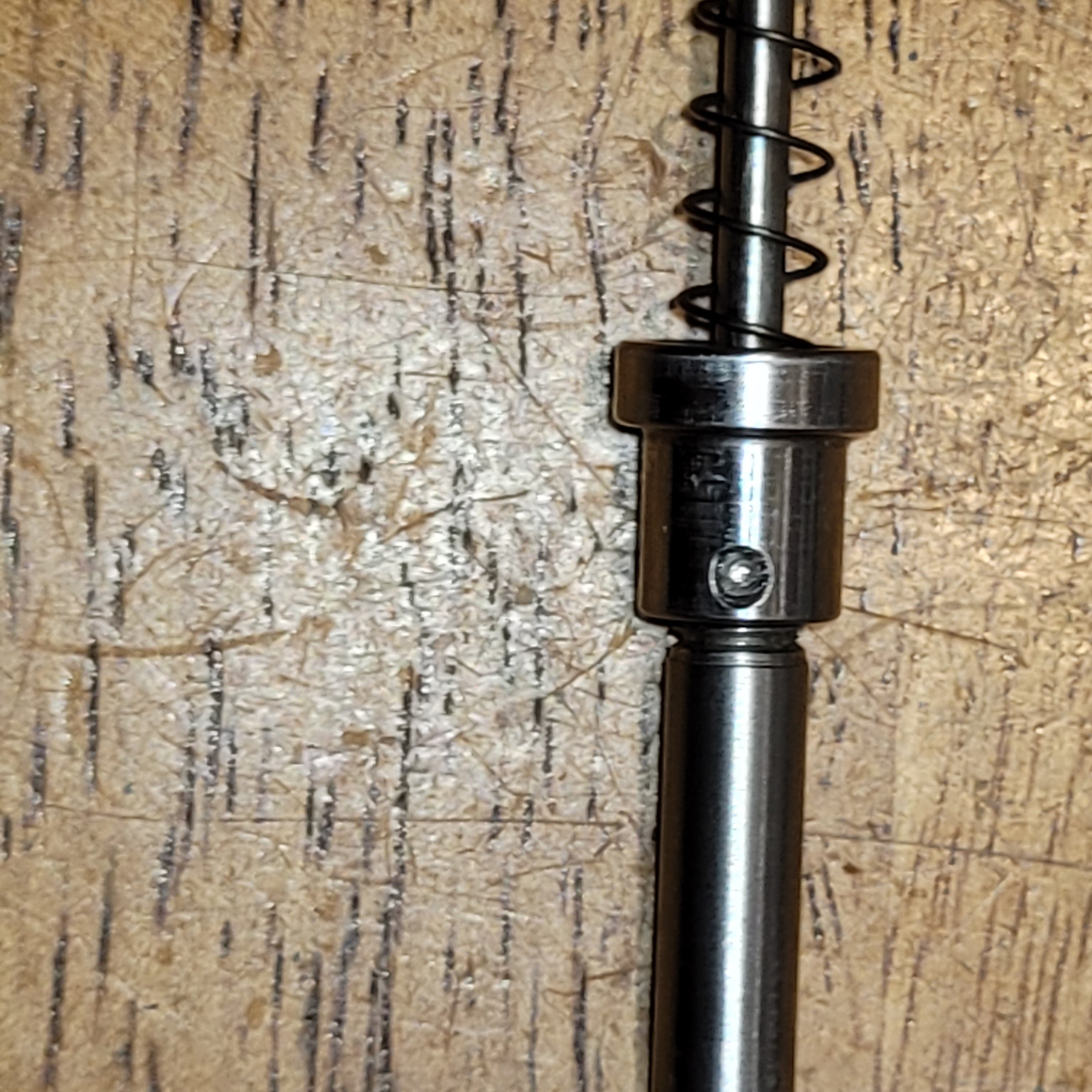

When you close the side lever does the outer probe snap in, you should be able to hear it. I believe he is talking about the outer bullet probe, not the inner thin probe. See the threads on the bullet probe and the set screw, you'll need to loosen that screw and slightly unscrew the bullet probe to make it LONGER so it snaps into the breech when closing the lever. May need to add more blue loctite for that small grub screw again.
