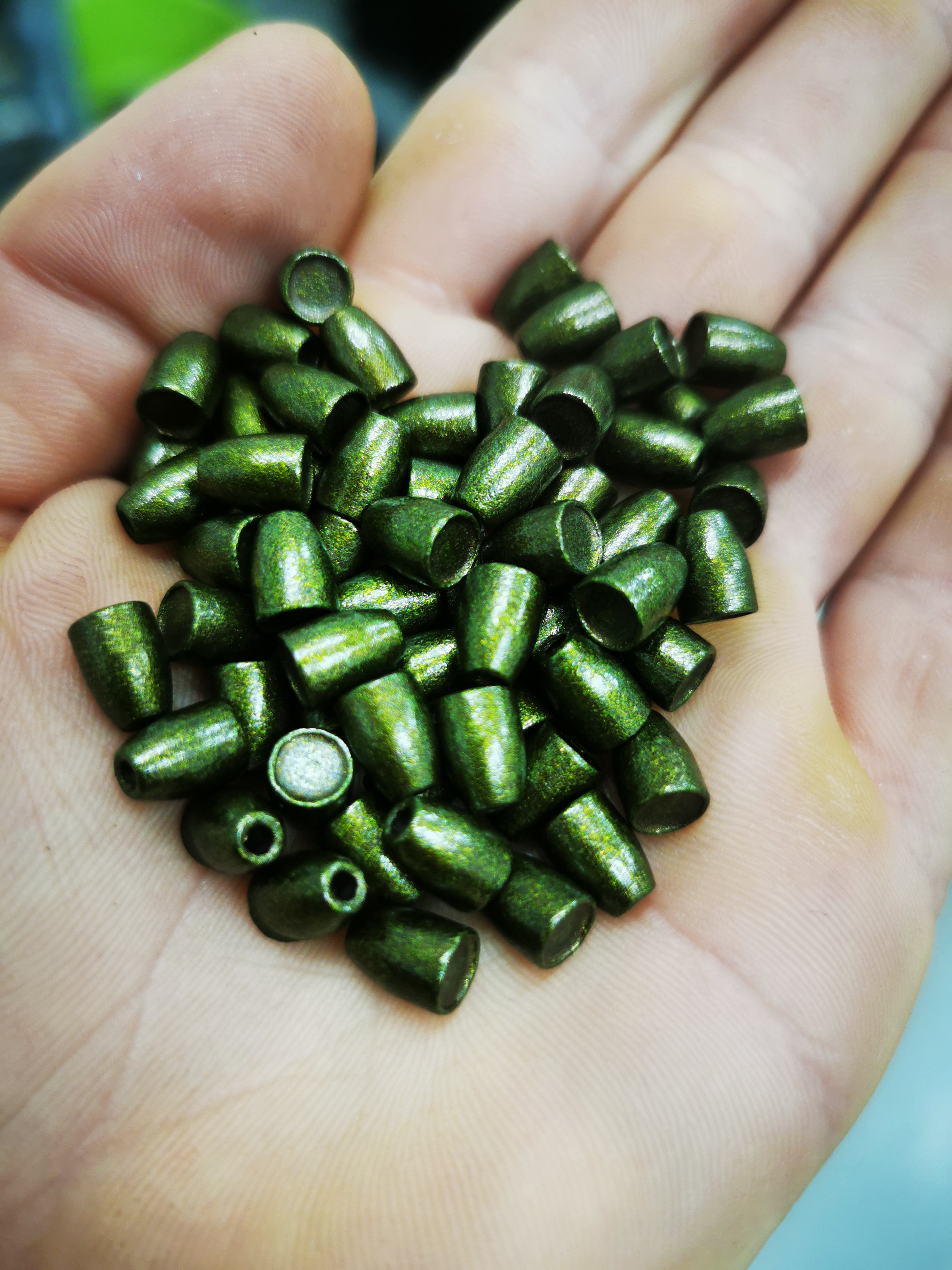

If you look at the photo above you can tell the viscosity was way to thick. How can I tell? Easy! the base of the slugs with a indent in the base should not have any coating.
None of mind do. The process is you put the slugs, bullets ect in a plastic bowl. I use a ole gal plastic polypropylene ice cream container as Blue Bell ice cream comes in.
I put my bullets in & only put a very small amount of the acetone mix into the bowl. Then I shake it around & side to side for about 15 sec or so. You can tell well it is enough
for the bullets will not slide as free in the bowl. I then pour the bullets out on cardboard or news paper for about 5 to 10 minutes to completely dry. The bowl & bullet are never
wet when I dump them. Acetone evaporates very fast & as little as I put in, "nothing". The first time the bullets are hardly coated. Then I do it all over one more time. Done! I use
to measure how much mixture I put in the bowl but I have done so many I just know from doing it. I use a plastic squeeze bottle like ketchup use to come in. I would guess
maybe 8 to 10 drops is all for a 100 25 cal slugs. Hope this help anyone thinking of trying this. Oh ya I do this out side of my shop not in side because of the vapors. But the little I
use in that environment is not bad. But I should wear respirator. I have a good one for my paint booth, maybe you got me to thinking right for now. (WINK) Fly
