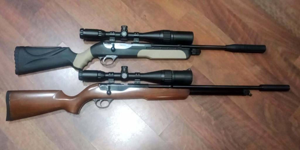

It had already been done, more or less, even before the Fusion 1 came out, in the form of a Flying Dragon XS60C PCP. It had a serious safety issue, something about wrong thread or air tube size.
Here are My Fusion 1 and XS60C in .177. Both shoot pretty good.
