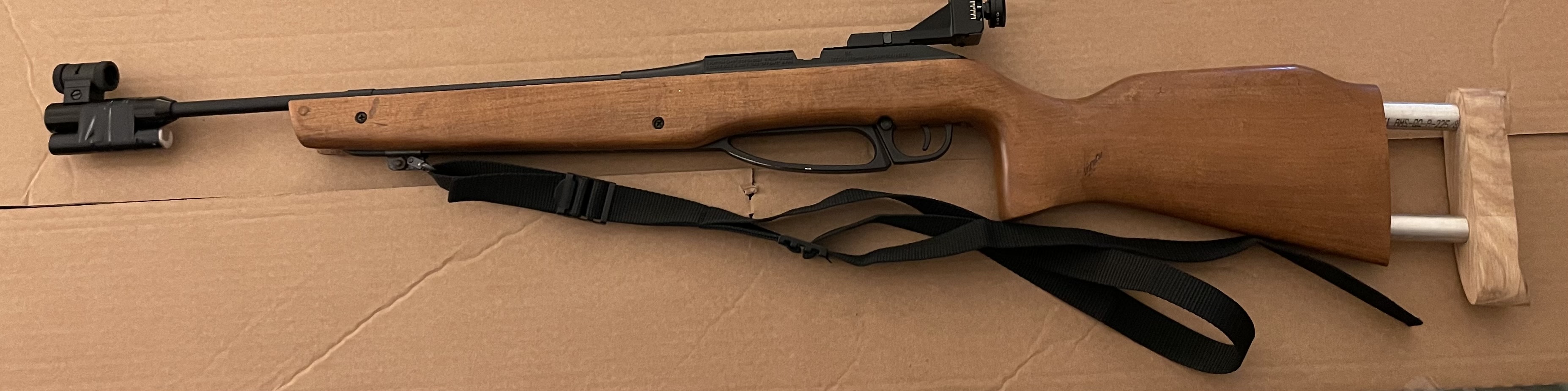

I received my referb 853 a little while back. I replaced the stock sights with the Daisy Match versions and added an adjustable iris. On the front, I swapped in the 753 barrel weight and globe.
I currently only have about 7m worth of practice space and here’s after a few rounds offhand just using RES Hobby Wadcutters. It’s certainly not Olympic level but not bad for a $150 rifle. I’m sure a better shooter would have them all in the center. This was 10 shots.
I need to fab up an extension for the buttstock. Even with the three extension, it feels a tad short to me. I also need to clean up the trigger - this one didn’t come with the trigger job and it’s pulling about 4 1/2lbs
Very nice. This is a great indoor 10m gun. I had the same issue of the short stock. Needed up making custom extension out of a block of cherry I had in the shop. Turned out ok and functional, but doesn’t look as nice as I wanted.
Also did the trigger job. Not too bad, but as mentioned these are a pain to reassemble. You really need three hands to do it.

I have a 753S, and after doing a trigger job, it's a great shooter. Mine needs a bit more weight up front as well. Probably fire up the lathe and turn a steel weight then face the back of the existing weight off square so they blend together. Great guns for the money.
I should probably face mine off on the large as well. I just wanted to see if the additional weight would help. It seems to, but I really need to do the trigger job. Might try that today.
Reactions: Frogy
Completed the trigger mod today. The only tricky bits are getting the safety ball bearing in when swapping trigger housings (I ordered the newer style that’s pre drilled) and then getting the sear spring tucked in when putting the housing back together. I realized when I took it apart, who ever did the reverb neglected to put the screw/spacer back in behind the trigger guard. So it’s only been held in the stock by the front screw.
Thankfully, I had ordered the extra screw kit, as it comes with those. Wondering if anyone knows the size? I had originally wanted to use that screw for my sear adjustment - it’s not machine threaded, and appears to be a #6 sheet metal pitch and size (which is what I ended up using for the sear adjustment)
853 from the CMP is the best deal in the airgun world at the moment. If youre on the fence, pick one up! I shoot in the basement and garage nearly every day with mine.
I’ve been shooting mine every day as well. I’m pretty decent at 10m but still struggling a little bit to keep it in the 9/10. I need to finish carving the buttstock extension I made for it. It’s a completely different shooter now that I did the trigger mod.
