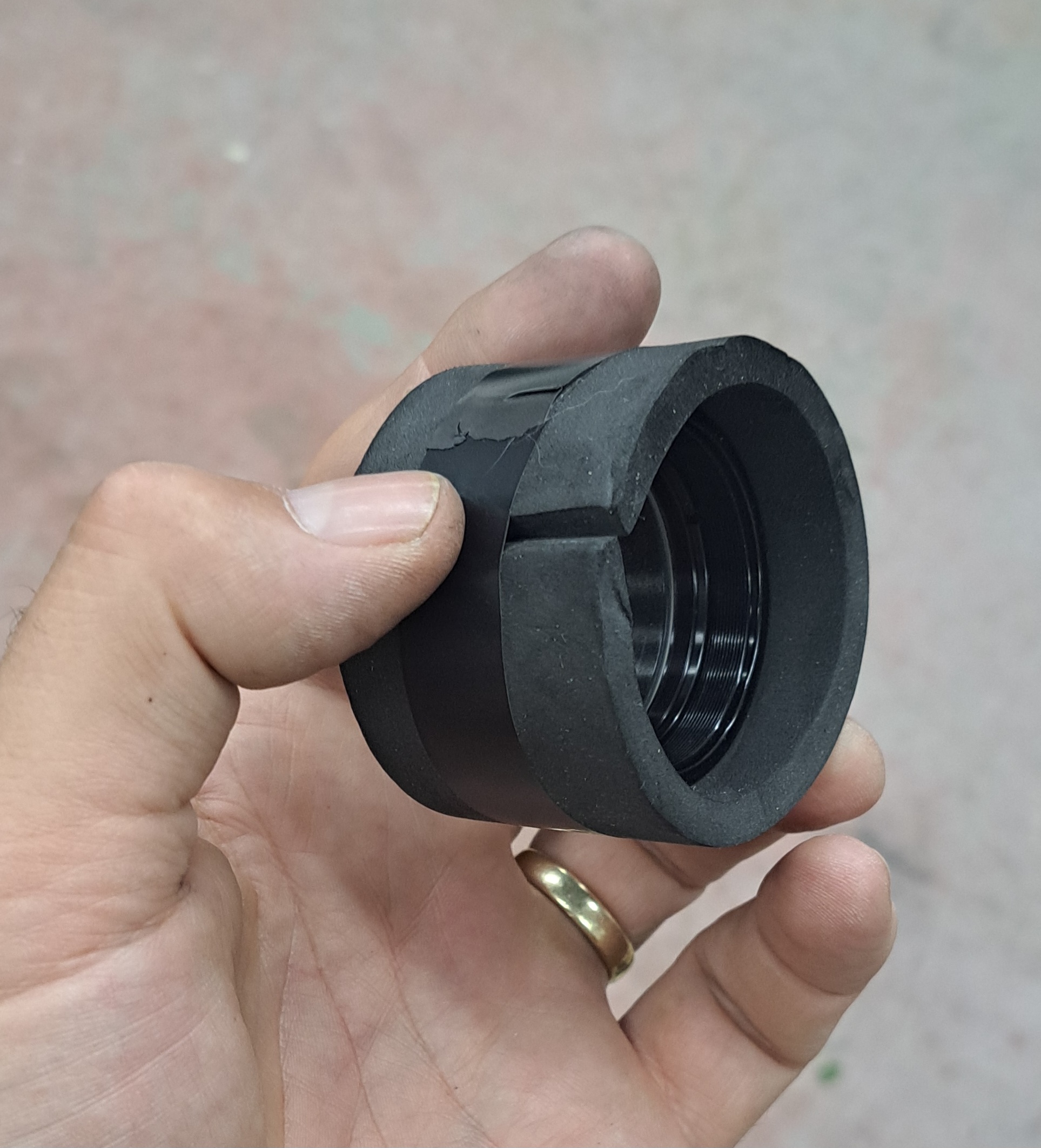

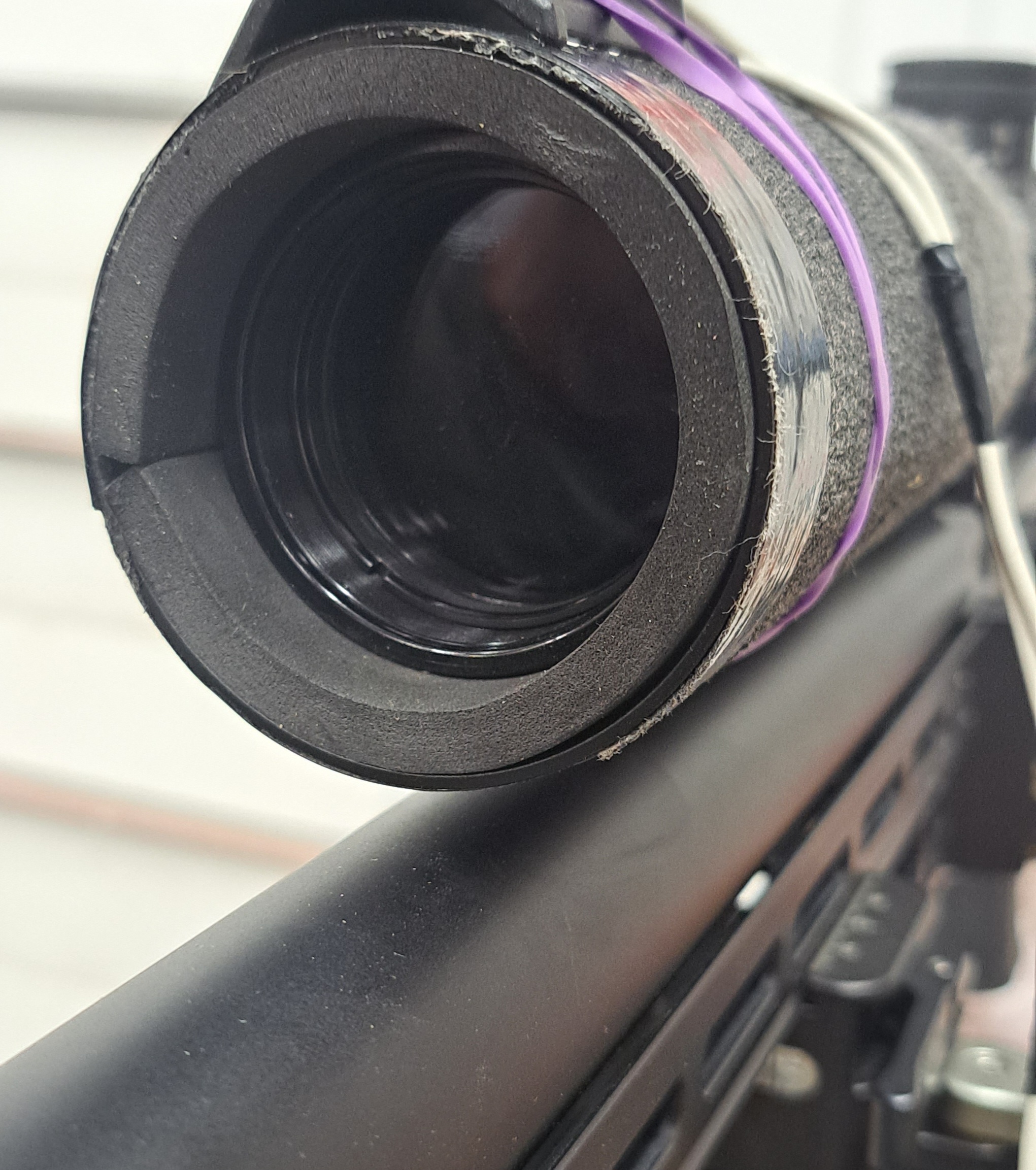

Try a close focus adapter. I have a Leupold 50 ft one and it works with my Athlon Chronus which only focuses down to 25 m without it. It is too small to fit the 56mm objective so I made a foam ring to hold it in place. I can focus down to 7m with it. Some competition centerfire rifle shooters use a .25 diopter lens so they can dry fire practice indoors. Google I.O.T.A (Indoor Optical Training Aid). Some shooters have a lens .25 x lens from a local optical shop.
Thanks I had one years back. Had a scope on Field Target rifle that only focus down to15 yards. The lens worked great, scope not so much. Great idea on the adapter.

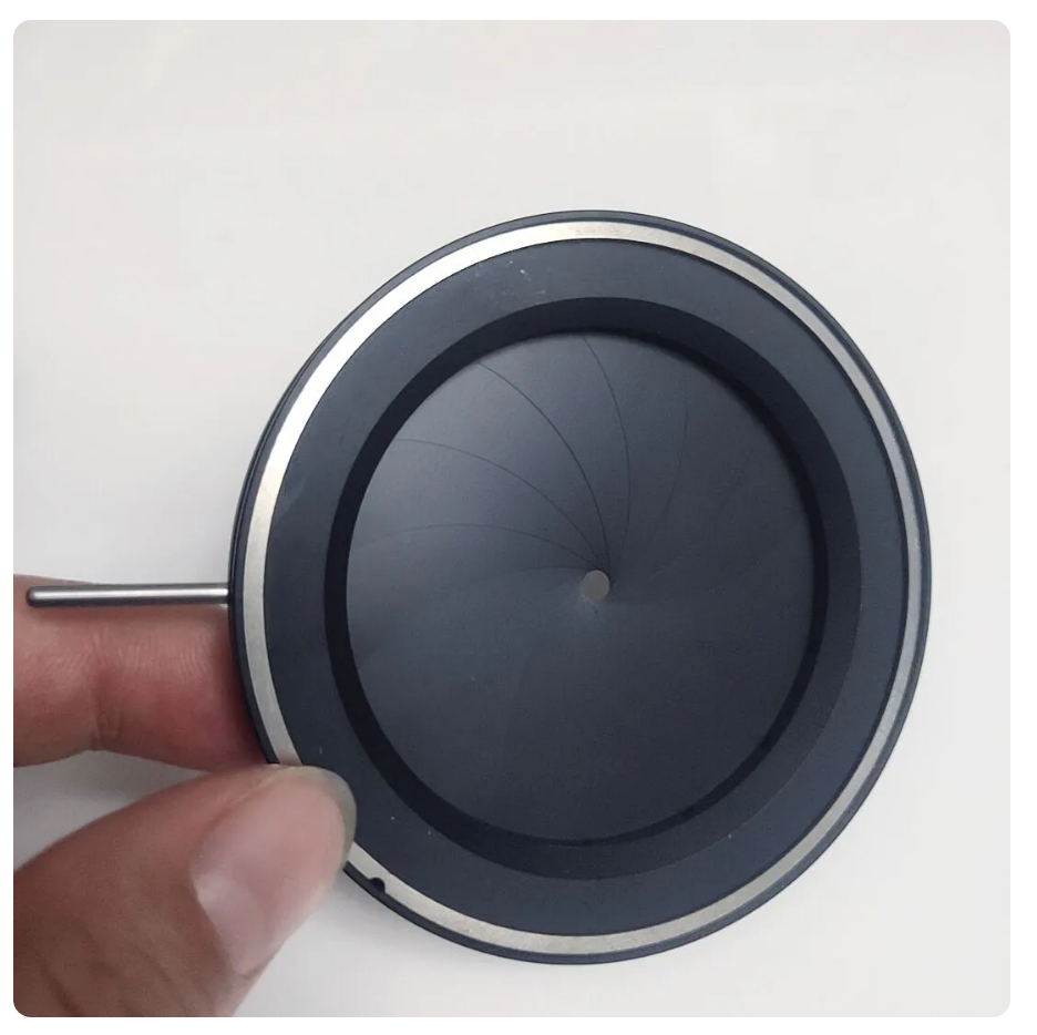

You can also put an iris out in front to increase the depth of field. They also reduce parallax which I found interesting. It will make it more difficult to range using the parallax focus as the image will be in focus for a much wider range of the dial. They say a
March provides their screw on MD (Modifier Disk) with most models that has a fairly large hole in it, but the increased depth of field is significant, particularly on the 56mm models. They say it can help with mirage but I am not familiar with using one, but plan to figure them out.
An iris will reduce the light coming through, so not good in low light but they are cheap enough to make out of a slip on or flip up dust cap, an old or new $8 UV or 1A camera filter that fits your objective and some thin sheet metal for the iris, or you can paint both sides of a clear glass filter flat black and drill a hole in the middle with a diamond bit in a dremel or on your drill press. If you leave the glass in the filter and go with sheet metal, be sure to put the metal behind the glass for the best clarity. You can test it out beforehand using heavy duty aluminum foil or a piece of soda can aluminum taped over the objective with a pin hole in it. Try progressively larger holes until you find a size that is bright enough to see the target but gives you closer focus. You want material to be thin and the hole as clean as possible with no burs, particularly on the back side. If using aluminum foil or pop can metal, paint it flat black to reduce reflections.
If these came with standard camera filter threads on them, I would definitely get one for several of my scopes.
