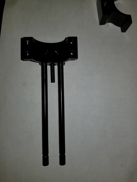

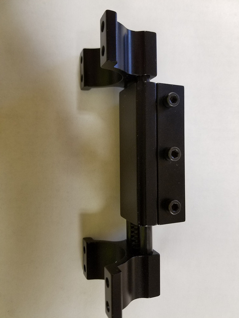

Clone of a Diana Bullseye ZR scope mount.
Please share what you come up with.

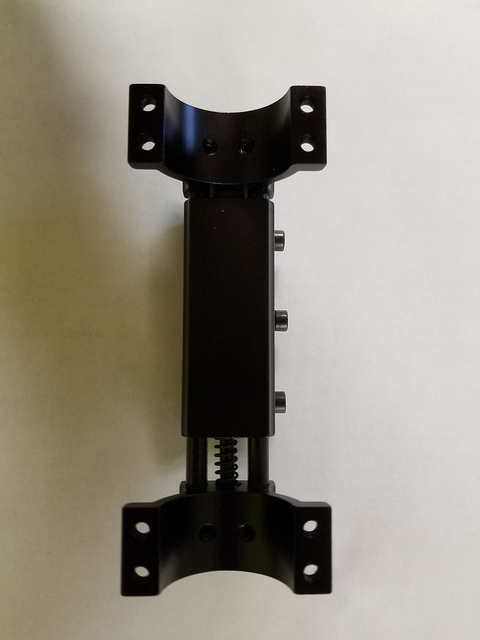

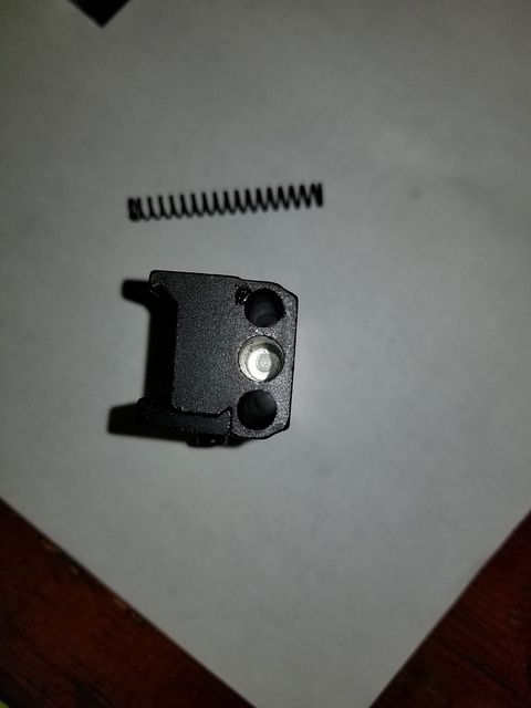

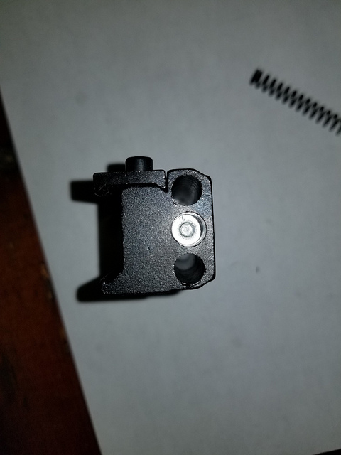

At the moment, I have decided to remove the stop pin. It was an interesting concept in terms of positively locating the mount on return the return-stroke, but I just can't see the aluminum holding up very well cycle after cycle with that hardened steel pin slamming into it all the time.

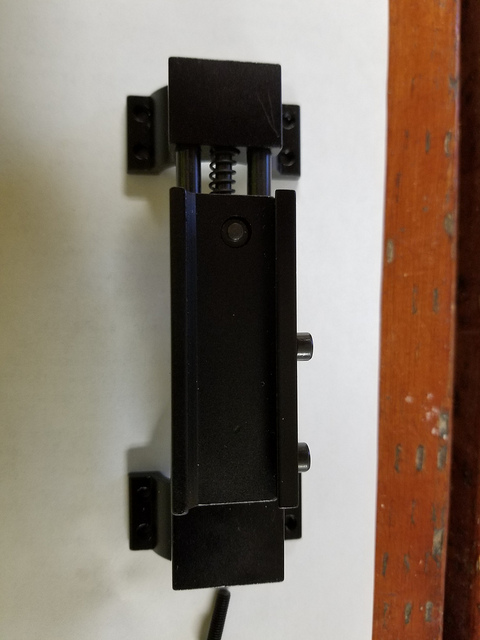

I installed four 2mm x 5mm viton o-rings (one on each end of each rod) very similar concept to the Diana mount. I happened to have some on-hand already so it wasn't exactly an additional expense.
EDIT: After further inspection of the mount, I give the overall finish of it as a B- at best. What appears to be anodizing on the base of the mount actually looks like more of a satin epoxy finish, and it wasn't sprayed on as well as it could of been. However at a glace, it isn't really noticeable.

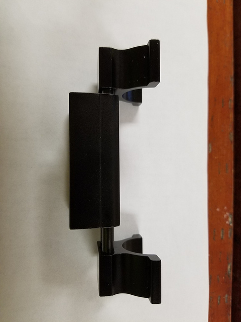

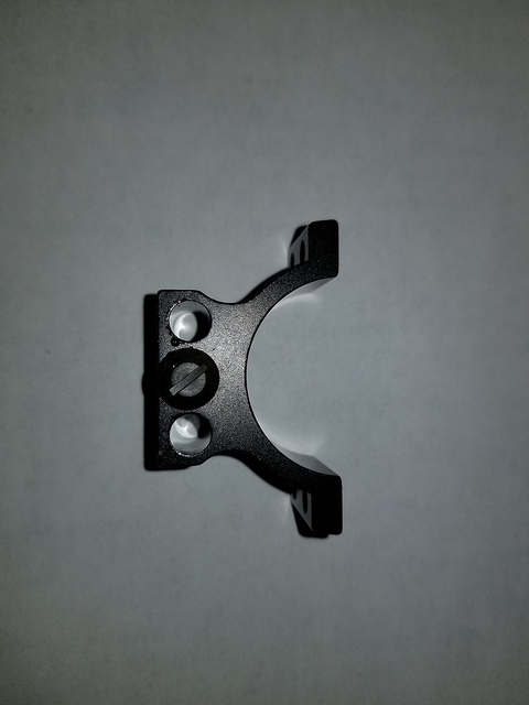

My final thoughts on this: After mounting (I did not even shoot it. Not worth the time.) The tolerances are so far off between the rods and the mount that if you lean your rifle from the left to the right and back again, you can literally hear (and feel) the "wiggle." It gets worse. On a 30-yard target, I was wiggling it and I saw movement of almost 2 feet. The machining is worse than I thought. I apologize for my previous posts on this, I will not entertain this crap. It won't be returned, probably thrown in the garbage.
