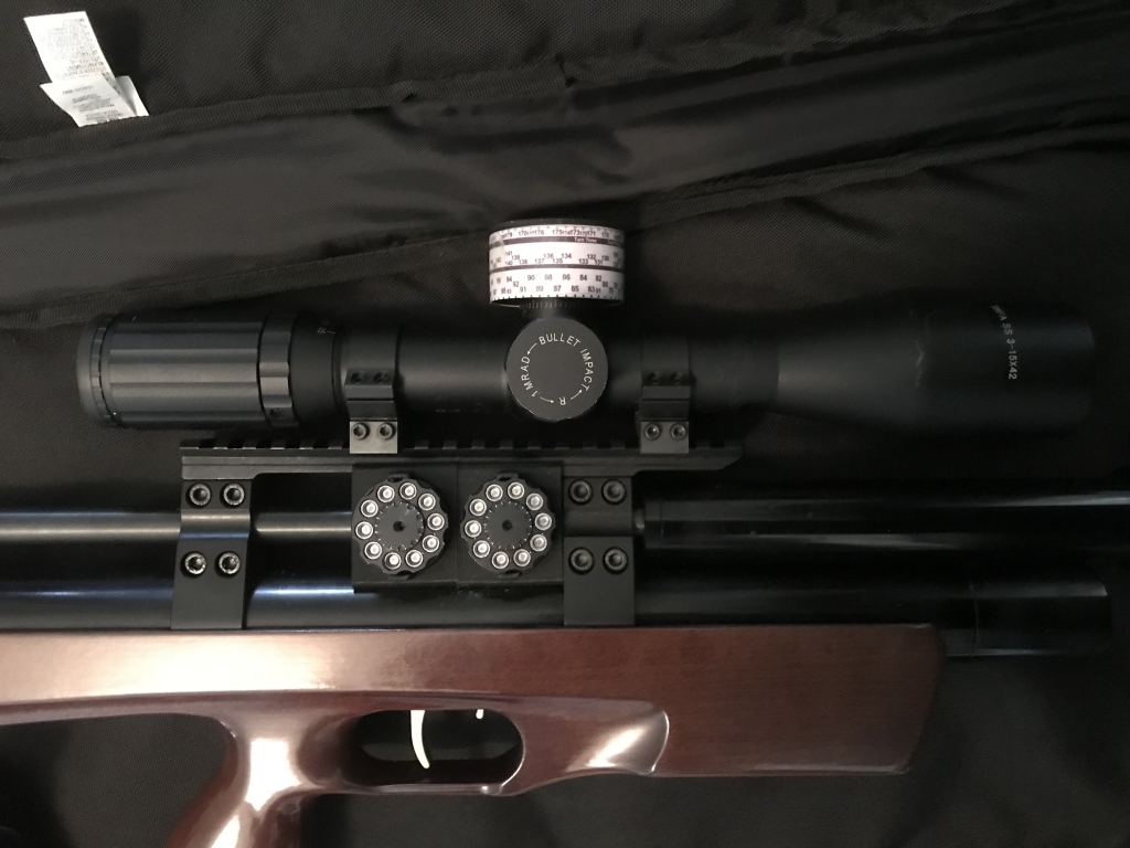

I use Chairgun Pro to make these. It’s stays with the gun and is an immediate reference.

That is an excellent setup. Seems it would be faster to look, aim, and shoot with that setup than clicking could be. Either method will serve people well but I really like that printed label. I've made such by hand but they are pretty crude.
Thanks for the feedback! Chairgun will do this relatively easily, even creating the scope cap to the exact size if you so choose. I took the long way around by using the "Intercept View" applet in the Toolbox menu and then doing a little manual editing to get it exactly the way I wanted it based on its purpose, then sizing it manually for printing. It's a little better visual and has worked very well for me.
As an aside, Chairgun also generates scope tapes based on your data, I just haven't used that feature on my scopes personally, although based on this thread I may indeed try it out.

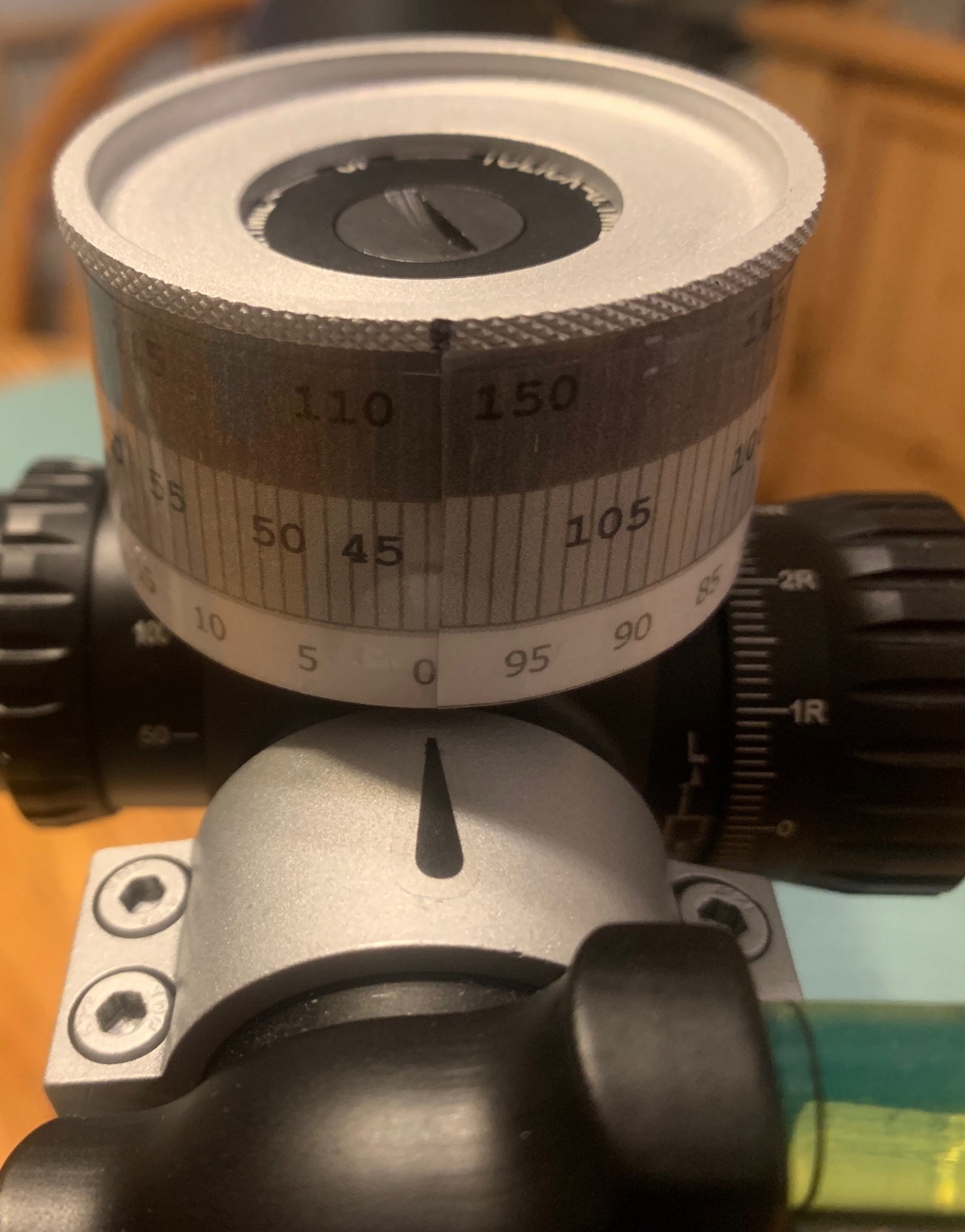

Review this post bu AGN member https://www.airgunnation.com/topic/doc-stanley-his-dial-of-death-accuracy-graphic/ all that you need is contained here. I did the same and went to www.scope-weeks.com and bought the necessary products, he has a cap for your desired scope (SWFA) elevation turret that you can make a tape for. I then used Strelock Pro, the spreadsheet icon on bottom of iPhone screen first row far right; used the data in the “vertical correction column” to input the yardage’s and corresponding elevation turret clicks into the scope-works program that comes free when you buy a turret cap from him. Cost me $55 plus shipping, but was very easy.
I have this set up for my Taipan Vet 22 short on SWFA 3-15 FFP scope.
Beach-gunner
Dennis
Dennis (Beach-gunner)...Thanks for the proper props/credit w/ AGN link & Eric @ scopeworks link. Your elevation tape looks very professionally made...very nice...
