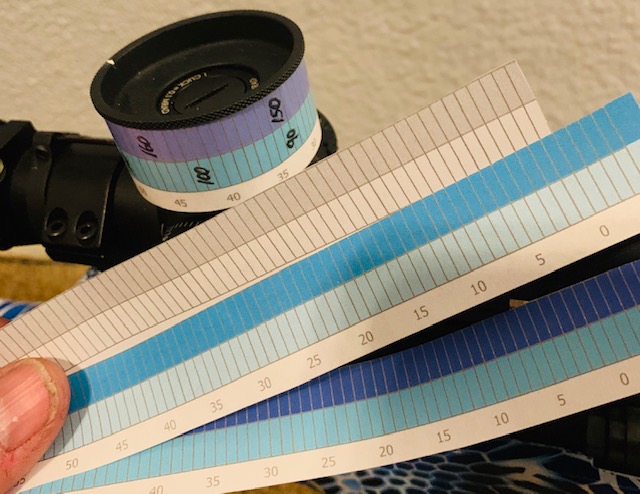

Turret tape is the key to dialing. Takes me about 5 minutes at the start of the day to write down new values on the current tape.

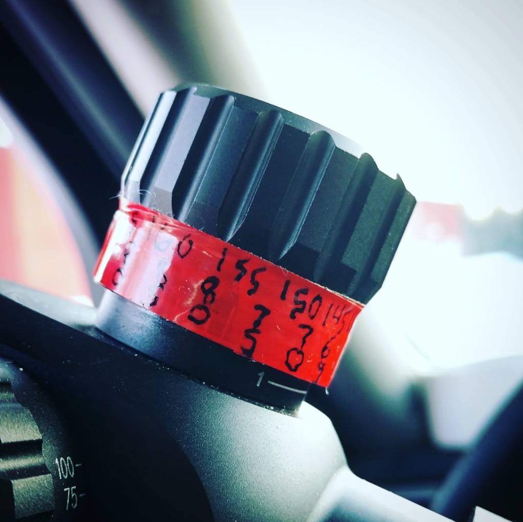

I have some scope stickers on the way to try out. But for now I just use the JSB pellet tin tape. Sticks lightly without leaving residue on the turret, and sticks to itself so no need for any other tape. I use a fine sharpie to write on there. It rubs right off with your finger so you don't need to put new tape every time. You just have to be careful when dialing so you don't inadvertently rub off any of the current markings.

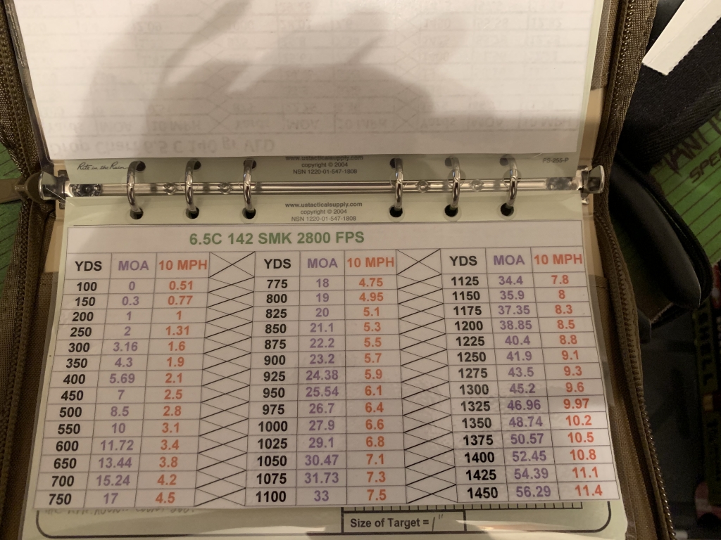

Make a dope card similar to this and print it out and laminate it. If you are switching between distances and clicking it makes it real easy and fast to see how many clicks you need to go from one distance to another. If I am shooting in calm conditions and the shots are fast I will use hold over for the speed. If I am shooting in wind I click adjust for drop and hold off for wind no matter how fast I need to shoot. If you are trying to hold over for drop and hold off for wind it makes it allot harder to know if you are exactly 3 moa hold off for wind while you are holding 15 moa high for drop.

I'm with Bob, I'd rather dial when I shoot, that's why I have a Scope Werks turret. It makes changing to new tapes so much faster and easier. I pre print about 20 tapes and if something in my set up changes, or I switch slugs or pellets, I just write in the new ranges and put the new tape over the old one. Dialing the elevation is the same with any turret, the Scope Werks turret just gives you more room to write stuff down, is less cluttered and changing the tape is easier whenever necessary. In the big scheme of things they're cheap, only like $60-$65. When I don't have time to dial the elevation adjustments is when I use the little reticle card I taped to the rear of my scope. When shooting at longer distances though, where we dial for elevation, there usually isn't a time crunch. Dialing elevation only takes a couple of seconds. Stoti

Thank you guys. I’ve had lots to think about. I think I’m gonna try a mix. Bob and Stoti have given me food for thought. I am gonna tape my turret, but to the numbers they correspond to after the 1st turn. So if I’m out there at 40 clicks and another squirrel shows himself ranged at 25 clicks. Before I’d go down to zero then back up. With like three rows of numbers corresponding to rotations, I can just dial down to the numbers and I’m ready to pull.
