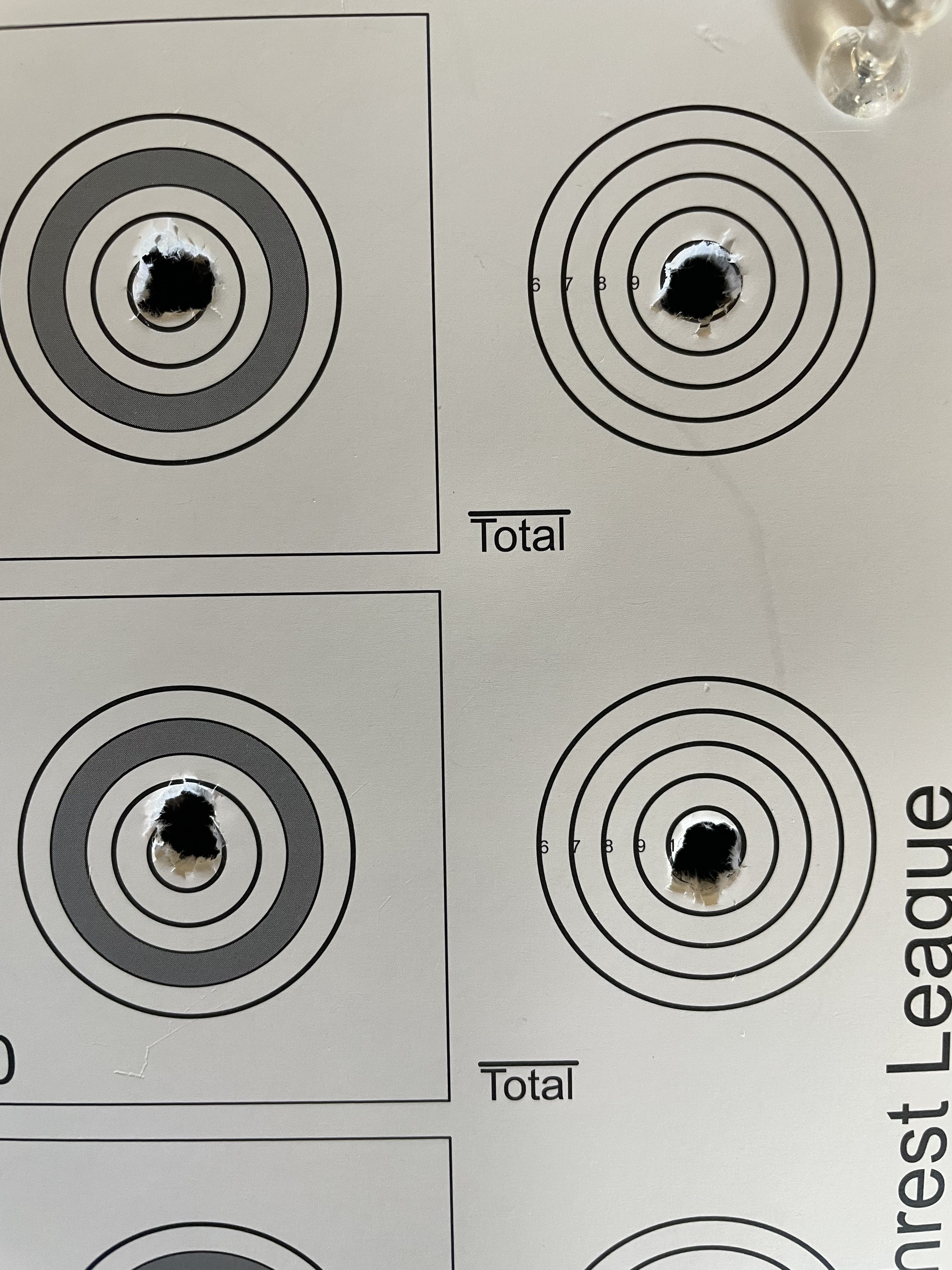

The accuracy benchmark for 12-20 fpe guns built by me is 25 shot groups from the bench at 25y indoors that don’t exceed .315” outside to outside. That will translate to a score of 250 and at least 16x.

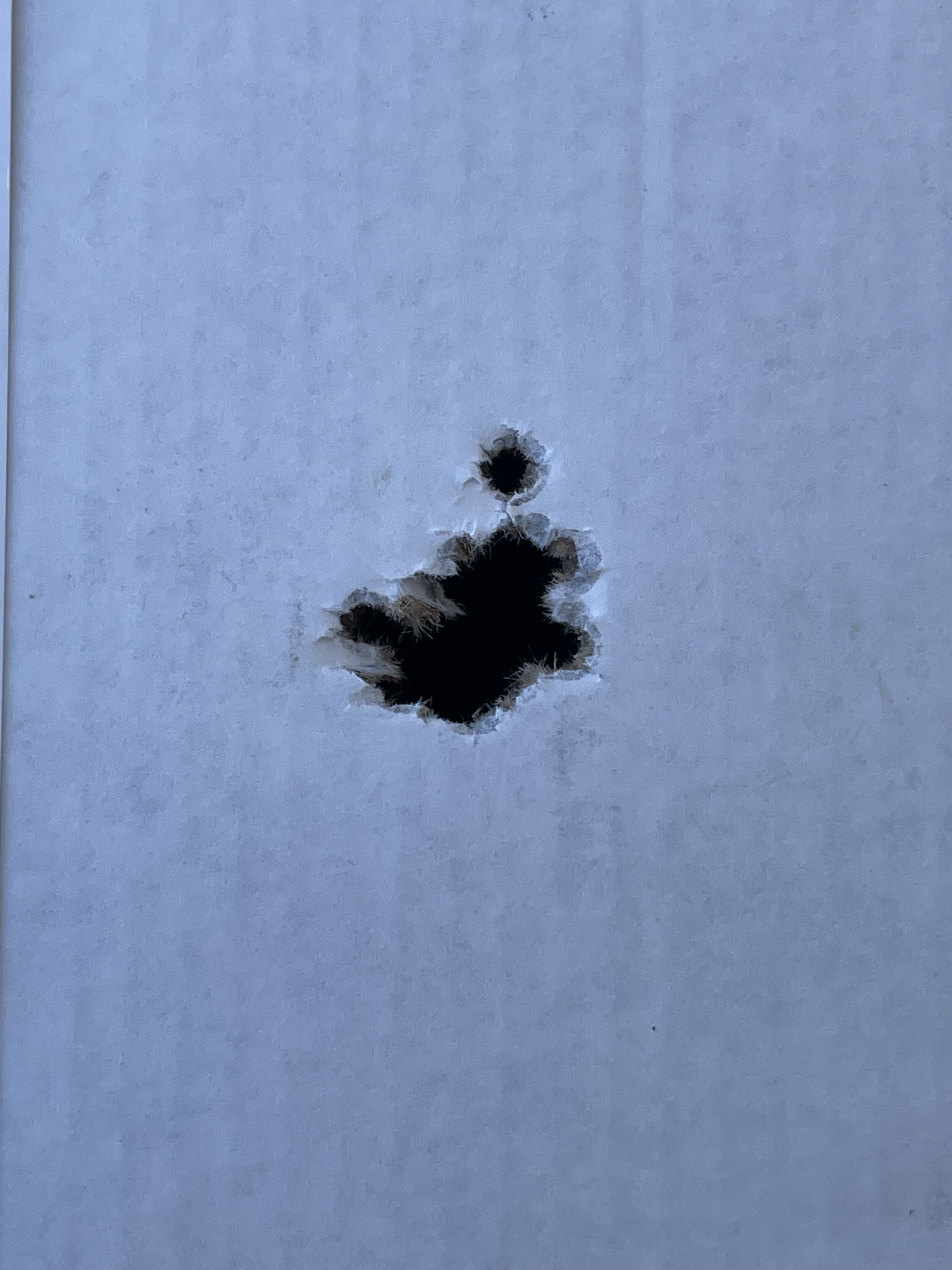

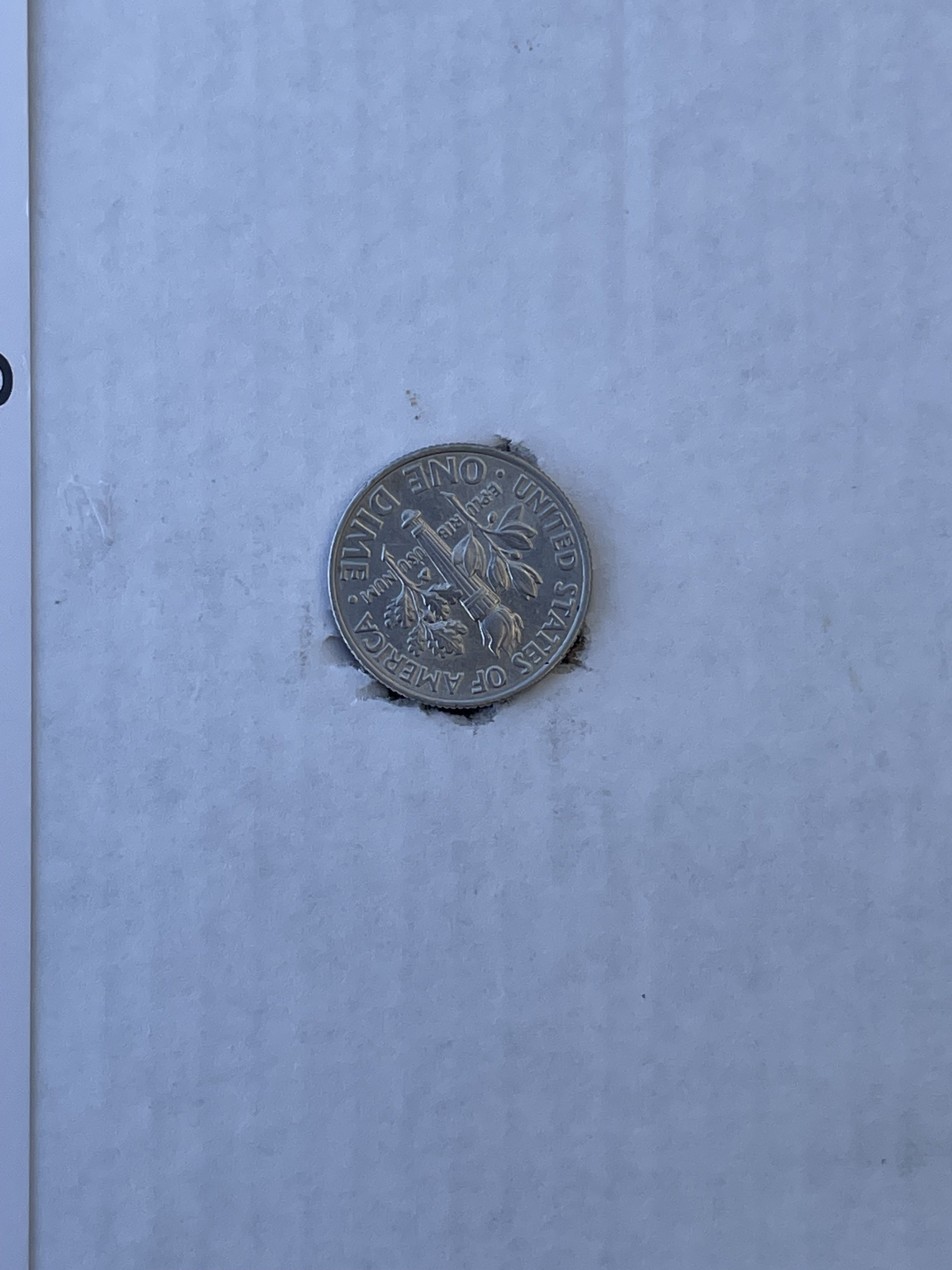

The same guns should be able to print 25 shot groups at 50y outdoors and be covered by a dime.

Here’s 4 25 shot groups at 25y using different pellets and a 25 shot group at 50y from a 12 fpe gun I finished last week.
