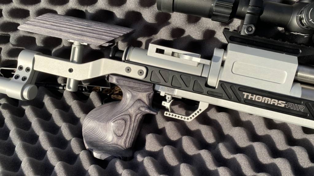

I was toying with the idea of trying HFT so I reconfigured my Crown for it, even got it shoot really quite well and pretty excited about it. Then one day I saw a thread from Mike at Thomas rifles about new dealers/gun smith, one of them being @motorhead who happens to live just 3 exists away from me. Thomas to me has always been the cream of crop when it comes to FT guns and has famously long wait. Then @motorhead started a thread about him starting as a Thomas dealer and he happened to have 1 full kit, my impassiveness kicked so in told Scott to put my name on it. Long story short and 2 weeks later I picked it up last night and I am just ecstatic!

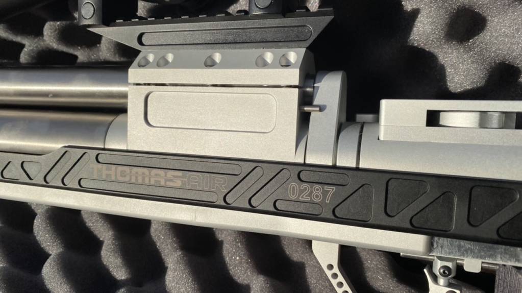

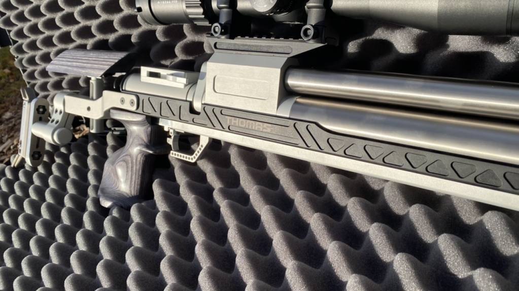

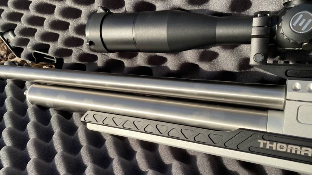

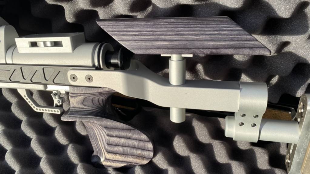

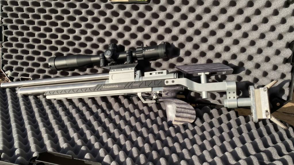

The gun is simply awesome with every single detail superbly engineered and more adjustment than I can list on 2 hands! I'll let the picture do the talking since I don't even have it setup to me and don't even have the correct rings on.
View attachment 199276View attachment 199284

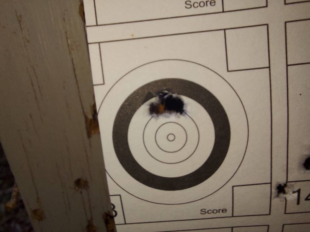

Scott aka @motorhead shot this group at 25 yards off of shooting sticks HFT style before I picked up the gun. Obviously it’s accurate so I can look really good holding the gun at the match, I can always blame unsorted pellets! 🤣🤣🤣

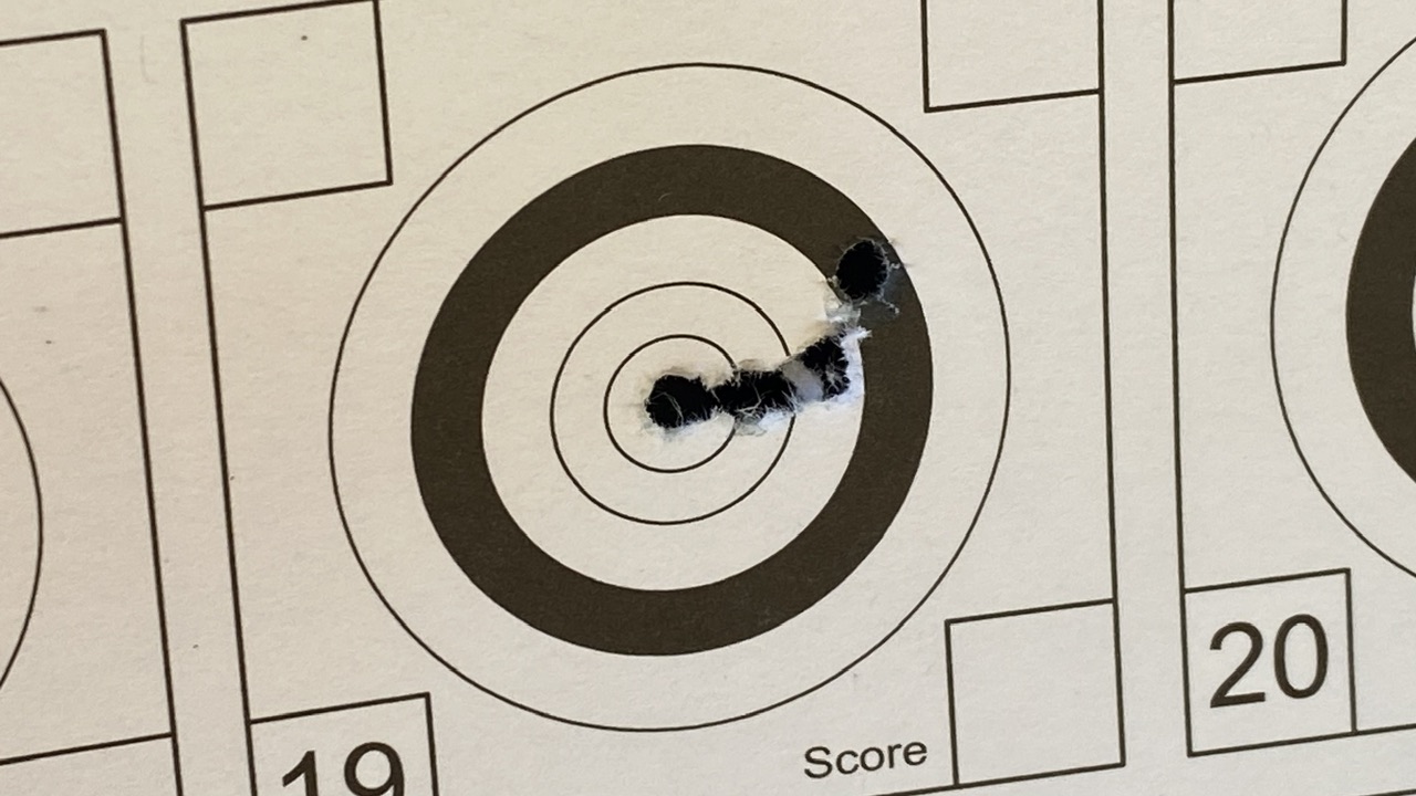

After 1 year/season of shooting my Thomas in FT matches I decided Pepe needs some upgrades, we always need upgrades right? After trying @Motorhead's Thomas (started as twin to mine) with his magic touches which even at 20fpe is simply unbelievably settled and quiet. I knew I had to have him put some of his magic pixie dust on mine. Due to his busy schedule I finally was able to pick up my Pepe this afternoon and couldn't be happier.
First and foremost, just dry firing it's quieter and has a snappier sound to it. With a pellet the gun is just so settled, it hardly moves compared to before. I can visually track my pellet in flight with ease!!! Thanks to that I will change my grip and how I hold the gun, I don't have to manage recoil nearly as much. Also because it's so settle it's less hold/followthrough sensitive so it feels like it's easier to shoot accurately. Simply sugar cream puff!!!
Grabbed a new tin of pellet and sat down on the bum bag to try it after the surgery, I'm pretty blown away by just how much easier to shoot. The top right hole in the black ring was me trying to find my POI, the gun isn't zeroed at this point. Then I manage to put 4 pellets in a single line touching with some side wind at 32 yards! To say I'm happy is definitely an understatement, it feels like a different gun!!! Will zero and do some more testing this weekend but I'm really tickled silly with it so far.

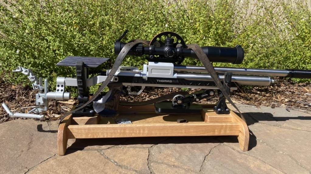

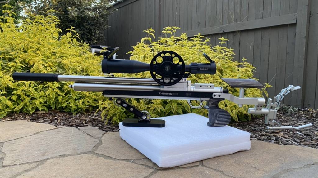

Pepe got all dressed up for tomorrow’s FT club match. The Rowan hamster made it from UK just in time and the shelf is 3D printed trying out the shape, I might for for the rubber toilet plunger later
the moderator is 3D printed and just slips onto the shroud, works well enough for me to do some stealth FT practice in the back yard.
Update #2: FT carry tray is done:

You are a magician Scott!!! Found a few minutes after dinner to try and zero the gun on my “bench”. No wind, at my zero of 23 yards put 3 through the same exact hole, half a pellet over then more through the same hole. It is just so easy to shoot now. Holly crap!!!
