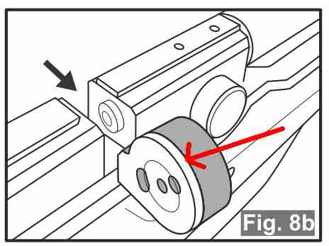

This picture shows the rotary cartridge (from the User Manual) being inserted behind the barrel. The dark-colored section of the magazine holds the pellets, while the light-colored section (transparent, actually) rotates so as to allow manual insertion of the pellets. So these two sections rest on each other with the light-colored section rotating over the dark-colored section.
In any event, it was at this juncture of the two sections, as depicted by the red arrow, that I first took a coping saw, and then a hacksaw, to cut through the axis of these two sections. Once I cut through that point, the light-colored section was able to be pulled out and away, at which point a single pellet fell out. I was then able to gain some wiggle room and subsequently remove the bulk of the magazine, with pellets. I then blew compressed air in and around the area behind the barrel, so as to ensure as best I could that there was no foreign matter.
To me, this seemed the least-invasive tactic. That is to say, it was least likely to damage the gun, sacrificing only the rotary magazine, which is replaceable at minimal cost.
