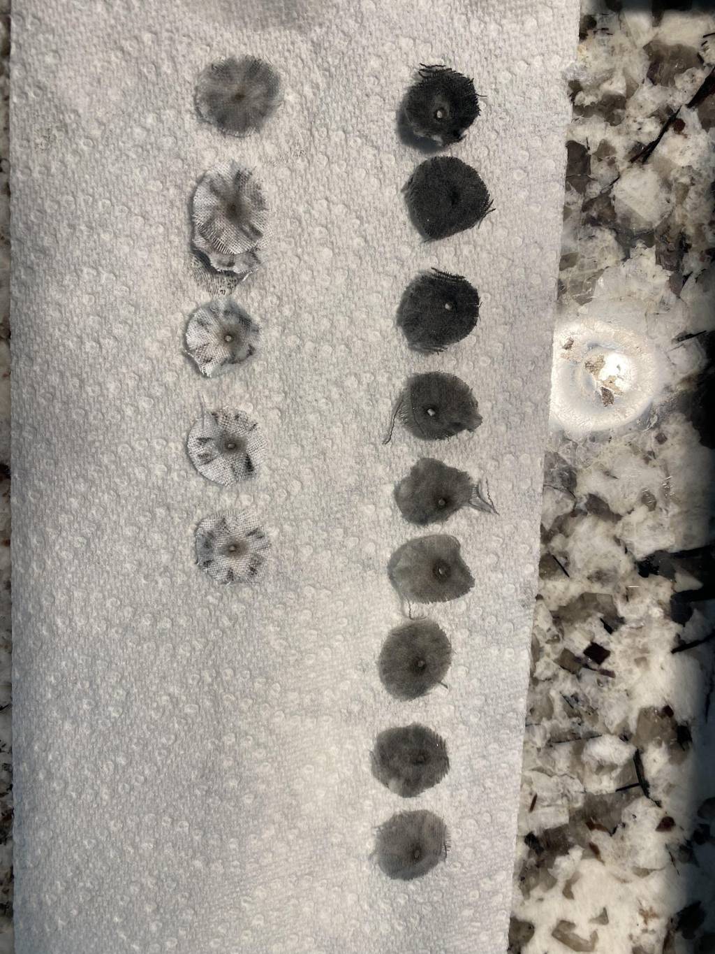

I had some accuracy issues with a gun I just got (used) with a 500mm superior barrel. For poops and giggles, I cleaned the barrel. It was FILTHY!!
afterwards, groups tightened up substantially. I don’t believe a word he says about these barrels. Some need cleaning, some dont. Also, slugs tend to gum the barrel up faster than pellets I’ve found.

I 100% agree. Slugs get it dirty quick and accuracy improves with even a couple runs with a patch. I do mine every 100 rounds, 4 passes with a patch, takes 2-3 minutes. Every 500 I scrub.
